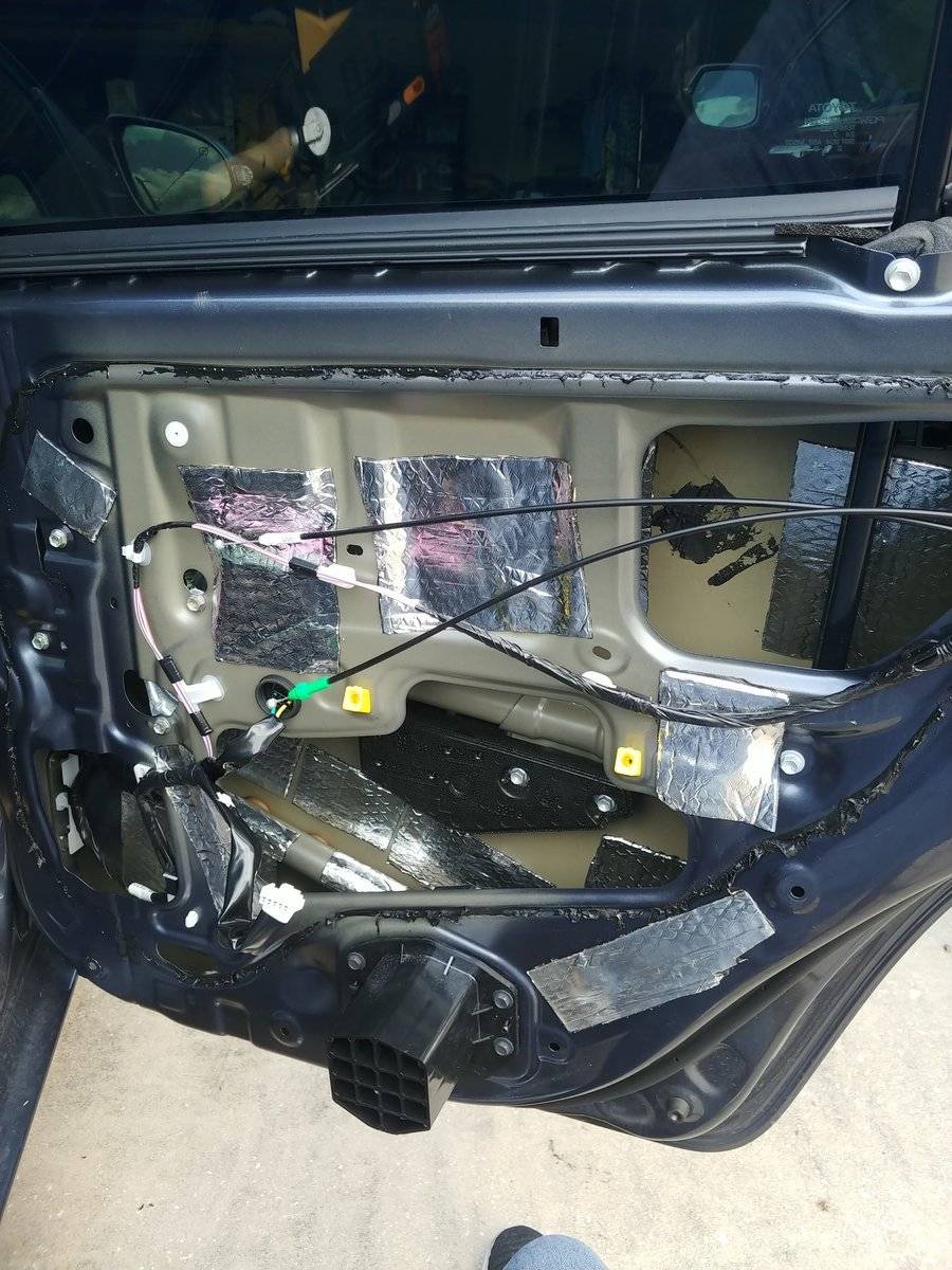

Back doors and back of seats done today.

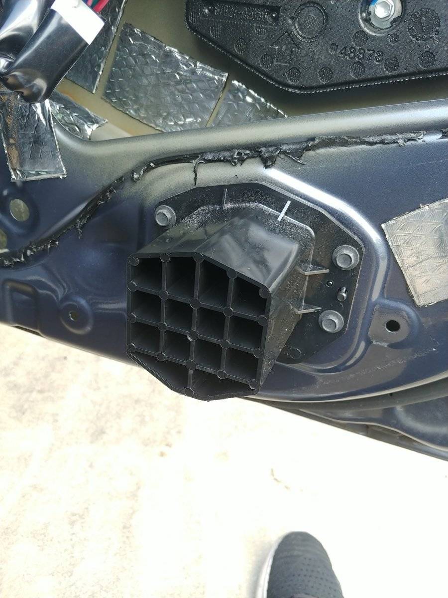

Anyone know what the black piece is for in the second pic? My guess is just stabilization of the plastic.
I've seen those being used as resonators to cancel road noise.  I've also seen them as protection from the door card being pushed in.  I've left them and i've removed them, depending on the car.
