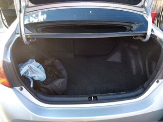

I knew you were gonna say 2 15's.. lol. The only way for 15's to work is if you went infinite baffle in which case you'll be louder with 2 12's ported in ideal conditions. Either way would be kick azz, but based on your goals you're gonna have to dive a little deeper into the water with an emphasis on box design. Yea you look to be within budget with the selection you have. You're on the right path. I have a feeling that you might have to build the box from inside the trunk cuz it's gonna take up alot of space. The problem is the trunk opening is kinda small on these type of cars. You got everything else figured out, just focus on enclosure.. That will be the key to your success.

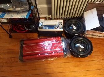

What about 4 10s? 3 12s even? Something that doesn't require a lot of space like sundown subs. I think 2 12s will work to get 150 if I give em enough power. With enough batteries I can really get some beefy subs. I'm thinking of doing an adjustable port as well. Maybe tune it to like 35hz or 37hz. Then have a port extender if you wanna go to like 30hz for more low music.

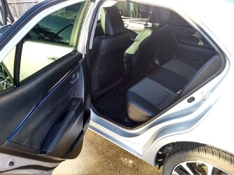

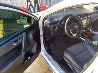

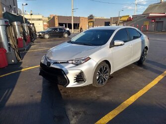

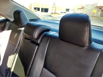

Pics of the car. Pretty basic. Gonna start with the front stage and nothing in the rear deck. I might make some custom rear door pods at a later date.
