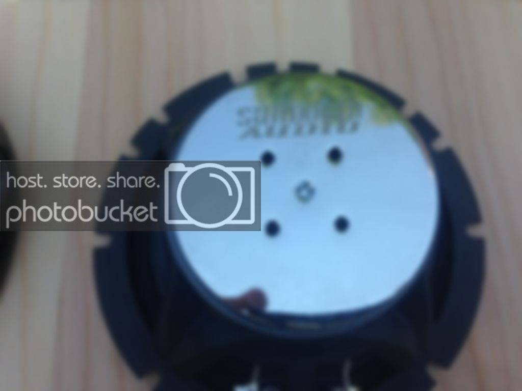

Fronts: Sundown SA-6.5CS

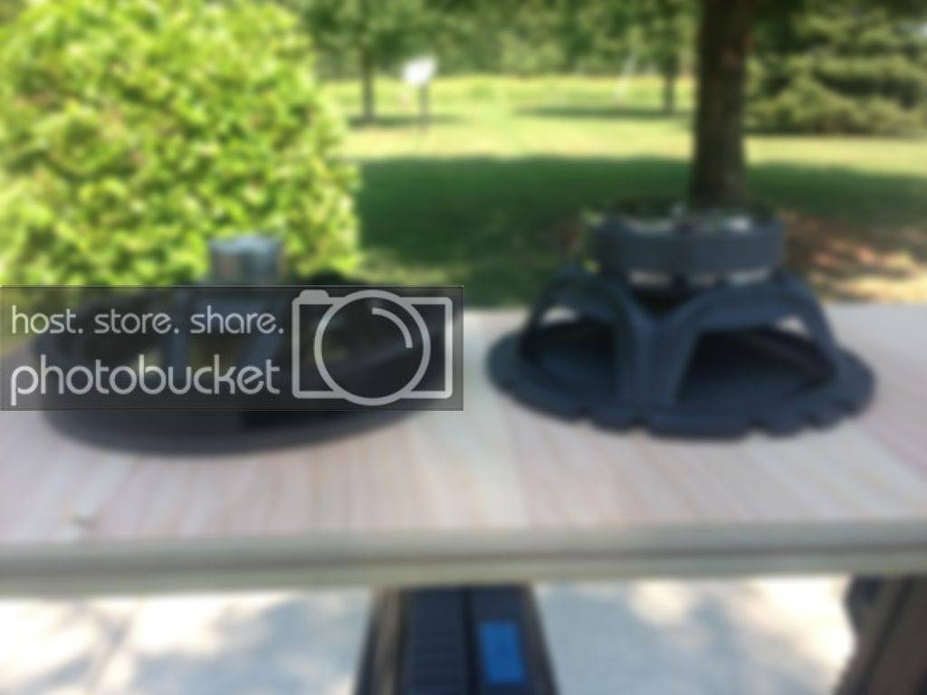

Subs: 2x PG RSD10's
Amp: Alpine PDX-V9

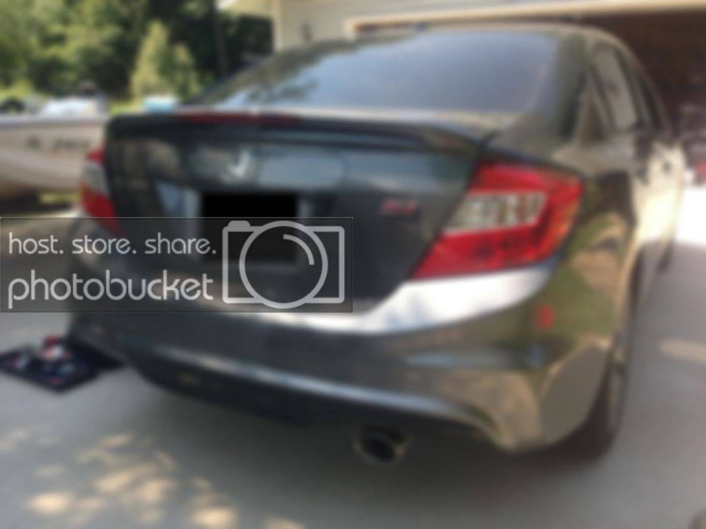

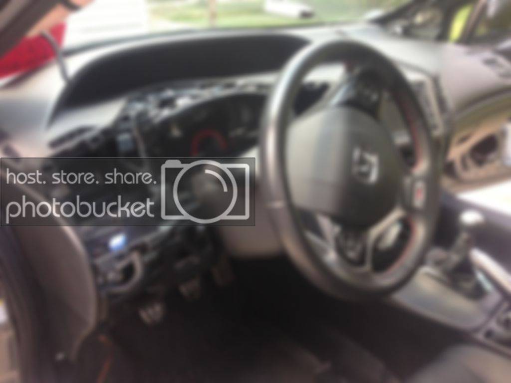

The car
Don't know what that red is on the right, but it must have been a reflection bc its not there on my car

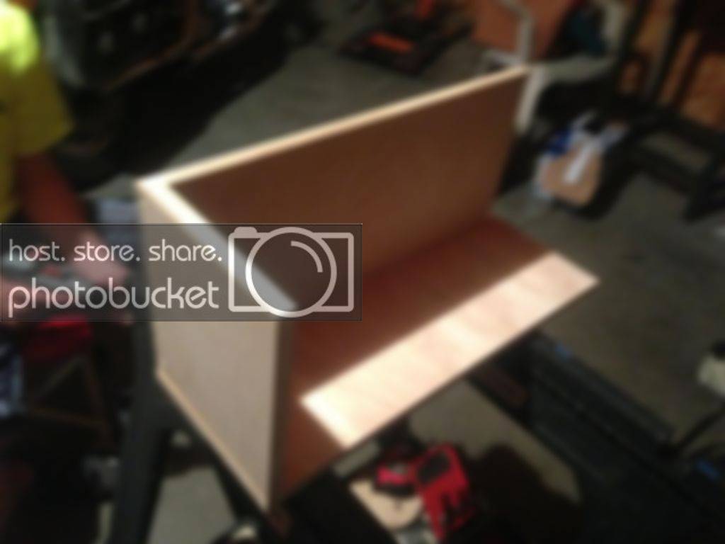

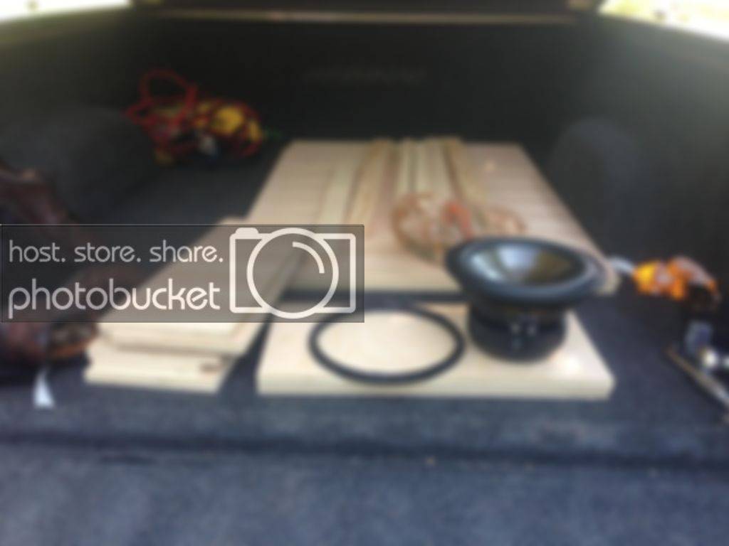

Wood all cut (7-ply birch)

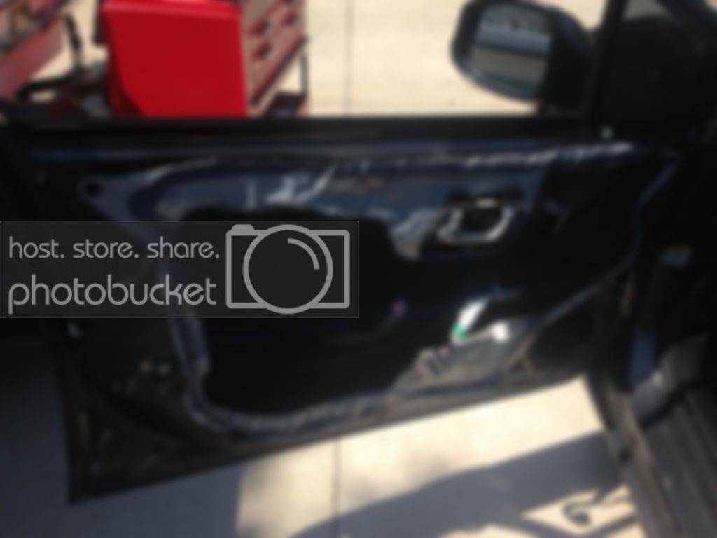

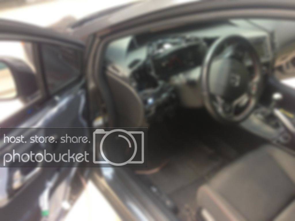

Doors all apart

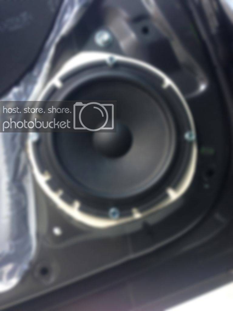

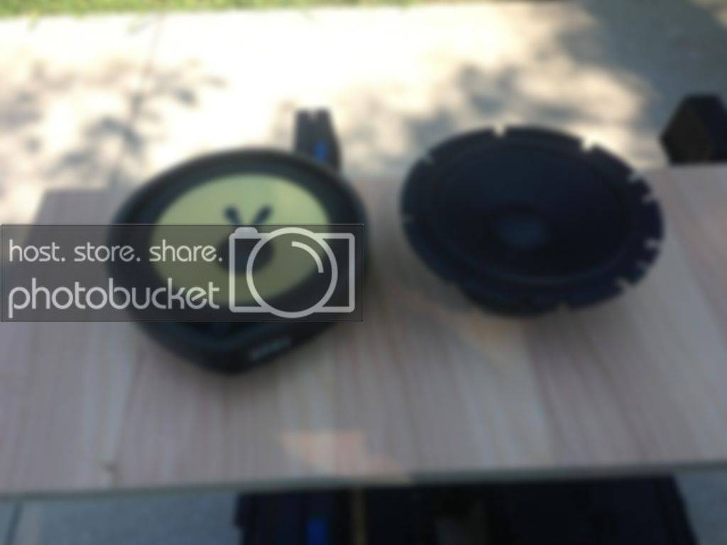

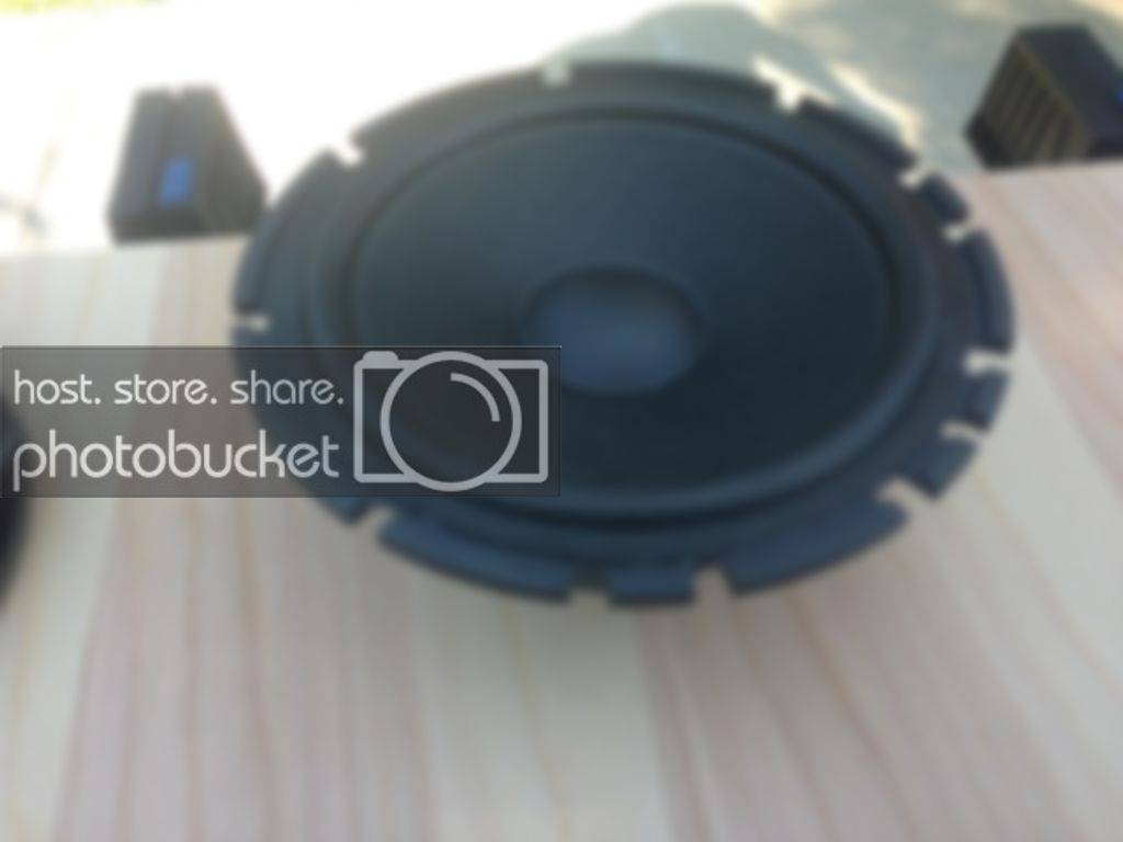

Stock Speaker vs. Aftermarket

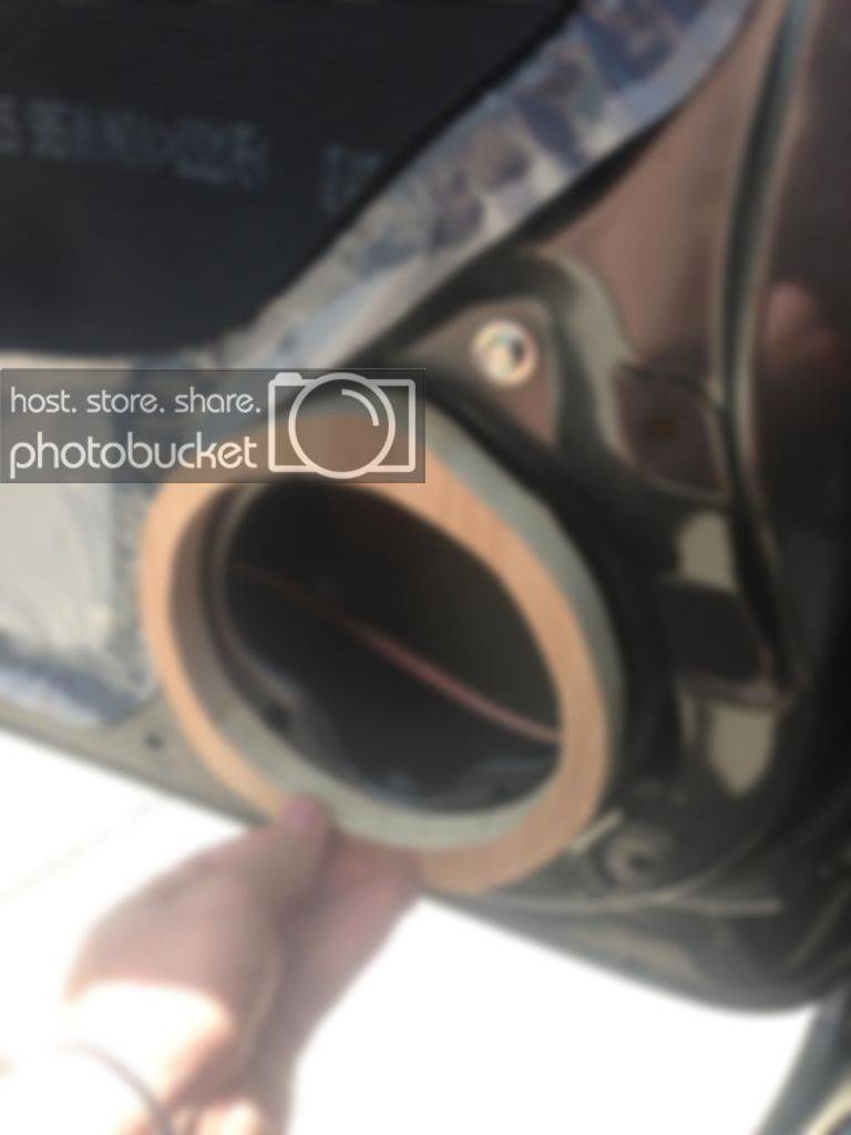

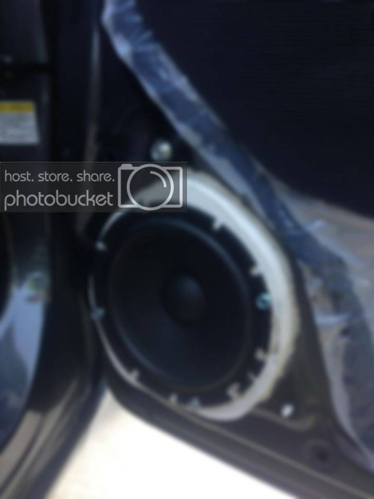

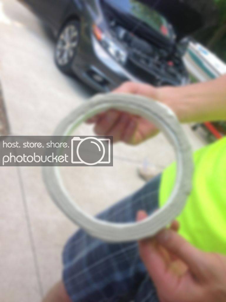

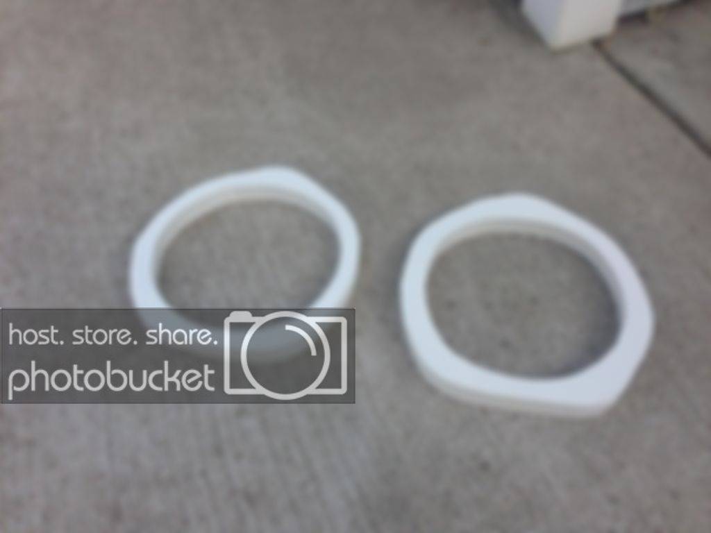

Fitting Speaker Adapter to door

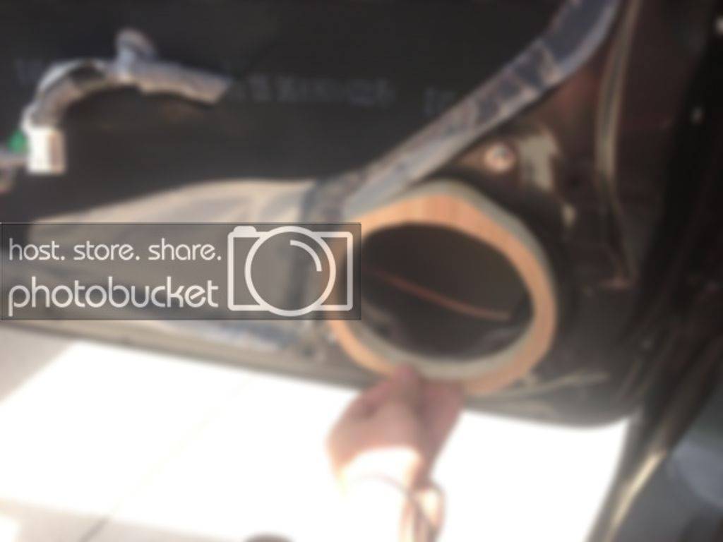

Both adapters built and sealed with bin sealer primer
Window Sealer added around adapter to seal to door frame. Sealer was also added around speaker when attached to the door

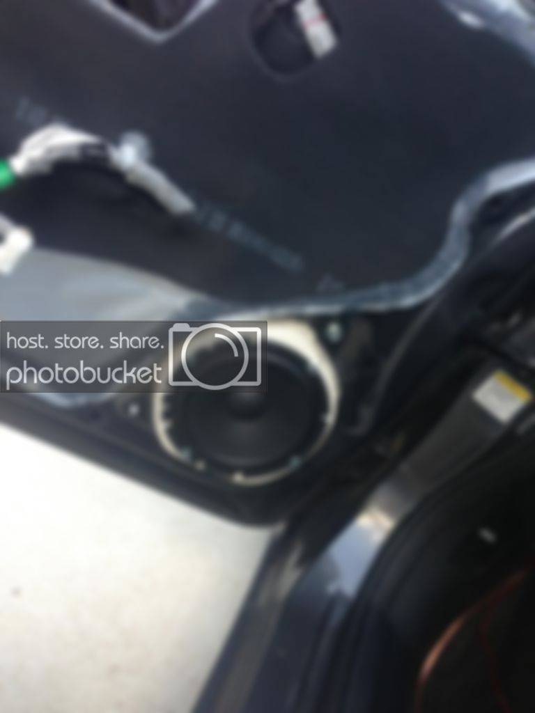

Left and right speaker installed

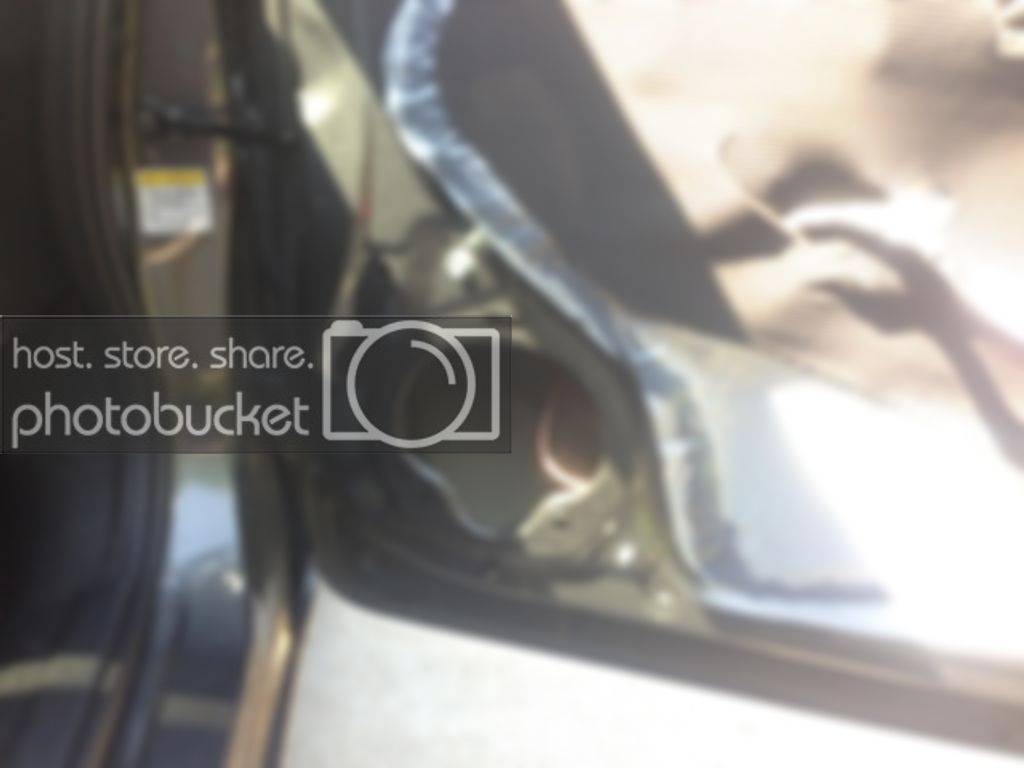

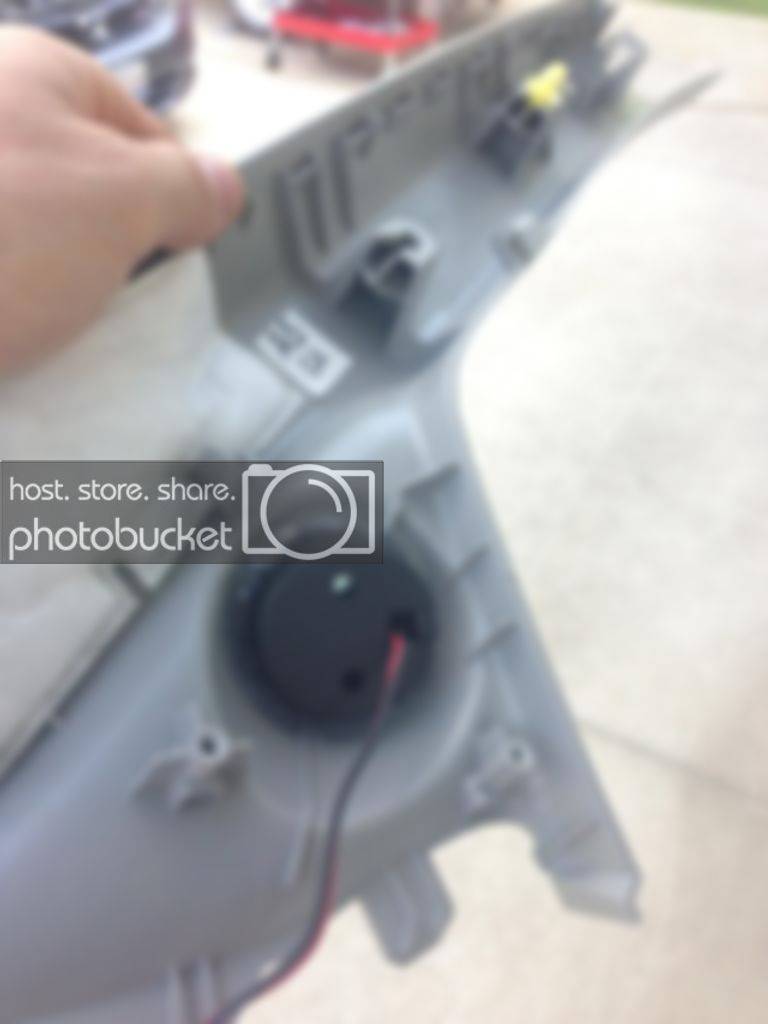

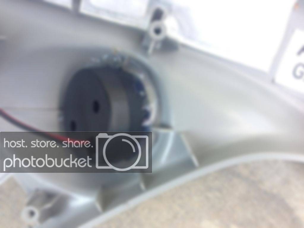

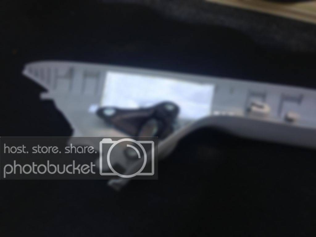

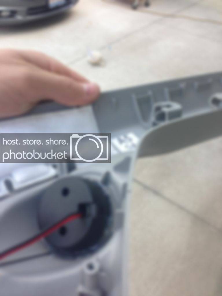

Stock tweeter in the A-Pillar taken off

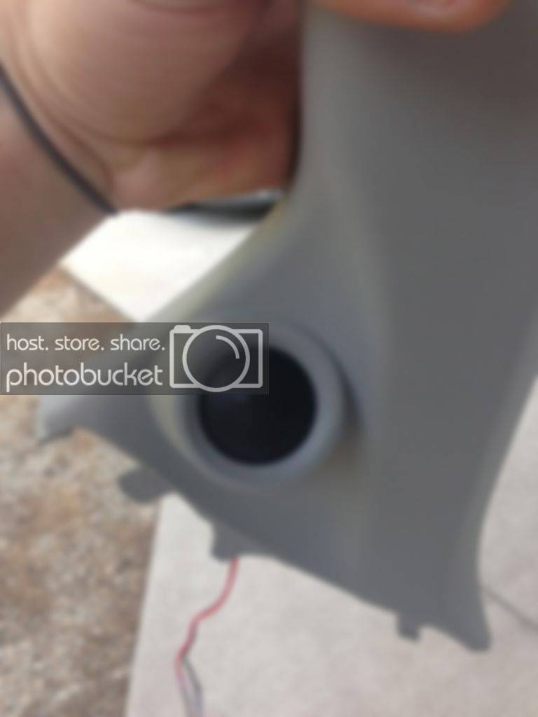

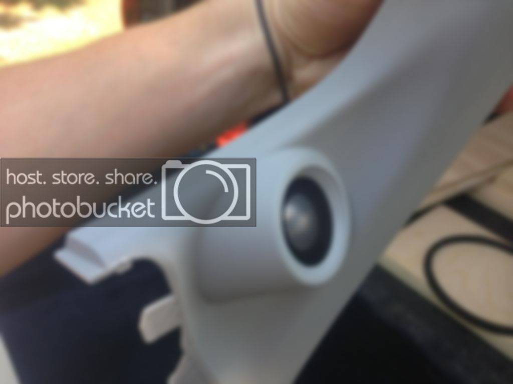

Aftermarket tweeter. Hot glued the front of the tweeter casing, really the only option i saw fit, and the glue can be peeled off if need be later

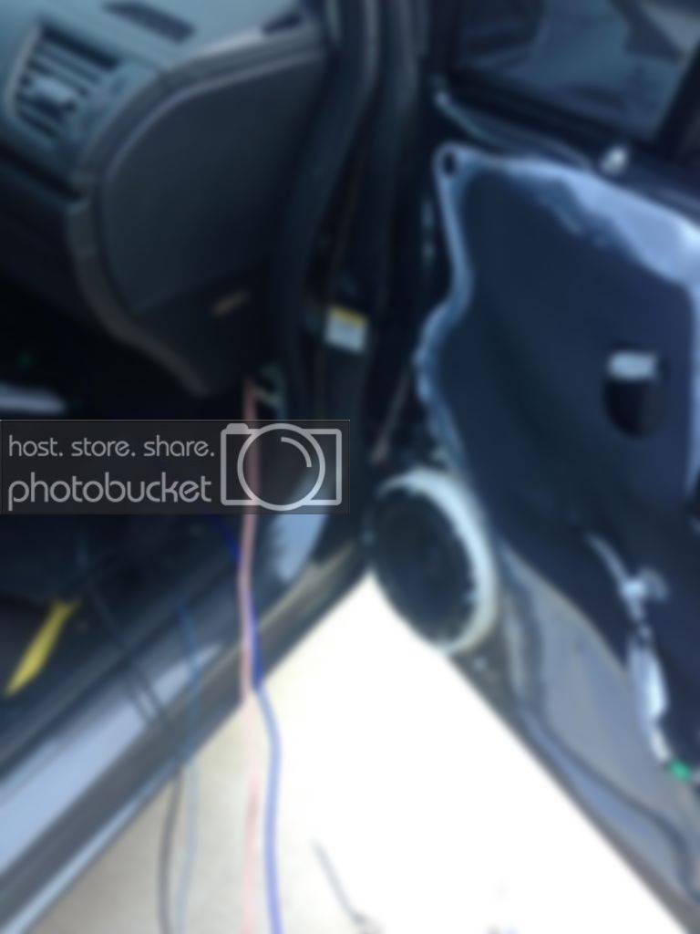

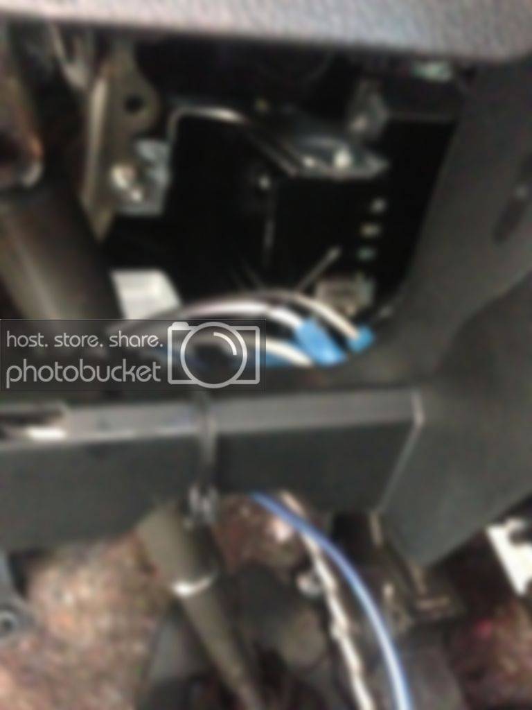

Headunit has differential signal output, so i had to tap into the stock harness

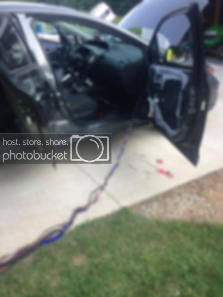

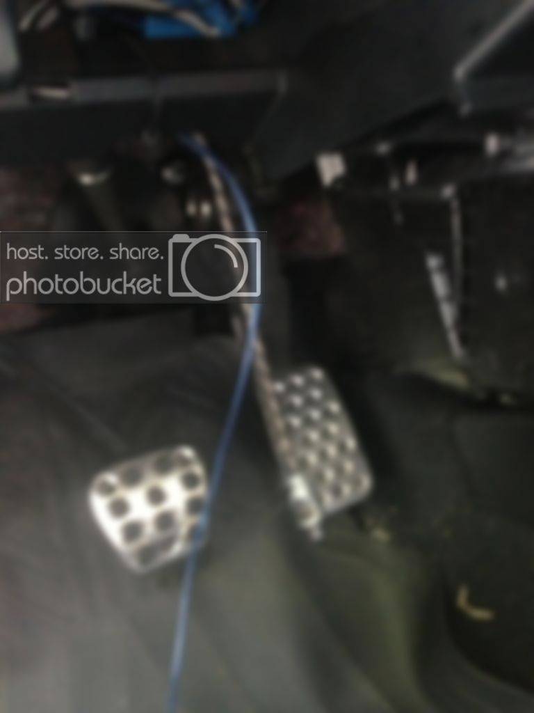

Speaker wires, rcas, 12v switched ran down opposite side of car

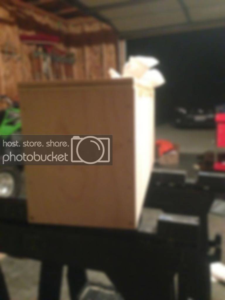

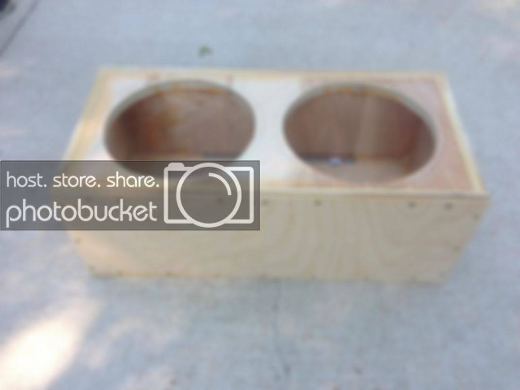

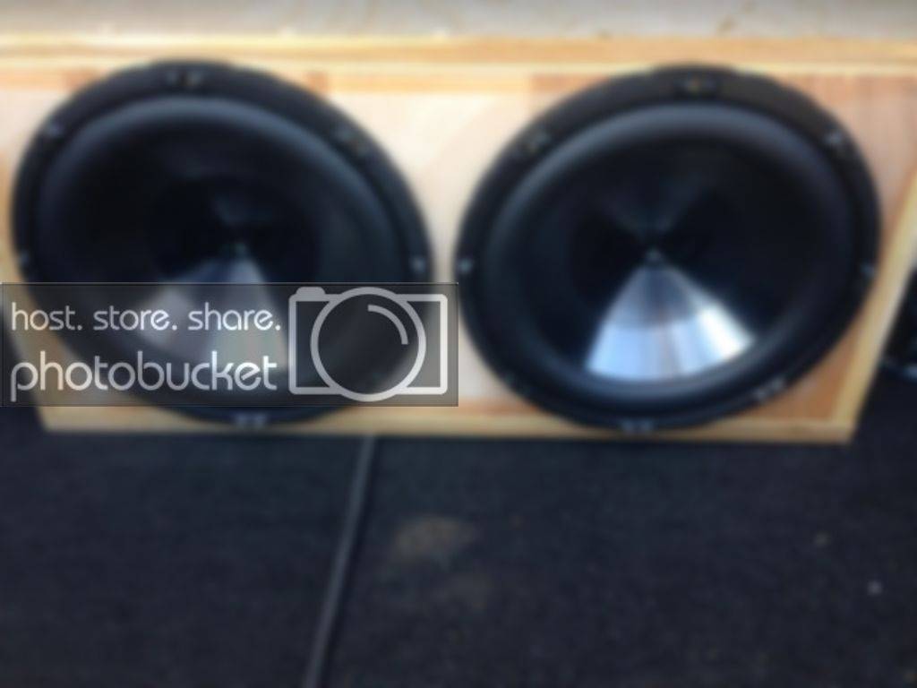

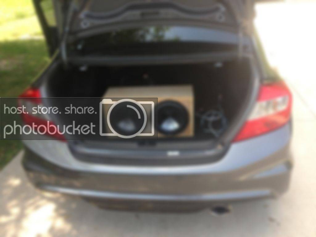

Box build (0.7 cubes sealed)
All hooked up
This looks really clean. Can you explain how you mounted and wired your tweeters? I have a '13 civic and will be replacing the fronts with Morel Maximo's. My only problem is since they have passive crossovers, I'll have to mount them in the door somewhere but I don't know how to get the tweeter wires down through the a-pillar, through the boot, and into the door. Did you have problems? Any advice? Thanks!
