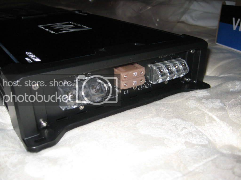

Fused 70a x2

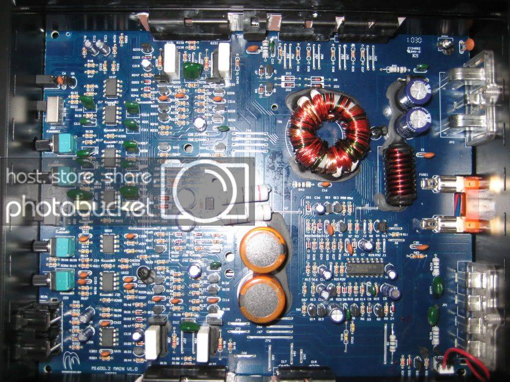

I did take the bottom off since the warranty stickers were already broken out of the box new they are very brittle and not put on very well, (saw this with the MB Quart series too.)
BTW these Autotek Amplifiers are Rebaged MB Quart Onyx series hince the new possible form boner. The M4000.1 is EXACTLY the same board same internals as the MB Quart Onx1.1500D at a fracton of the cost.

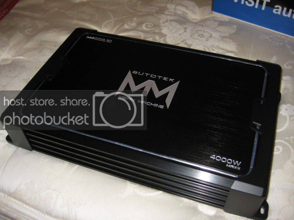

Here is the 2 channel in all its glory.
Here is the Monoblock.
