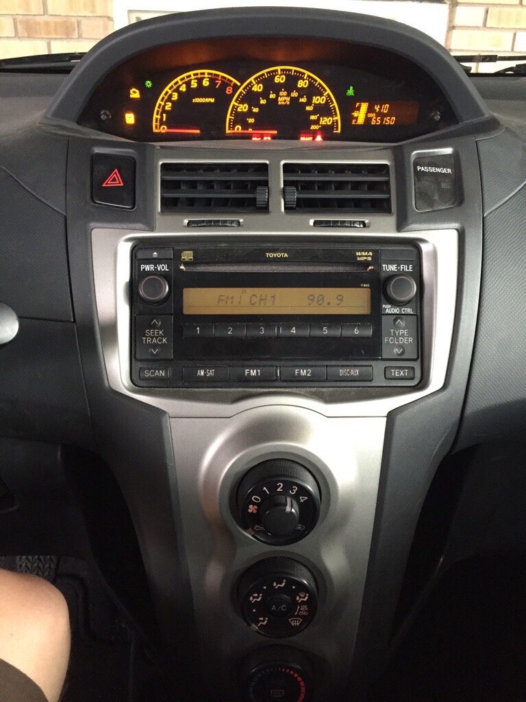

Here is a pic of my oem head unit
I know I'll need an adapter to fit a single or double din head unit since the factory one is 200mm as opposed to 180mm for aftermarket ones
Swapping out the head unit would be the first thing to do. If you buy from crutchfield or sonic electronix, they include the dash mounting kit along with wiring harness for free. Unless you really plan on going all out, swapping speakers to aftermarkets will make things sound a whole lot worse unless you buy quality speakers, amp them, and sound treat your doors to perfection. As for a head unit. Look for anything with a 24 bit dac, 7 band or higher EQ, time alignment and the features you want. Thats the bare minimal for good sounding head units.
