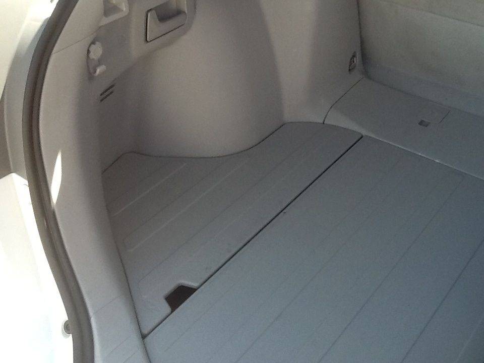

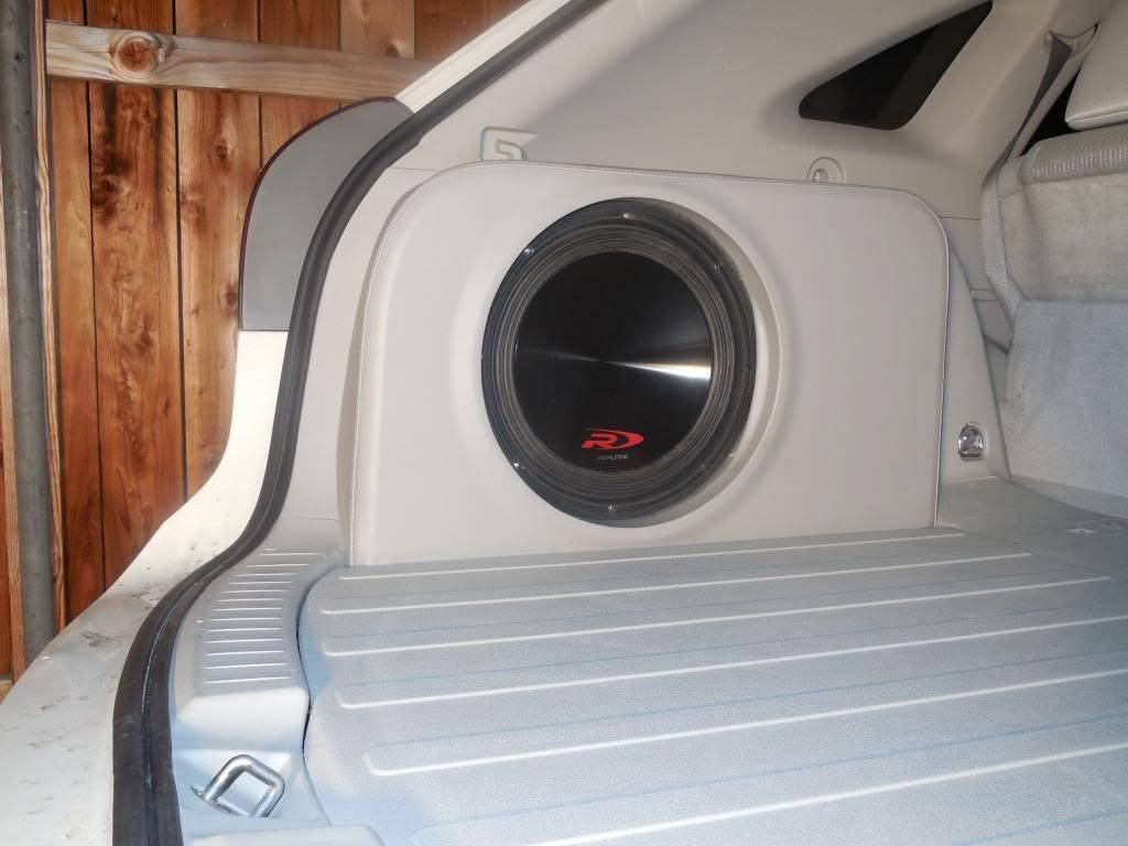

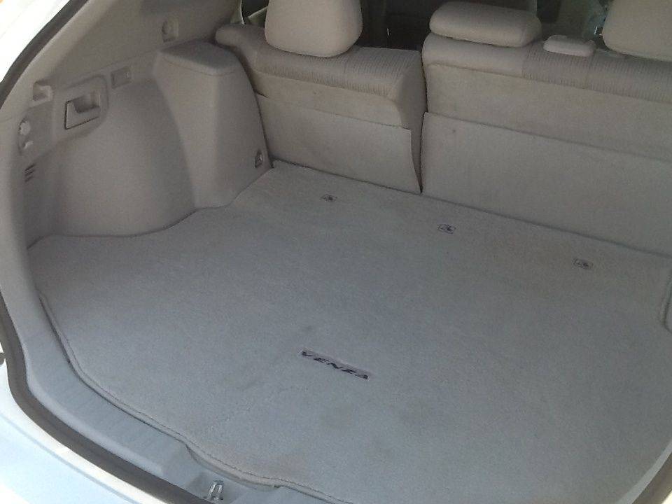

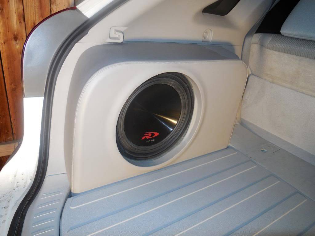

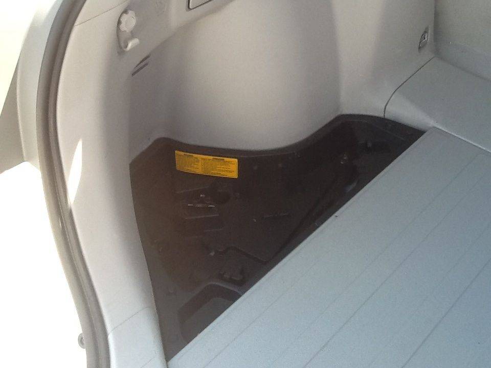

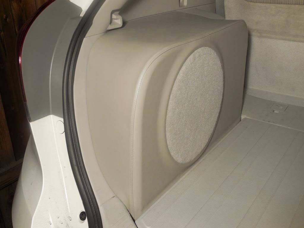

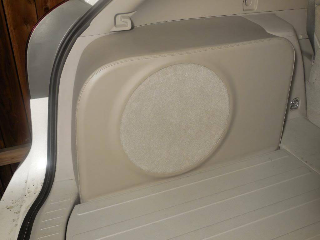

Here is my friend's sons' Venza. I've know him since he was born, now 23. I will be doing his install as a favor for him so this build will take awhile. It depends on my little free time and the boy's wallet so he can buy the equipment. It will be done in stages.

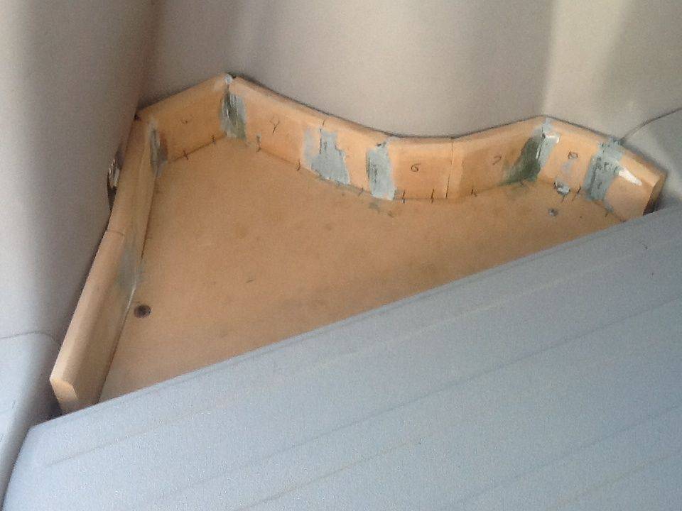

First stage is fabbing the sub enclosure for a singe Alpine Type R 12"

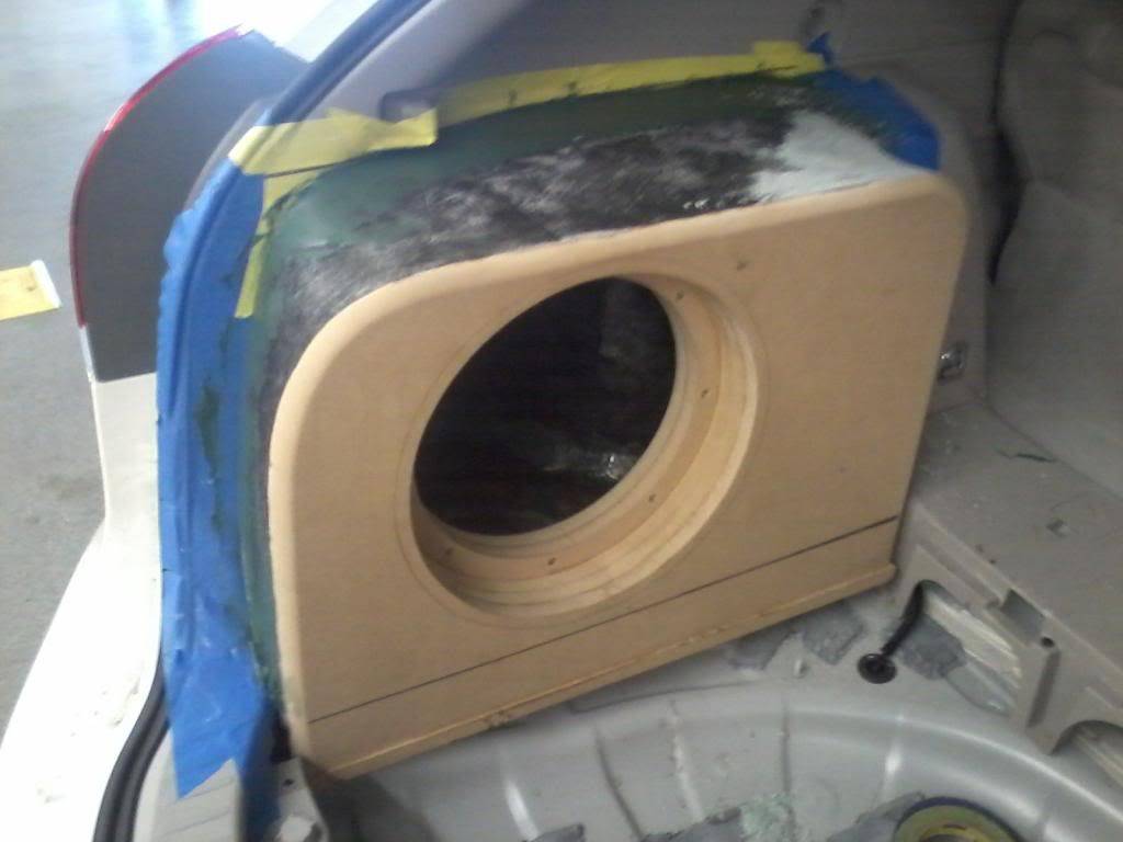

Four 5/16" nutserts install to secure enclosure

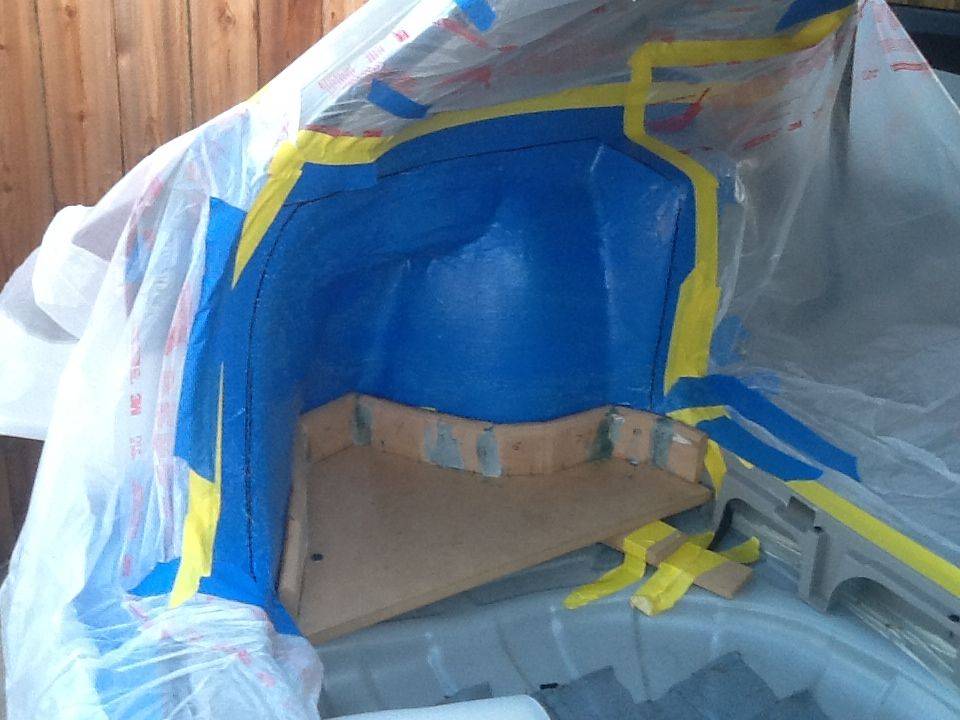

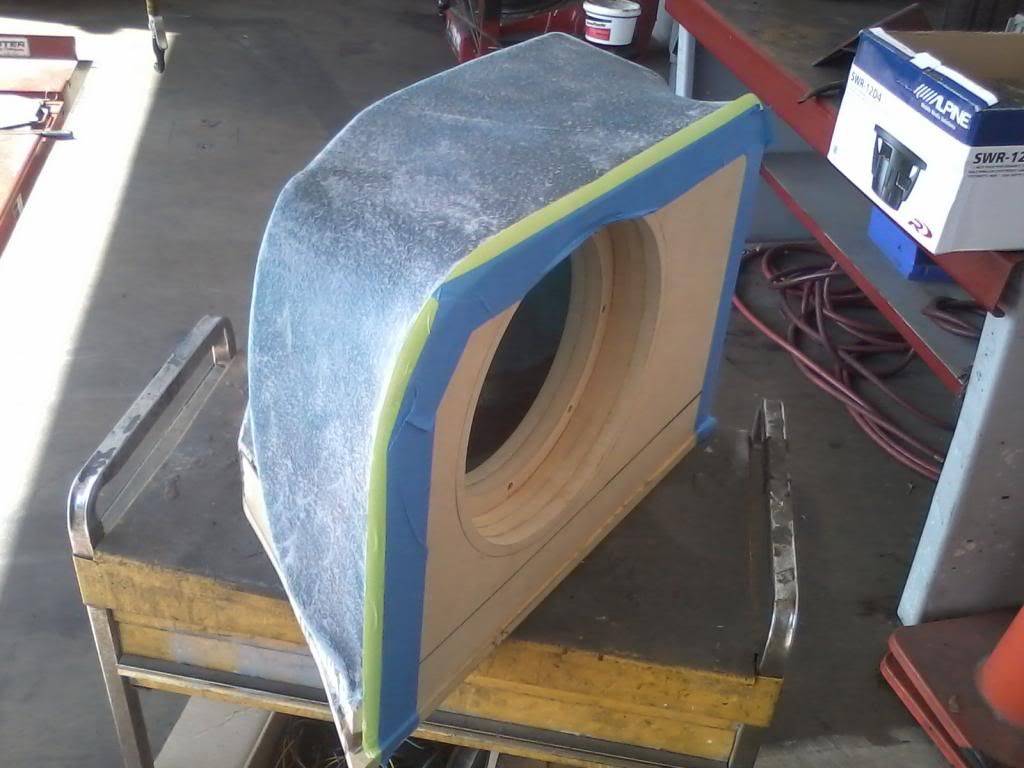

Fiberglass cured and trimmed to desired shape

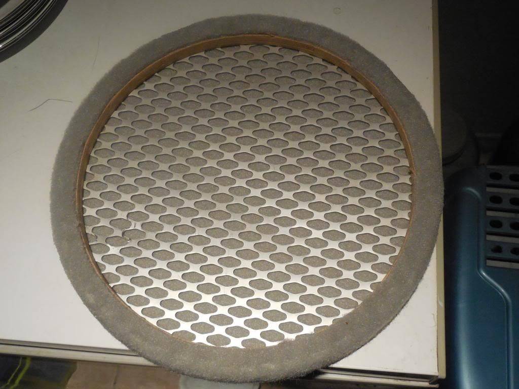

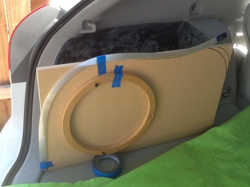

Mocking up baffle
Threaded inserts installed into baffle

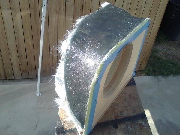

Fleece stretched
Resined and layered up

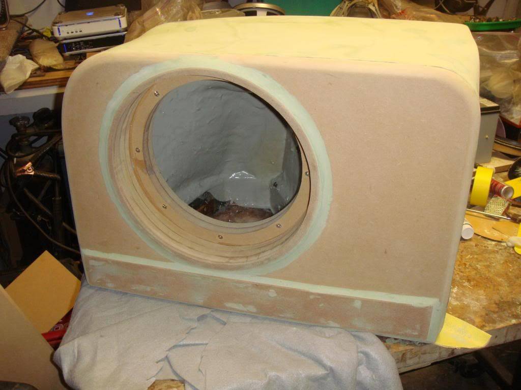

Cleaning up the edges

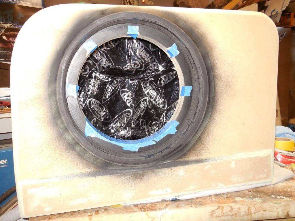

Smoothed with Rage Gold, Marglass/resin/filler mixture lined the inside of enclosure

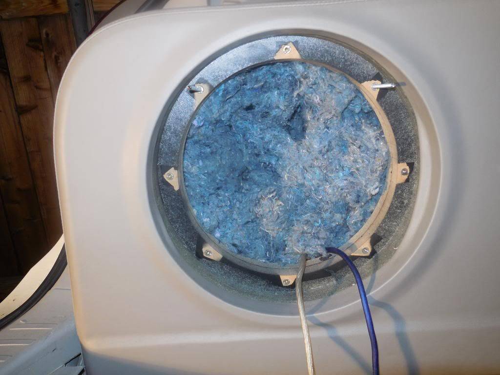

Deadened entire inside
