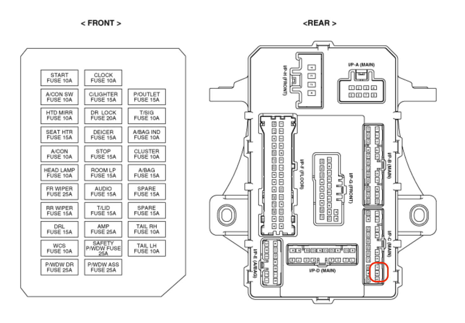

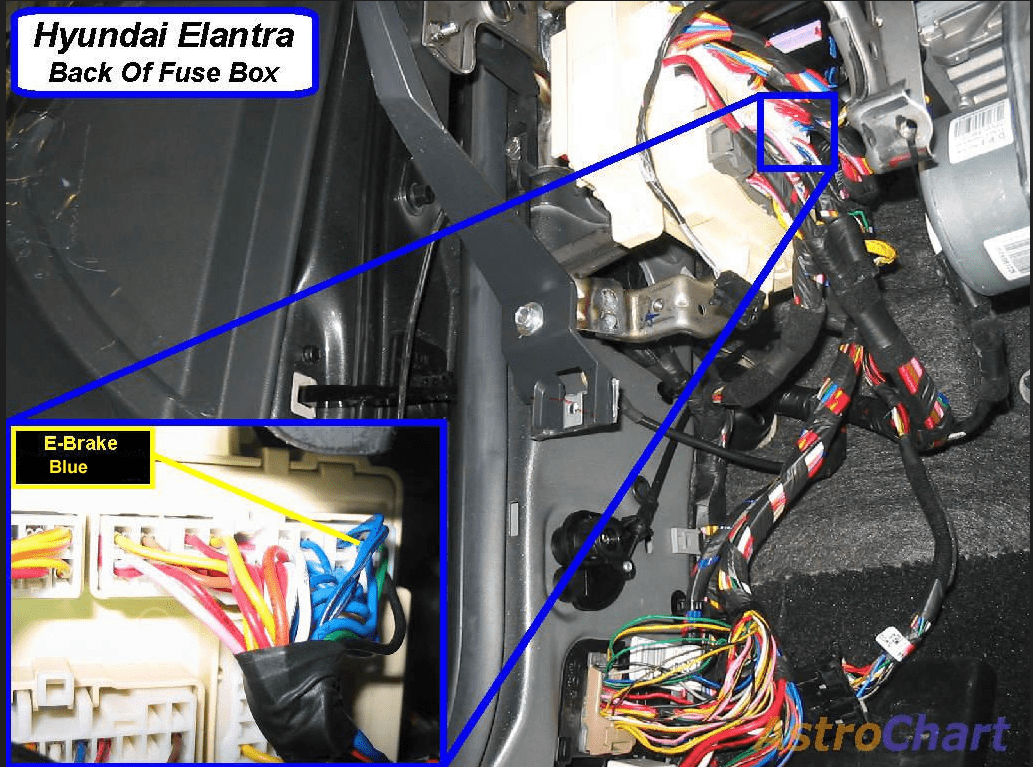

Newb here, trying to install a stereo for my son's old Elantra. I have the stereo in, microphone, etc. (it's a CarPlay compatible unit).
The one instruction I can't yet solve, and have been scouring the internet for is the part where I am supposed to connect a green wire to a parking brake wire.
The instructions say:
BlueParking BrakePin 8
Location: 20-pin white plug (C) at rear of dash fuse box
but no picture or other info provided.
So, I looked online for an explanation of the the relay boxes, and the closest I can get is:
There is a relay box and ICM box in the passenger area (under dash). But none of the info/diagrams give me any pointer to which one to look at. The relax box doesn't seem to have an 20 pin connectors, and the ICM does, but I can't find any info on the pinout.
Any help is appreciated. Thanks for reading!
Thanks,
Shannon
updating with what I found. see attached images. supposedly this is the correct wire to attach the positap to. Doesn't seem to change any behavior in the radio, so not sure of the point.
