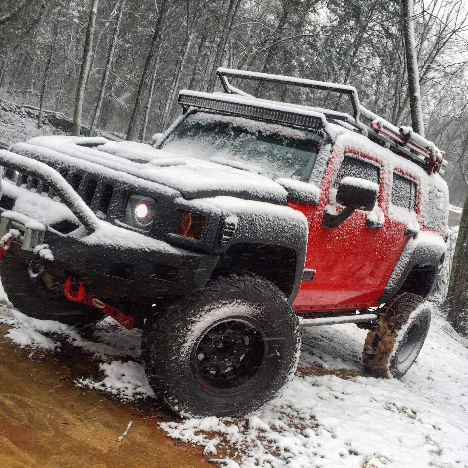

I want to scrap the gm-8601 and the champ series subs, install a 250+amp alt from power bastards, and replace the 2 12's and amp. Only problem is that my budget for the subs and amp is around 400$ so if yall have any suggestions on what would be the best combo I could get that would be great. Heres a pic of my ride.
I thought people that drove Hummers had deep pockets //content.invisioncic.com/y282845/emoticons/greedy.gif.5a53e6246569d7ab79867170f3b06629.gif and didn't have to worry about budgets....
I mean when you spend all your money on your car your pockets get empty quick. I think we can all agree on that.

[quote name='sherrod833']By the way where did you get those headlights?[/QUOTE] I made them actually
