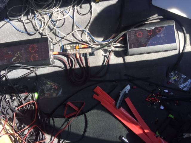

The spaghetti of wiring while I did testing before I clean it up for the final install...

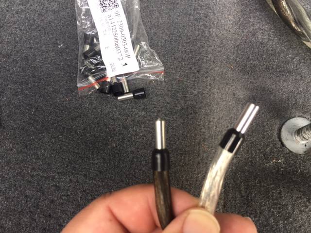

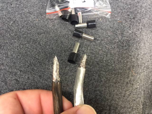

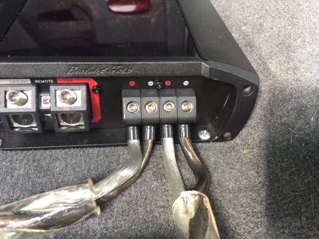

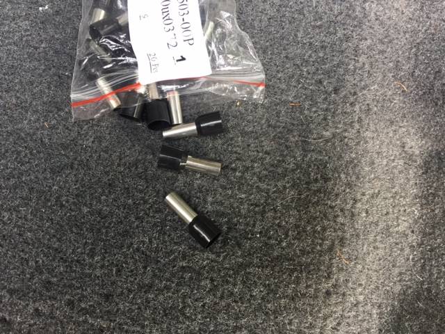

Ferrules man...never again will I do a build without them. Trying to jam these eight gauge speaker wires into the Ti2 2k amp was a mother. My simple solution...ferrules...
8 AWG Ferrules
Stripped 8 Gauge Knu speaker wire
Threw the ferrules on
They slid right into the terminals and I clamped the set screws down on them

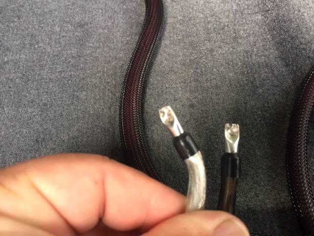

This is what they look like after
I'm going to use colored heat shrink as another layer of protection and to help see the difference between power and ground easily.
