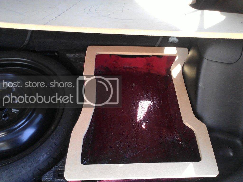

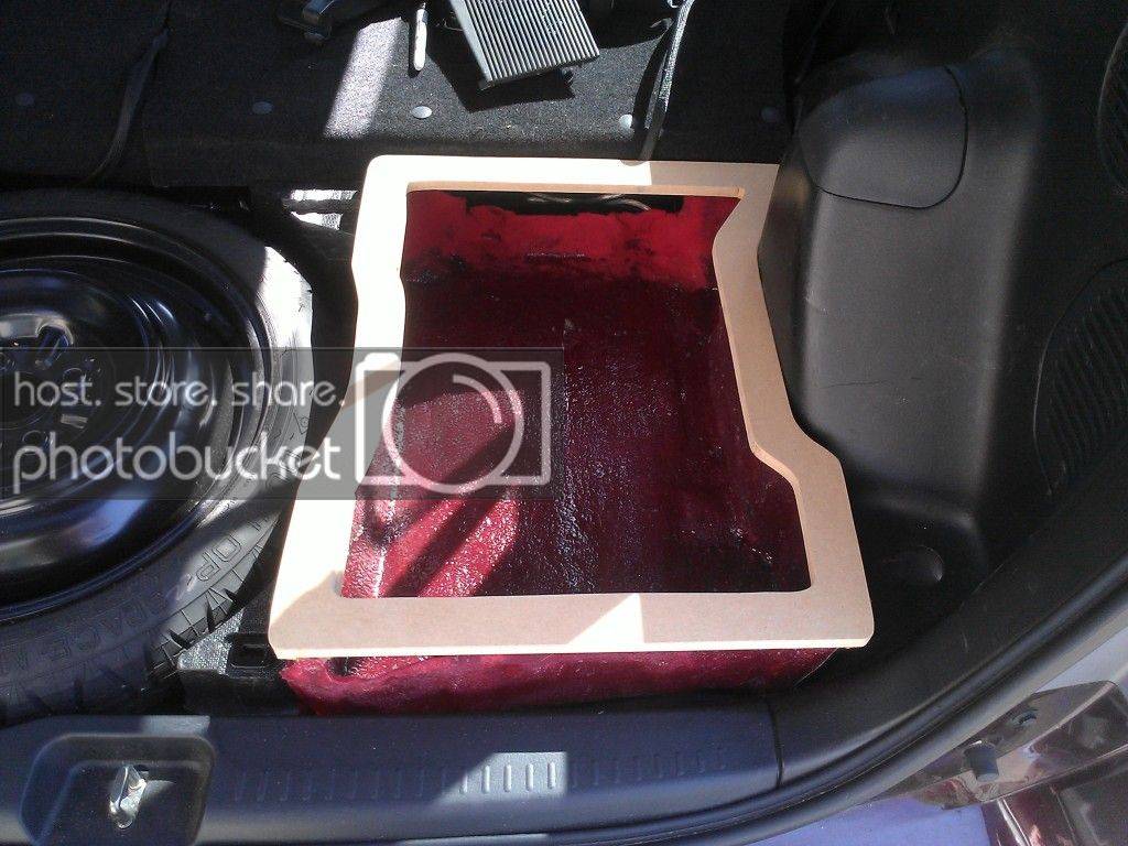

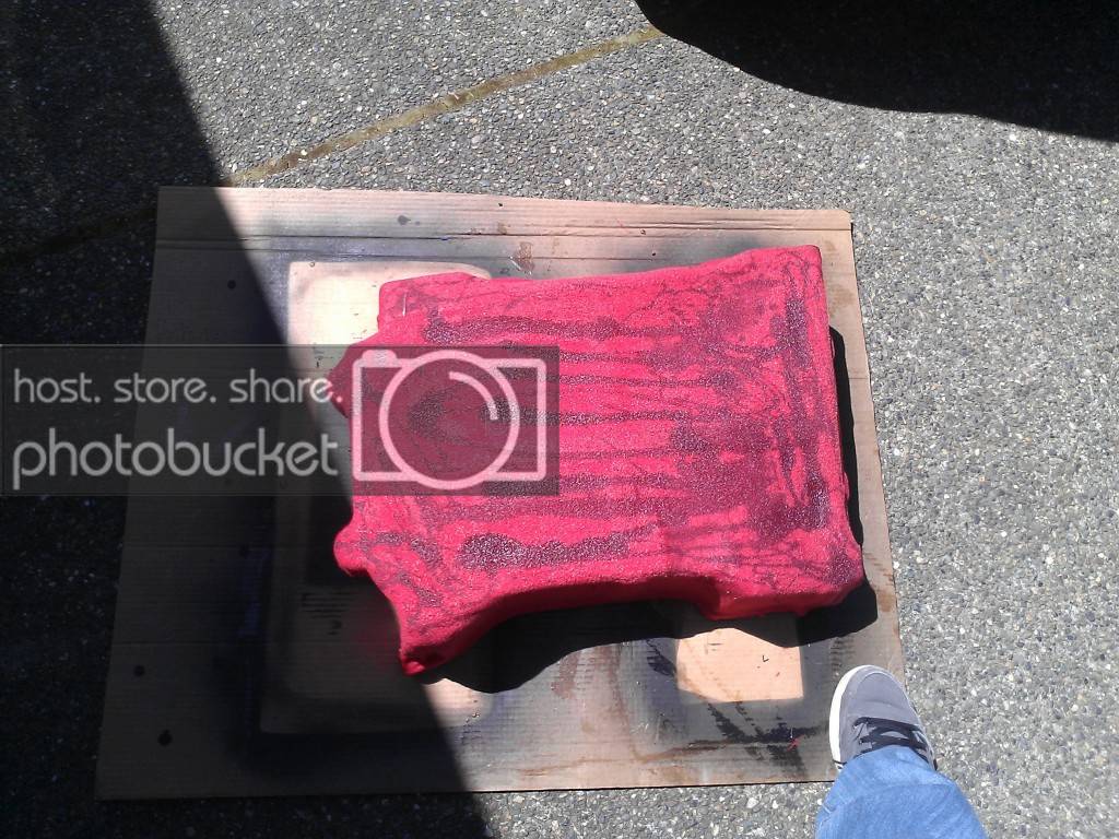

:Update:

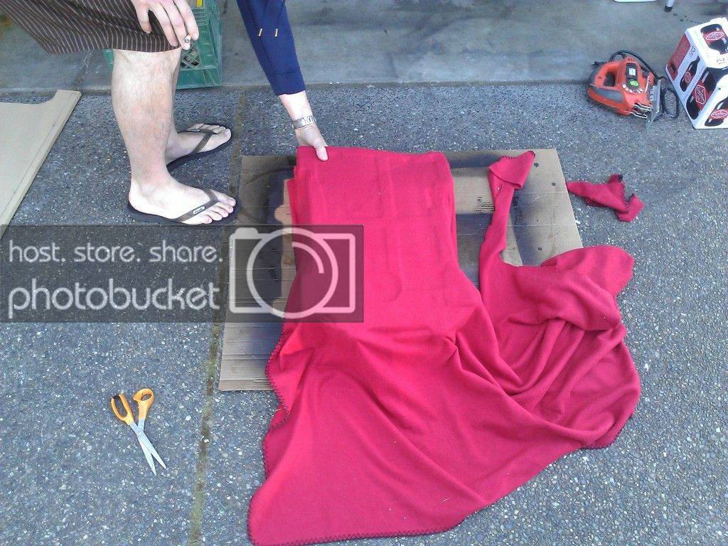

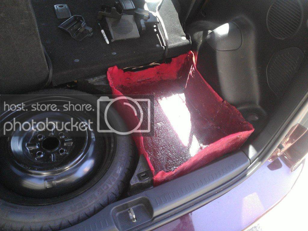

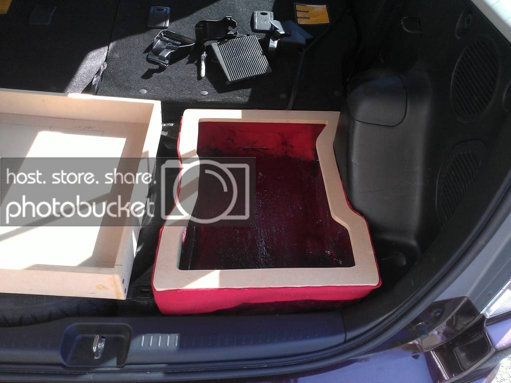

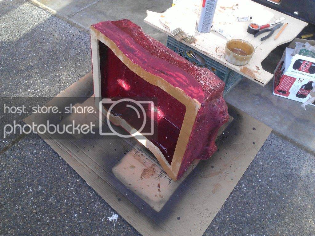

Although the photos do not show a lot of "progress" making this enclosure has taken quite a bit of time and it is pretty close to being finished.
This is my first time working with fiberglass, a good friend of mine has taken the time to show me the basics of this process and to be honest I have no idea why I was so worried about working with fiberglass. For the most part it is a pretty simple process that takes a lot of time!
What you see going on here is the stock Scion xB foam storage bin being wrapped with fleece and used to make a mold for the base of the sub woofer enclosure.
This took about a gallon of resin so far and I still have quite a bit of coating to do to get it solidified enough to support the pressure of the i10SW.
Anyway here are a few photos to gawk at. I will be applying a coat of resin every day on the outside and inside of the enclosure.
Enjoy!

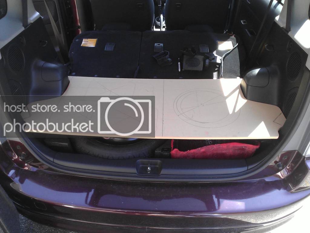

Small but big update, its also been a minute since I have posted here in this thread, no photos yet but the front stage is in and up and running. Got it all dialed in and put it on the RTA and smoothed it out. All i have to say it wow, softball sized center stage, width and depth are out past the a-pillars and on the hood. No solitified sub yet since the false floor is taking more time then I thought it was going to.

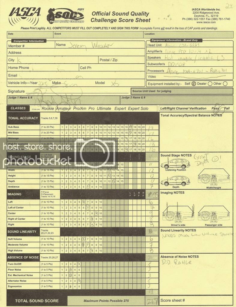

So for my first show with this being tossed together for points for a x2 show this last weekend I got a pretty good score 217.
But I have to say that a 217 for maybe 3 hours of tuning and 1 hour doing RTA work that I got a very respectible score.
I went a head and put in my DD1508 that I use for testing amplifiers it is in a 1cf vented enclosure tuned to 35hz. I had it crossed off at 40hz with a 30db slope with 20hz +6.
As far as the L3 xover points this was suggested by Bill Pleasent of Team Hybrids who is my neighbor and has lent his hands and ears to this build. The L3's really sing nice and blend well with the I6.5's. I am thinking I might ditch the tweeters and try to run just the L3's. I wish I would have taken a photo of the RTA graph it was pretty impressive.
These Gen1 xB's have amazing acoustics for a good front stage with great depth and image with that windshield angle being as steep as it is.
Anyway here is my score sheet. I cannot wait to get the back done and get a good week or more of hard core tuning and RTA work in.
Nice report card. //content.invisioncic.com/y282845/emoticons/smile.gif.1ebc41e1811405b213edfc4622c41e27.gif
Getting more left stage width can be tricky with those locations. You want left channel info to reach the left ear first and get some shadowing to the right ear.

Once I start working on the false floor again I will post some more photos!
