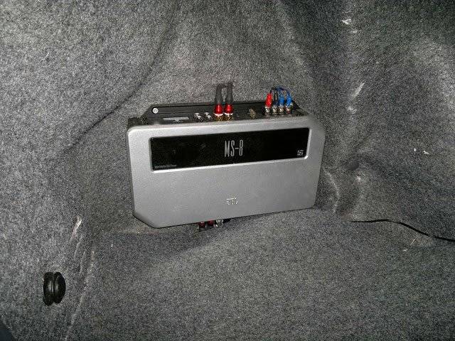

I have started a 5.1 project, this is the first time I am attempting surround sound in the car. The altima is perfect for this as it has a large fatory opening for a center speaker.

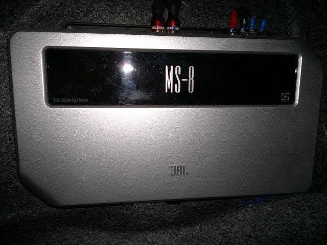

MS8 with logic 7 will be decoding the stereo output to 5.1 and most of the gear is massive audio

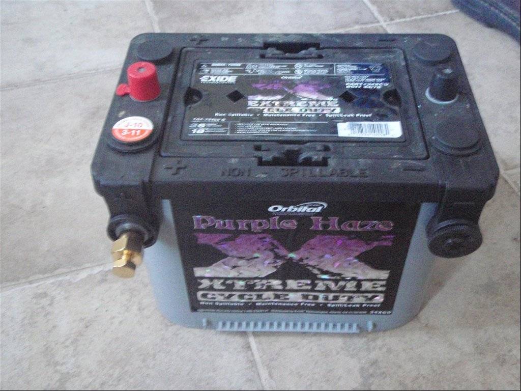

Batt is a an orbital

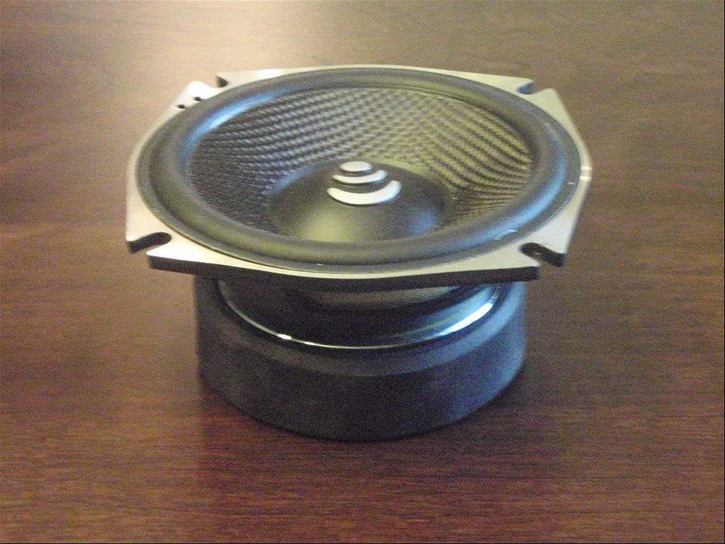

Here is a beefy pic of one of the comps from the CK5 set

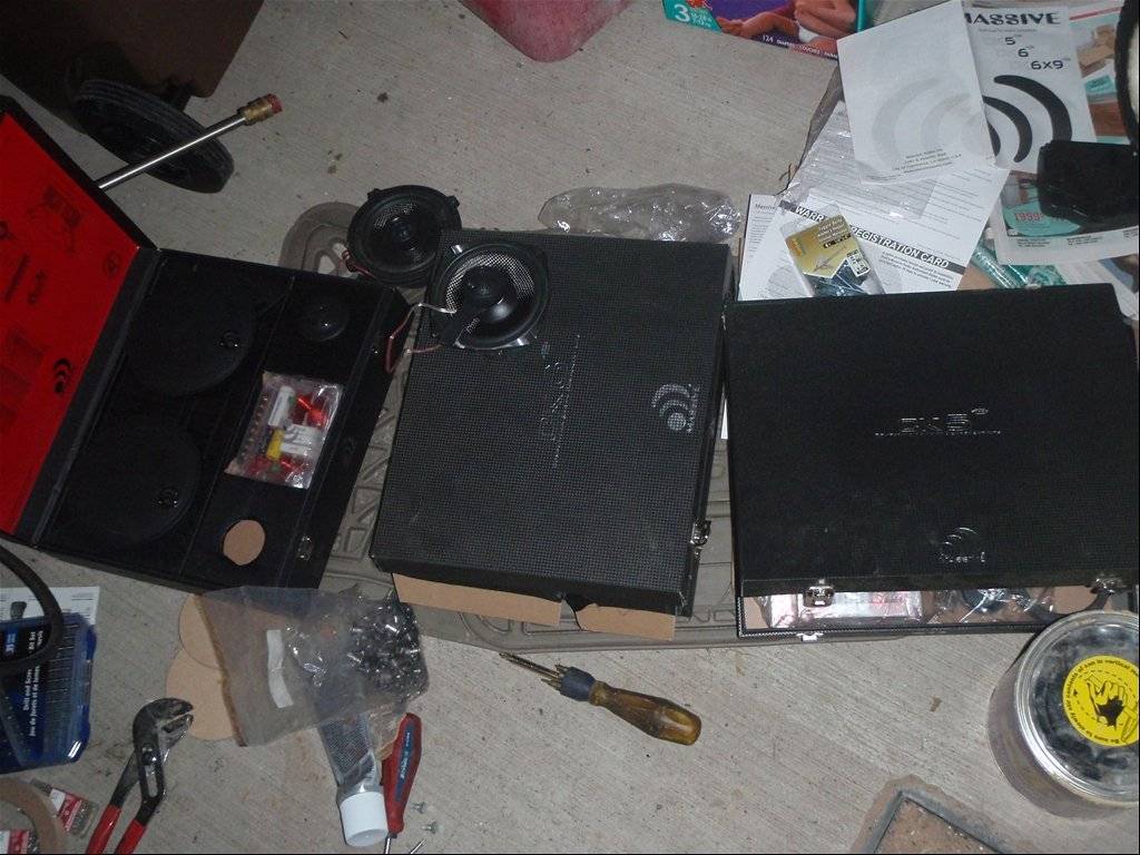

Here is a messy pic of the the component boxes, they also open like a treasure chest.

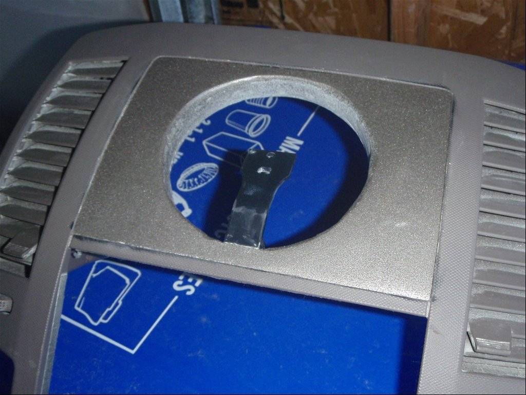

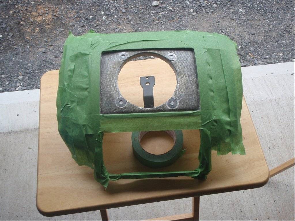

Here I am prepping the center channel area.

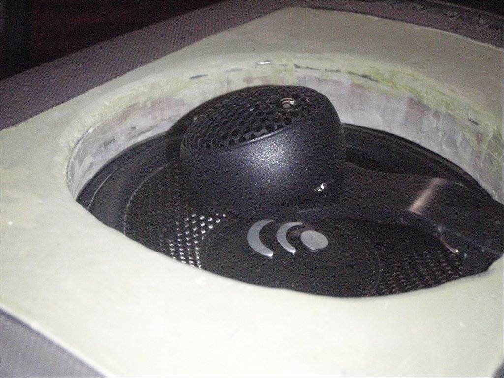

test fit

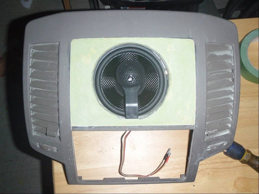

the speaker is mounted behind the baffle and I used the coaxial mount adapter- that usually gets mounted to the speaker frame -onto the speaker ring. this adapter adds some usefull versatility to the set.
Unfortunetly the tweeter sticks ou to much and I don't want to use the stock grillas it would'nt be asthetecially pleasing IMO. Anyone have any ideas?

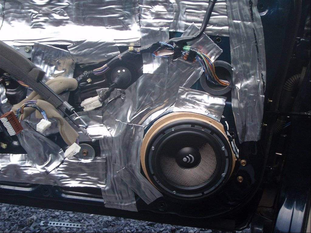

I put down some deadener on the door and cut an MDF ring to fit the CK6 mid on. That mid can go low and has great midbase output. I was pleasently surprised at the results from these guys. right now I am not using a sub and have them HP @ 50hz, this is far from ideal but they get low and have lots of impact. My like!

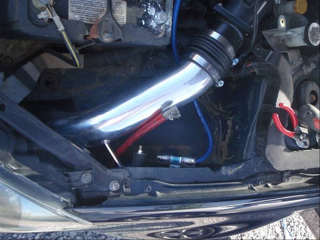

Here is where I ran the pwoer wire, along where the hood release goes.
It is 0awg CCA wire form some no name brand.
Before I installed the batt, the CAI is one of the best mods for the altima, it is a cosmo racing CAI, good quality but cheep in price.

I tried spray painting the center speaker area but I don't like the results
So I am attempting something different all together now, no pics yet

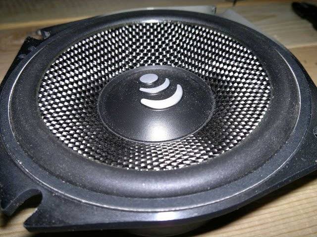

With some slight mods to the factory rear speaker adapter, the CK5 mids sliped right in. I love it when it is this easy.
Here we can see the CK5's in coaxial mount config. I love the flexibilty but I don't like that there is no "wire management" and that if one chooses to go the coaxial route, the stock grils will no longer fit. Luckely I wasn't intending to use the stock grills for the rears.

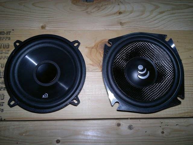

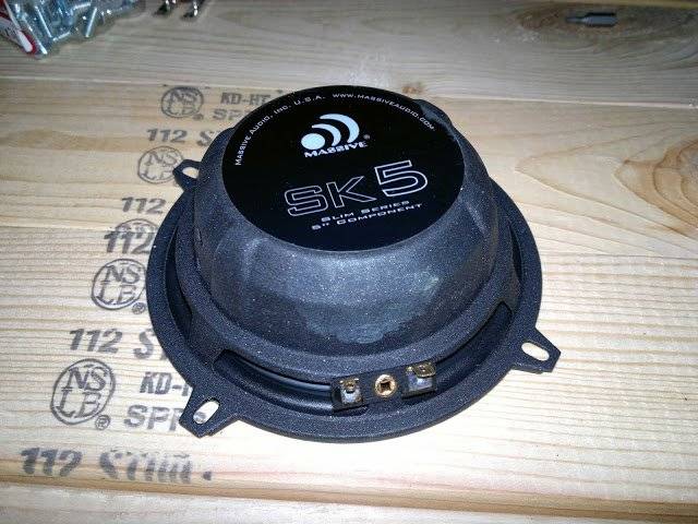

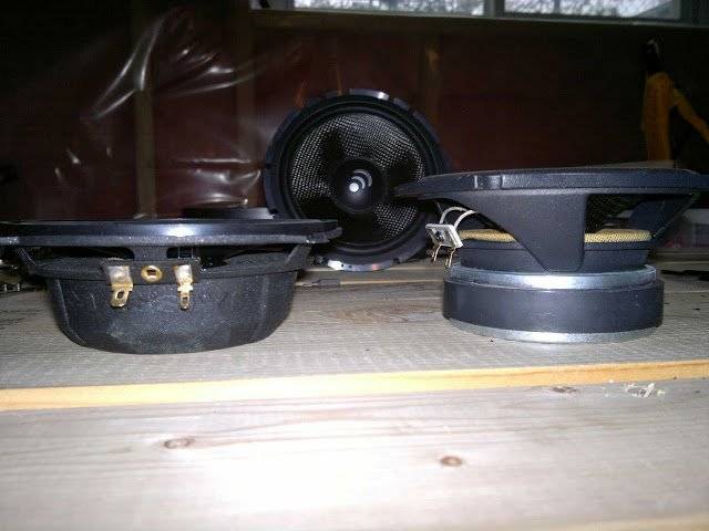

The new shallow 5 1\4 that will be replacing the other beefier and also to big 5 1\4. This is form the shallow line form massive audio. These little things are pretty. Massive knows how ot make things look good. And they are pretty **** shallow. You can also see the 6.5inch standing in the background. Sweet mid it is.
Here it is from behind, here is a discoloration that seems quite obvious in the pic, but I can't see it normally. I guess it's just the camera that is particularly detailed.

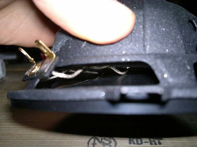

Like the ck series, the SK terminals aren't to exiting

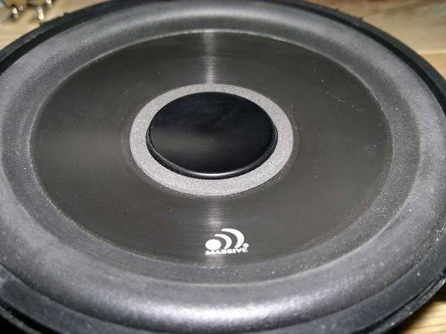

Here is a close up of the cone. Very attractive. We can see the cap looks a bit odd, tha's because these can come in coax mode with a tweeter sitting in the place of the cap.
Here is a nice pic of the outgoing ck5, good looks once again and since I have 2 that aren't doing anything now, these might go into my kick pods for a 3 way front. Of course I would need yet another amplifier.

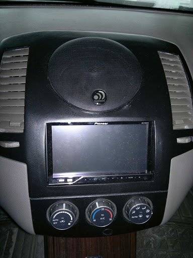

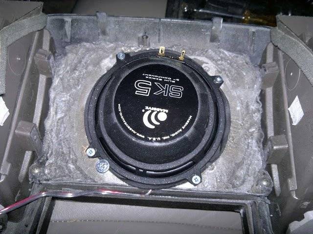

Now on to replacing it in the dash
The back of the panel doesn't look all that nice hehe.
You can see an extra screw sticking out. This is something we never hear about when guys talk about those hurricane\propel\T nuts, if those things decide to "un-catch" wile tightening or untightening..the screw shall always remain and is essentially unremovable. What a B@$%@!

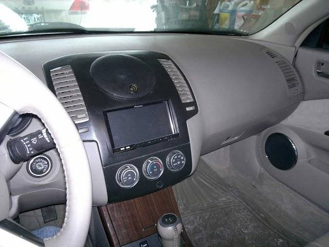

In any case this thing fits right in.

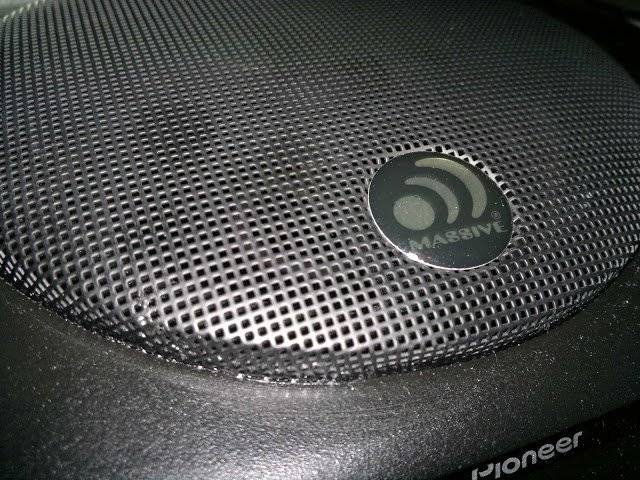

It's to bad the grill hides the cone... the cone looks really good. Dark titanium like.
Now the panel fits perfectly. I am considering changing over all the brown fake wood trim to the textured black, I like ti but I am not sure, what do you guys think? Looks good or out of place?
