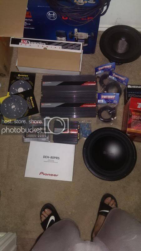

Heres a couple shots of some of the equipment I will be using

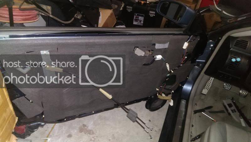

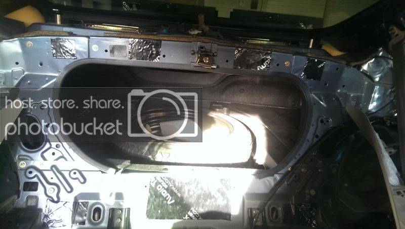

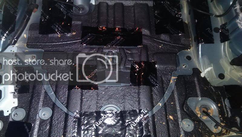

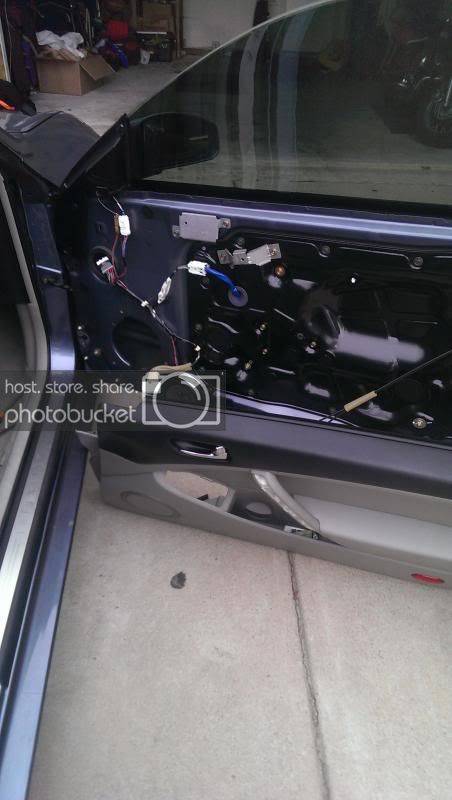

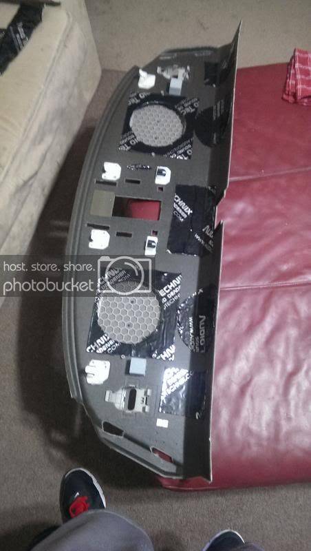

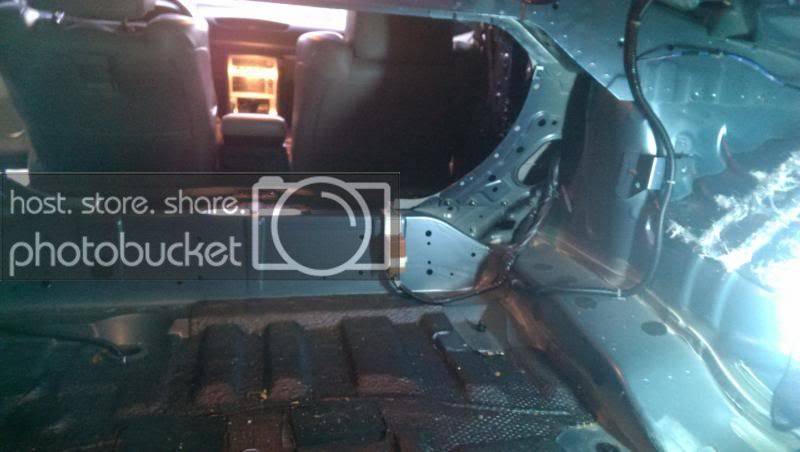

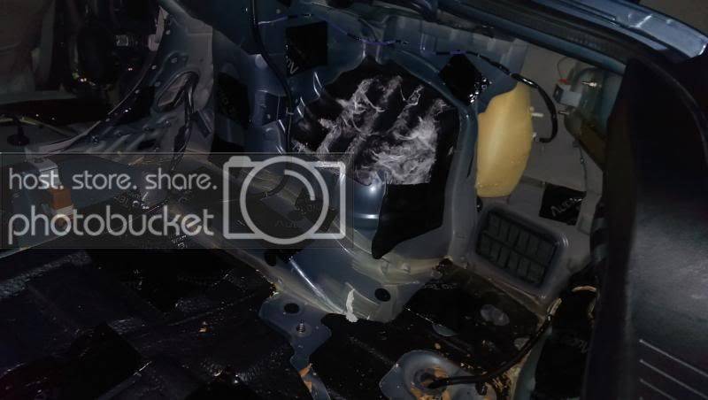

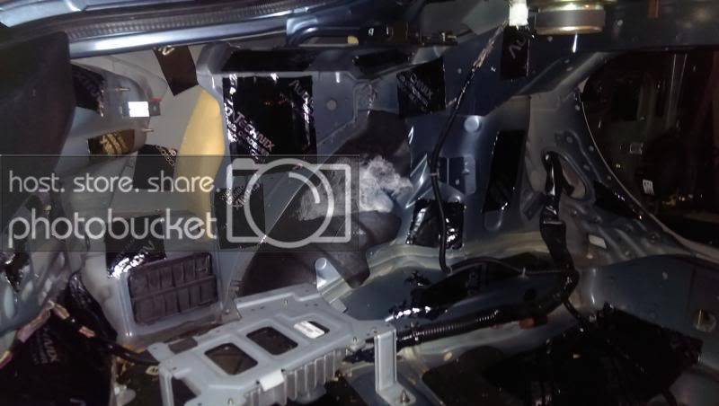

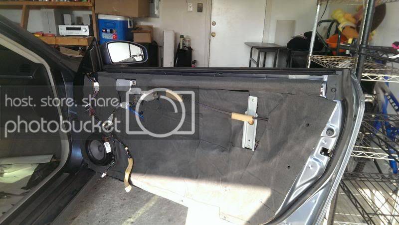

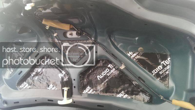

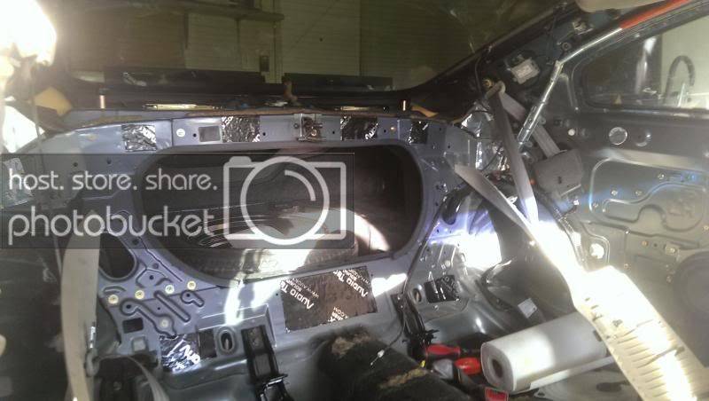

The first step in my build is sound deadening my car. Sound deadening, Mass Loaded Vinyl and CCF is the route im going. I did alot of research on it from SDS and other places and decided this was the right thing to do. So since my MLV and CCF is still in the mail , I decided to put the deadener on the doors, trunk , backseat , and the rear deck. So stripping my car apart is the first thing that was done.

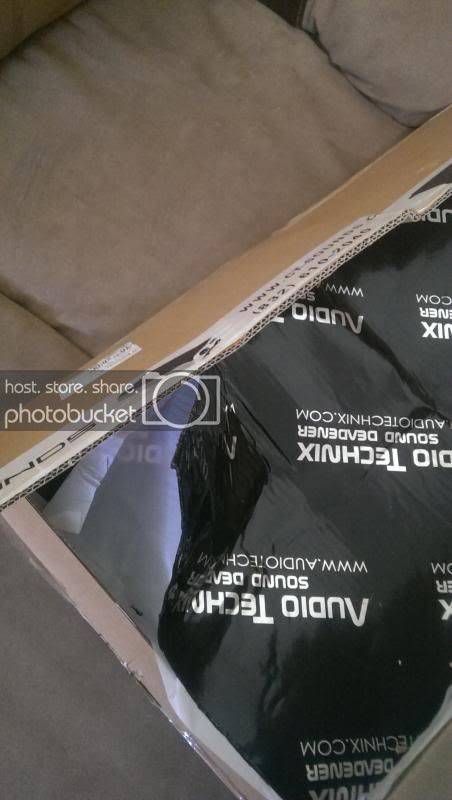

That was all that was done today and heres a mini review of the AudioTechnix:
Although this deadener will be used in junction with MLV and CCF , I can truly give my impressions on it as it is installed by itself. Alot of the rattles I had are now gone and my stock system is a little less muddier. The midbass seemed to cleaned up a little bit and overall sounds a little cleaner, I guess its from the lack of the panel's resonance? I guess the true test will be when I put a sub in. Ease of installation was VERY easy even though I didnt use a roller. Did cut my thumb a few times from smoothing it out :/ Overall I am very pleased with Audio Technix!

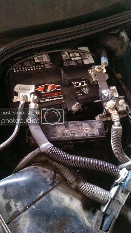

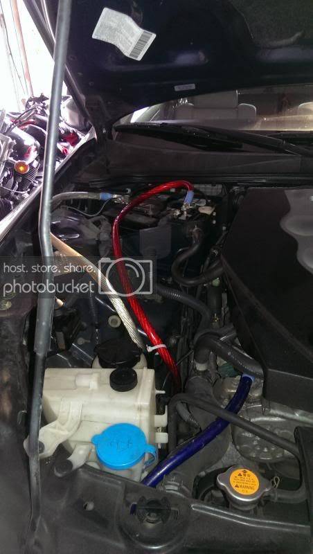

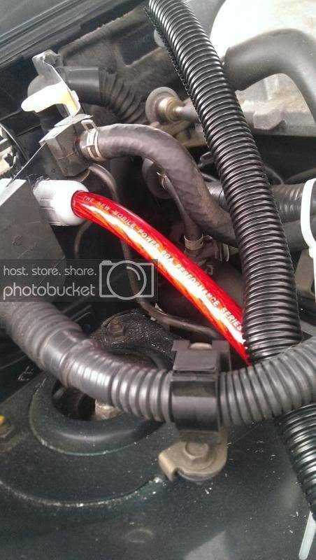

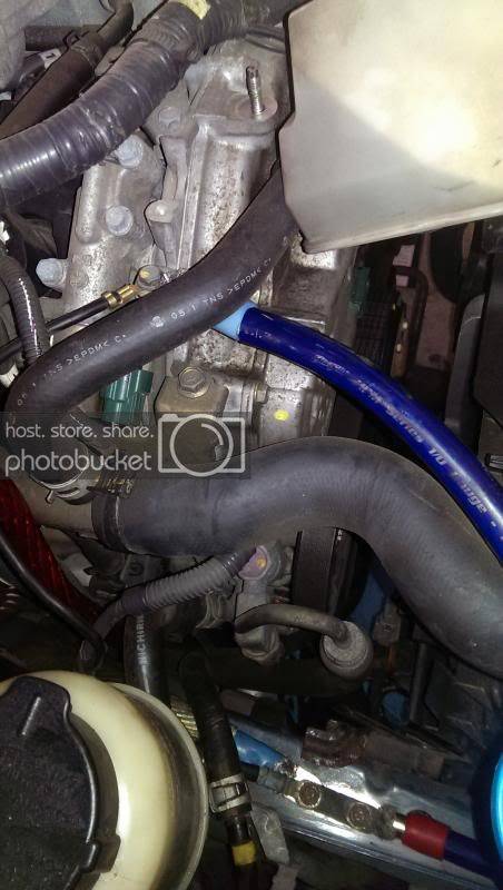

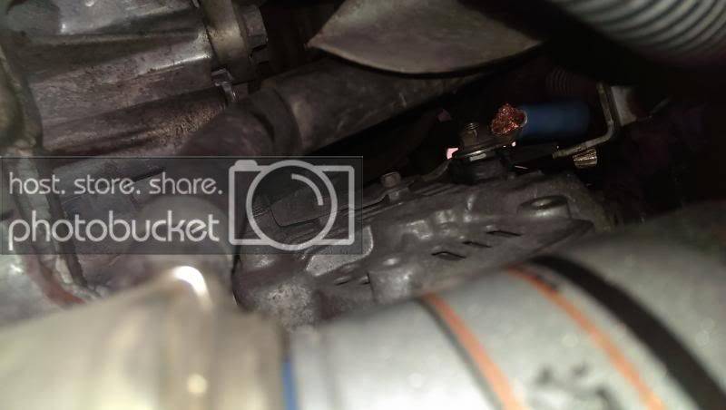

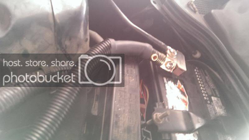

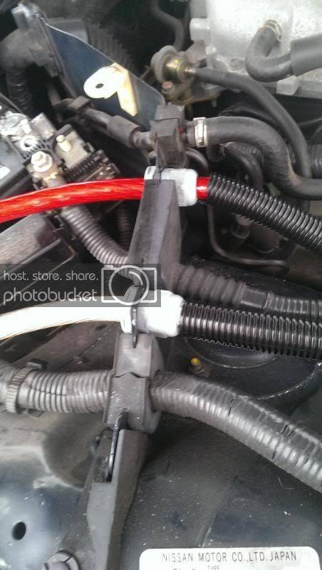

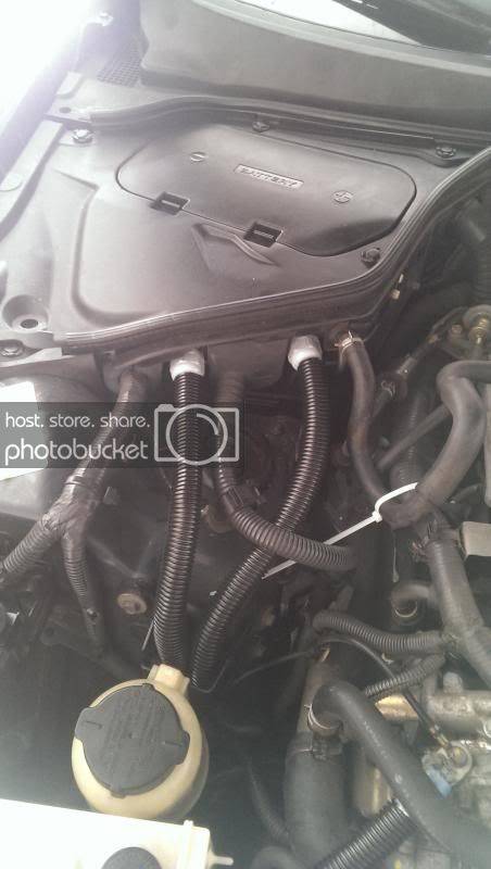

Today I got the big (3) done. I never realized that I completely forgot to buy battery terminals so I will be using the oem terminals until I get new ones......
The alternator was a pita to get to, took me over an hour just to get this wire in there
After I get new battery terminals and grommets for the battery housing Ill update new pics , need to buy some techflex as well. I just wanted to get the wires in.

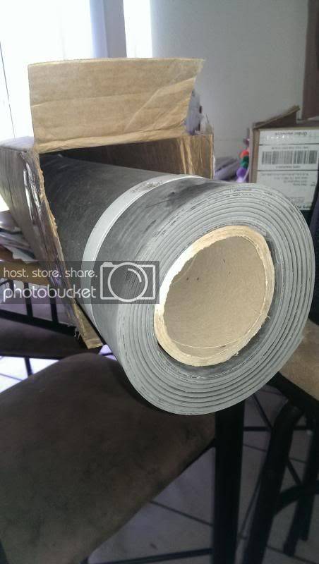

This came in the mail today, now just waiting on CCF.

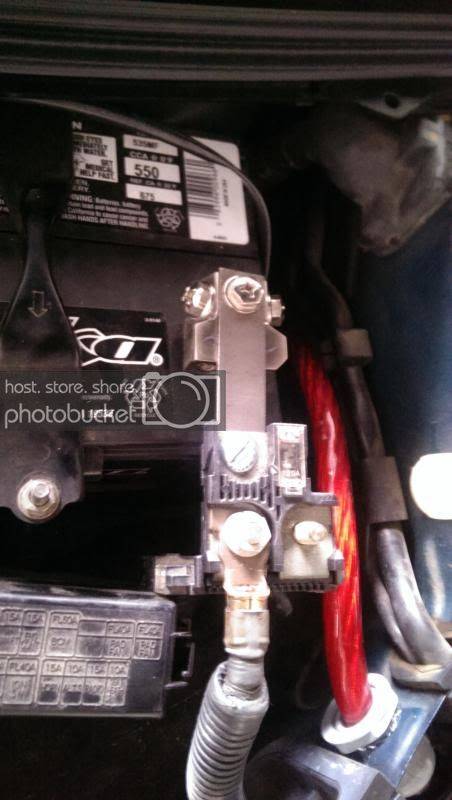

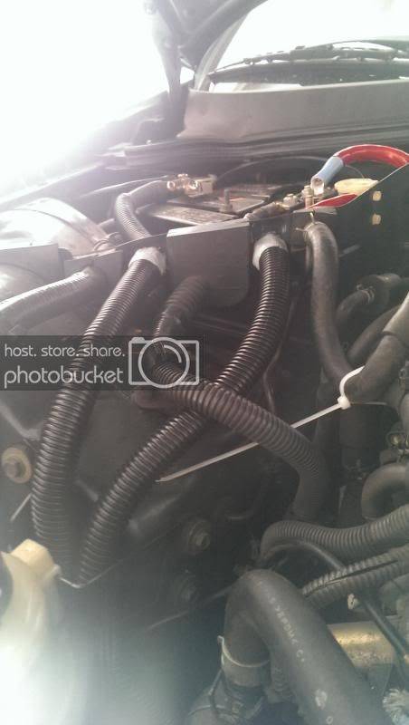

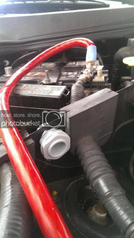

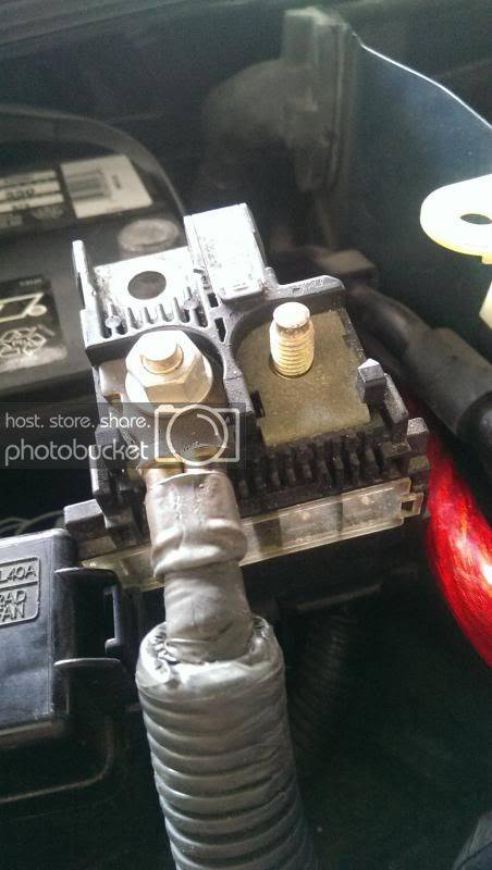

didnt get much done with weekend, I did however finish cleaning up the big (3). Got everything done on the big three except positive terminals on the battery, this car has some kind of fuseblock on it and I want to use it with conjuction of the battery terminals I bought so I have to fabricate a little bussbar.

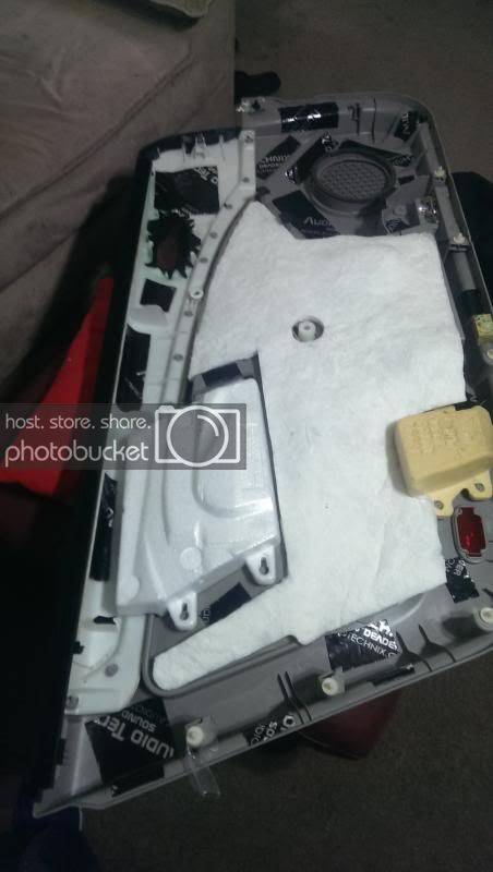

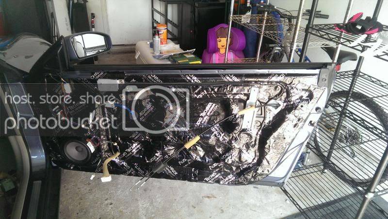

Little bit of progress, I finished wiring up the big three. I bought 80 sqft of ensolite from raammat. I would highly recommend it , its really easy to install. I also applied 100% coverage of audiotechnix to my doors and covered it with ensolite. I must say it made a WORLD of difference. I even made a video.

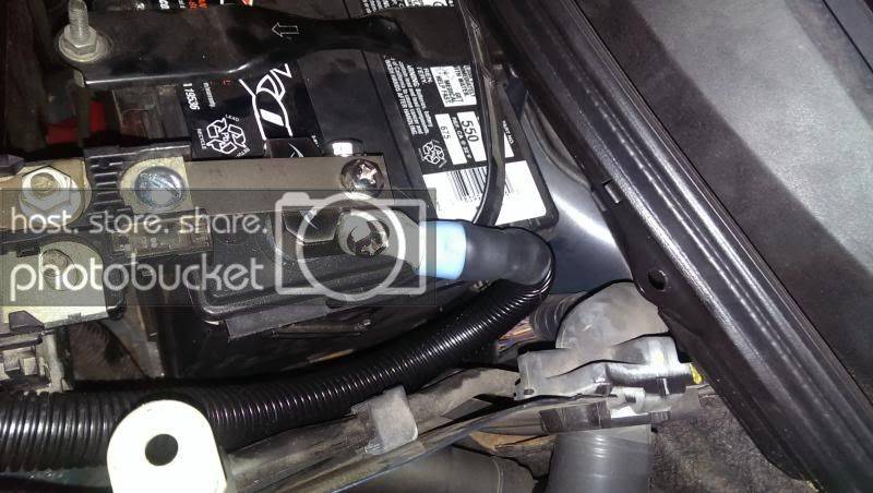

Wanted to keep the oem positive terminal as it has fuses on it so I had to find some kind of buss to attach it to the stinger battery terminal I bought.
video of me knocking on bare metal on the end vs deadening with ensolite, made a huge improvement IMO with even stock speakers
