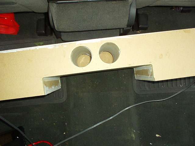

A friend of mine who's leaving Atlanta for a new job went off to Europe on vacation for a couple of weeks and left me his truck keys. I told him I wanted to pick up some furniture while he was gone. In reality, he'd bought a pair of 10" subwoofers months ago, and I wanted to do the install as a going away present. Here's what I came up with:
I originally intended the subs to fire downward. Here's how they fit:

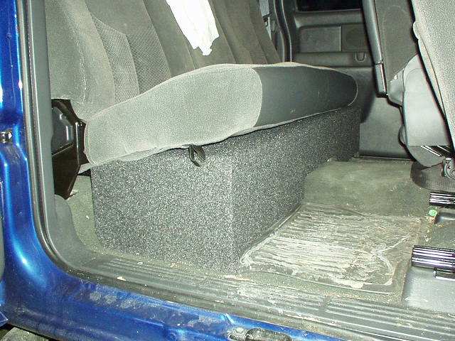

Here's the mostly-completed install with the amp rack in the middle. The wires weren't hidden yet when I took this picture:
As it turned out, the amp didn't have enough power to run two of these Power Acoustik subs effectively. Check out the magnet on this sucker:
Also, the sound was a bit muffled with them firing downward. I ended up running both channels of the amp into one sub and flipping the box over:
Here's an action shot of the amp with the "plasma sphere" on top:
I was a bit disappointed that the amp wasn't strong enough to run both subs, but it sounds pretty darn good even with just one. All in all, I'm quite happy with the results.

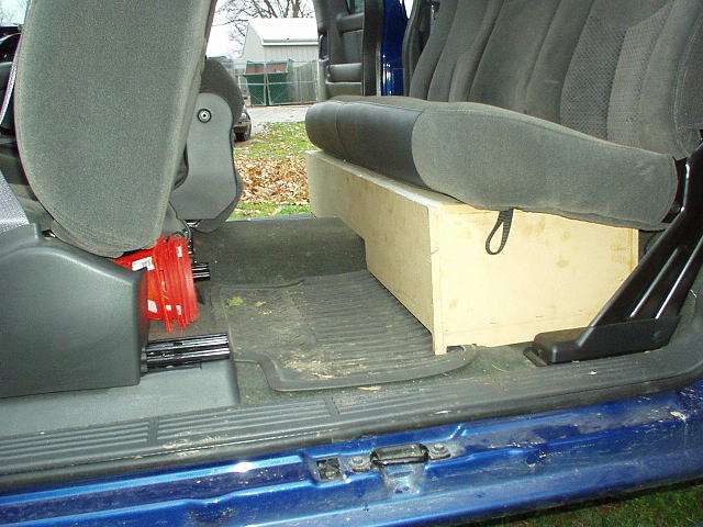

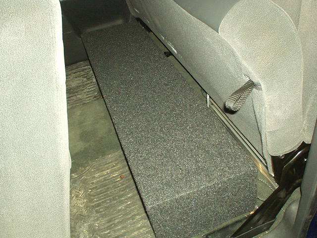

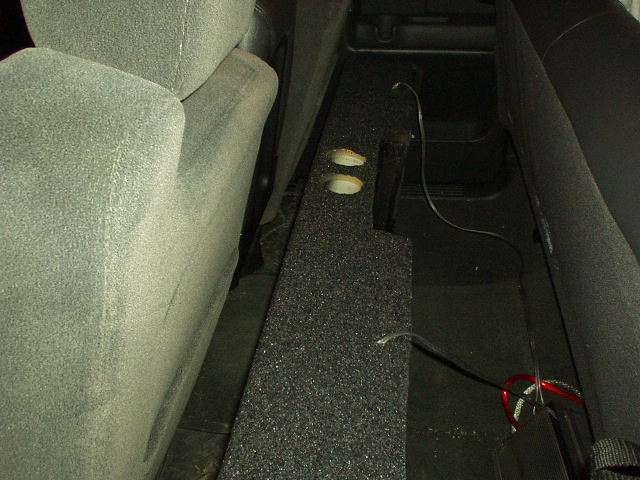

and in case u think i'm full of it....here's my old 04 silverado ported enclosure for 2 10's, downfiring, ports to the back....and my single ten, port to the side, downfiring box.....
before carpet ^^^^....
carpeted^^^^^
the single ten ported^^^^^^ again the memphis pr500d tha powered this was on the lil ledge behind the seat...
in both boxes i recessed the subs to get a bit more clearance. with the dual ten box, i used 1/2" mdf and seperate chambers....worked beautifully...
