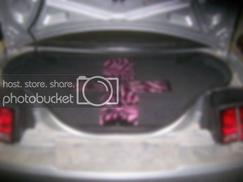

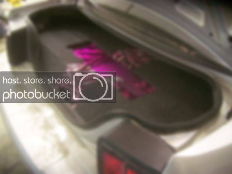

This girl wanted almost the same thing. She just handed us the keys and told us to do whatver with the money she had lol. (bigger budget then the last build). but of course im not going to have 2 cars runnin around with the same systems lol..
Car: 2003 Mustang
Sub: Digital Designs 1012a
Amp: Kenwood 400w
Head unit: Kenwood 742u
Wiring: Knu 4 awg.

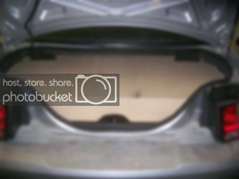

Bottom covered in stainless steel formica. matches the outside of the car really well...box is 2.6 @36 hz.( lol rob)

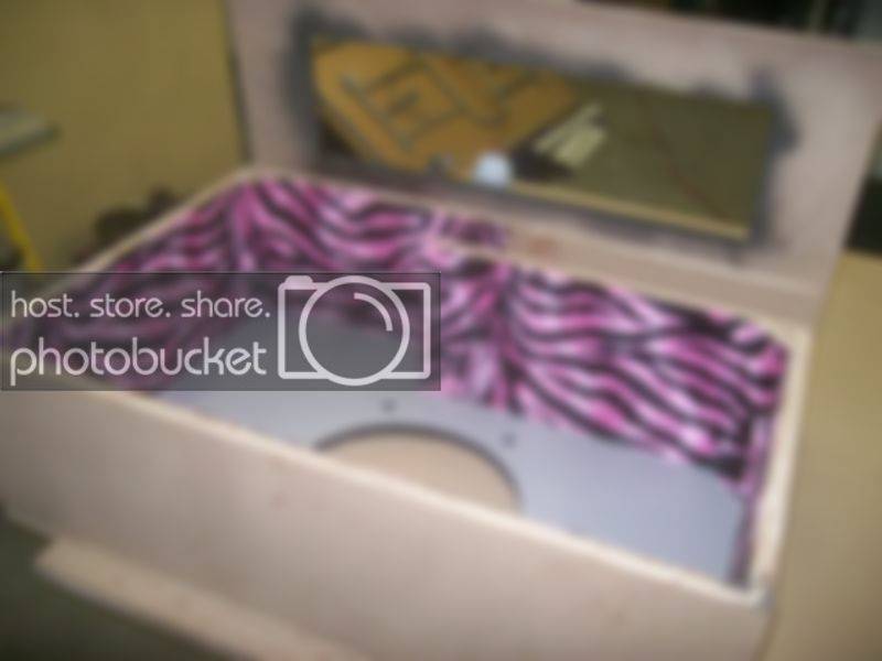

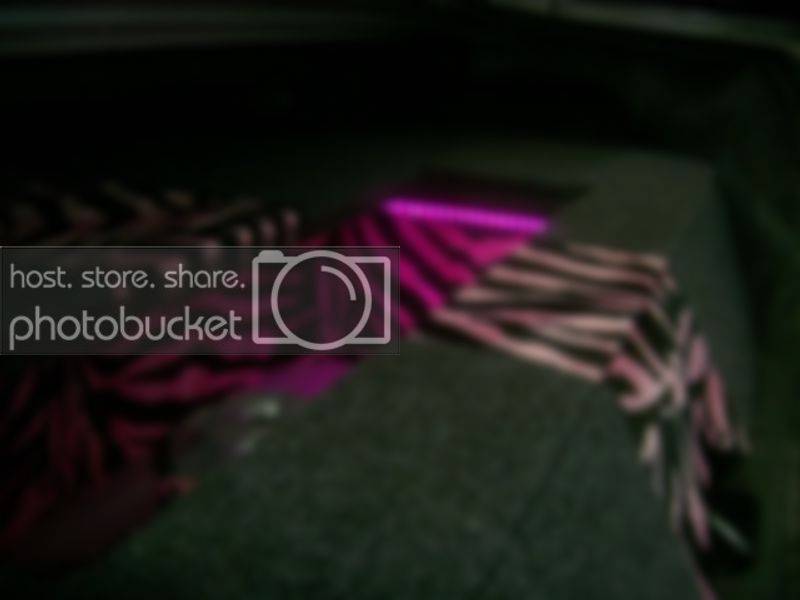

Covered the sides in some pink Zebra Rob got from plush furs

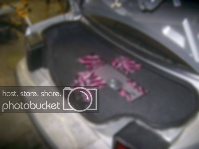

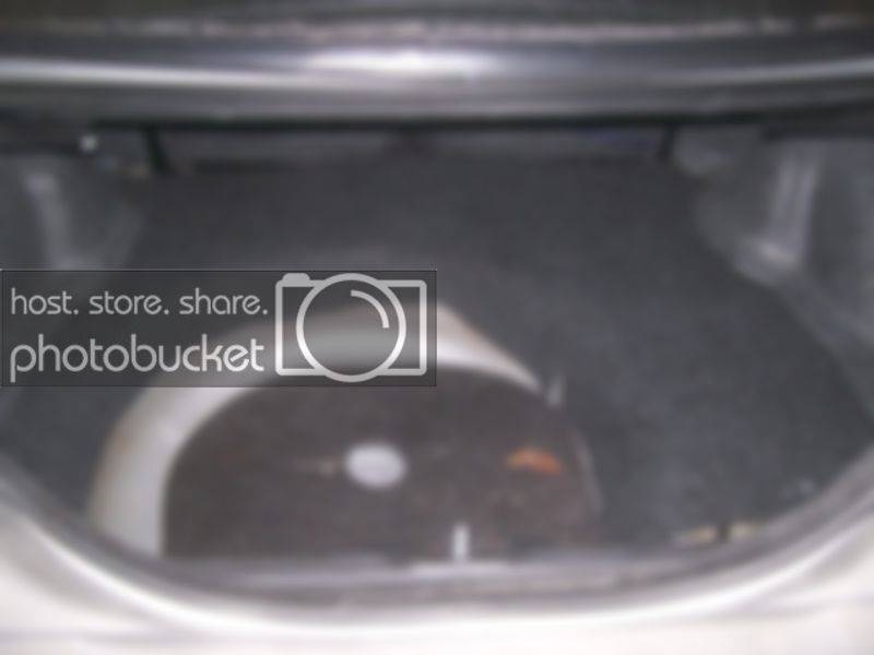

Sub will be downfiring into the tire well. after taking the stock spare tire cover off the whole floor was bare so i glued some trunk liner down to make it look nice again.
Pink LEDS.

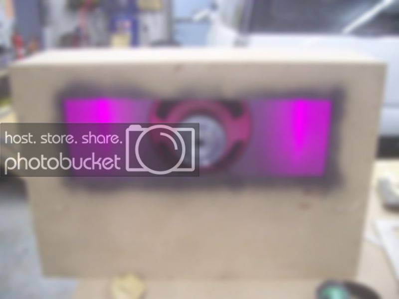

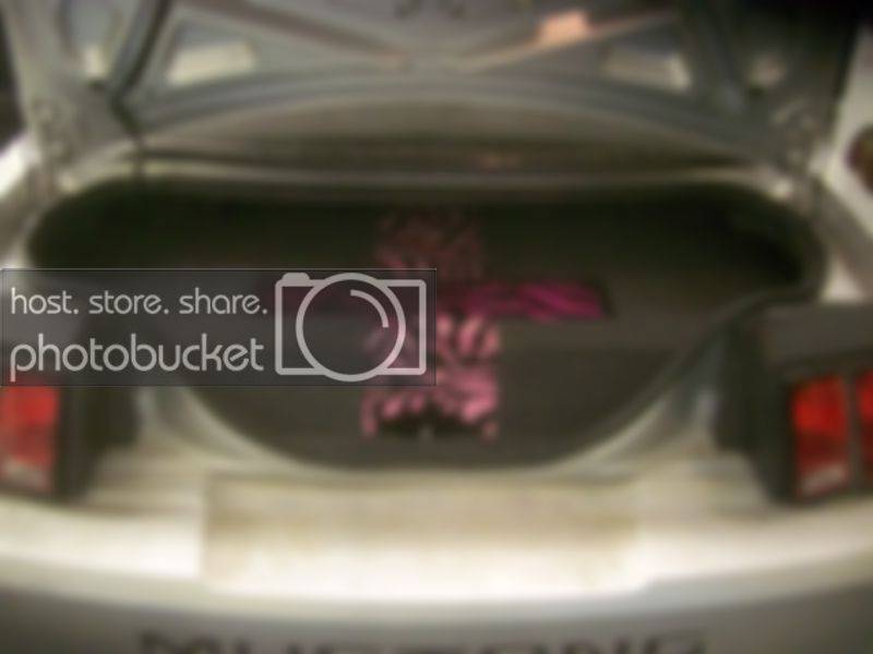

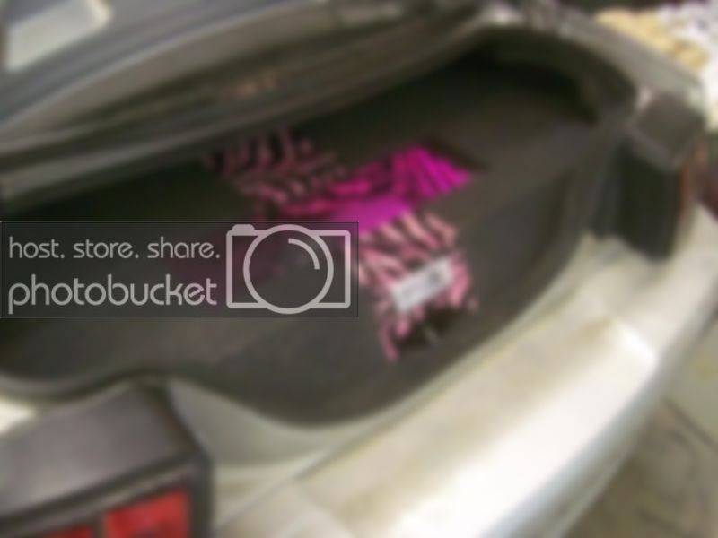

Lol These pics were taken before i realized i put it all together and fofgot to put the magnet boot on lol... the Plexi is 1/2 thick. ive been getting alot of PMs about how to do the plexi and what not. its simple just gotta pre-drill and countersink. then use some kind of gasket foam to seal it, screw it down and caulk the outside and your done.

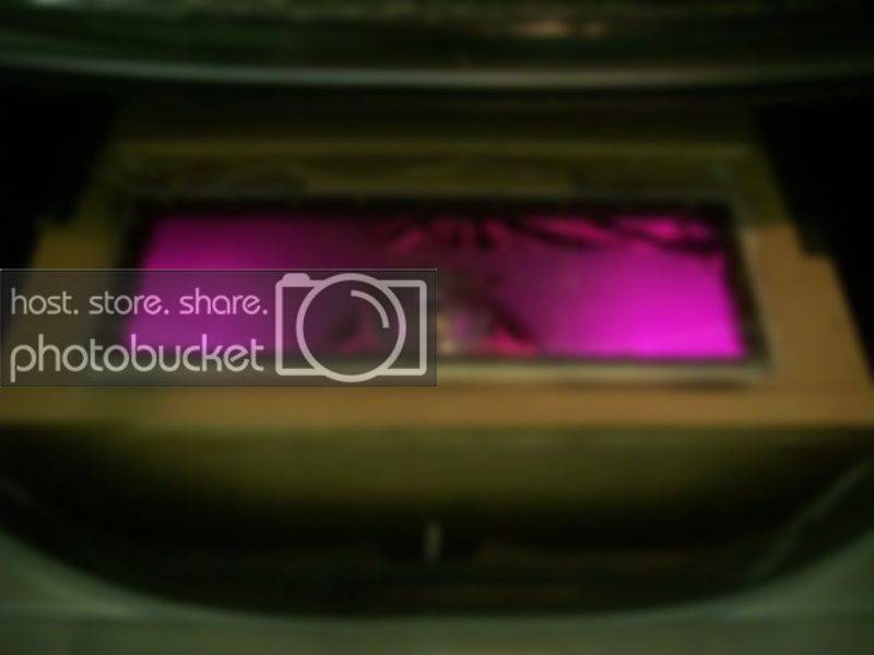

Leds hooked to the trunk switch.

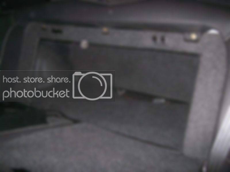

This was the trim panels before i cut the window lol we sent a pic to her and told her it was done and she was like wtf?? lol
