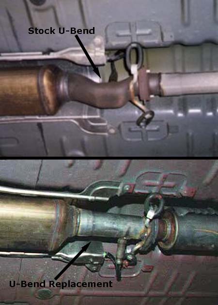

1. get the U-bend replaced with a straight piece of pipe.
GM decided that they wanted to mount the rear O2 sensor vertically which results in the picture below. Replacing the u-bend will free up some HP.
