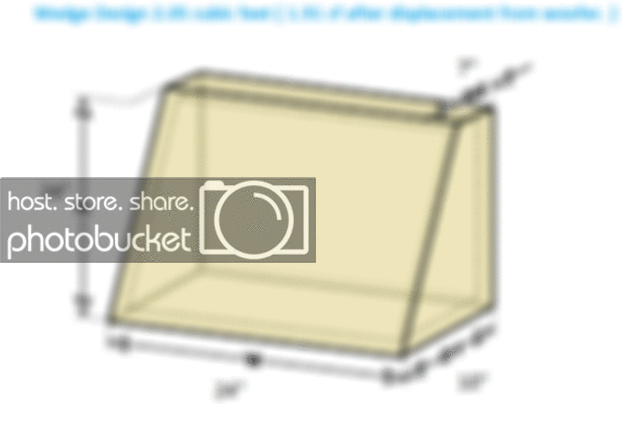

This is what I came up with. I'm hoping it will work ok behind the seat. It seems kinda deep for a single cab though to me without looking at it //content.invisioncic.com/y282845/emoticons/frown.gif.a3531fa0534503350665a1e957861287.gif
JL Audio recommends 2.125 cubic feet of airspace so I'm close. If space permits I'd build it exactly to spec but I get the feeling this thing is gonna be tight if it fits at all.
That will work fine. I have a 99 reg cab and i can get you dimensions if you need them. I put 2.5 cubes behind the paasenger seat so you should be fine.
