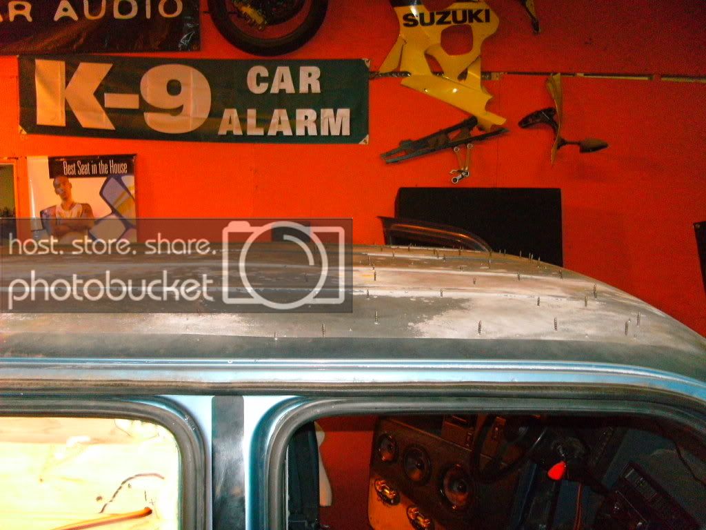

as for the vids gonna have to wait for the competition on sunday for those. we have too much work to get done between now and saturday night to try to get it lookin halfway decent. we screwed through the roof with all the wood on the roof so yesterday i had to grind down all the screws then we put kitty hair up there over the holes then we are going to sand that down and rhino line it just like assman did but with black since the van is going to be all black.

Good shit man. Glad to see it got put to use... sat here for a while. You definitely need to get some video footage of this thing. It looks crazy. I never seen wood built into the walls and metal like that before.

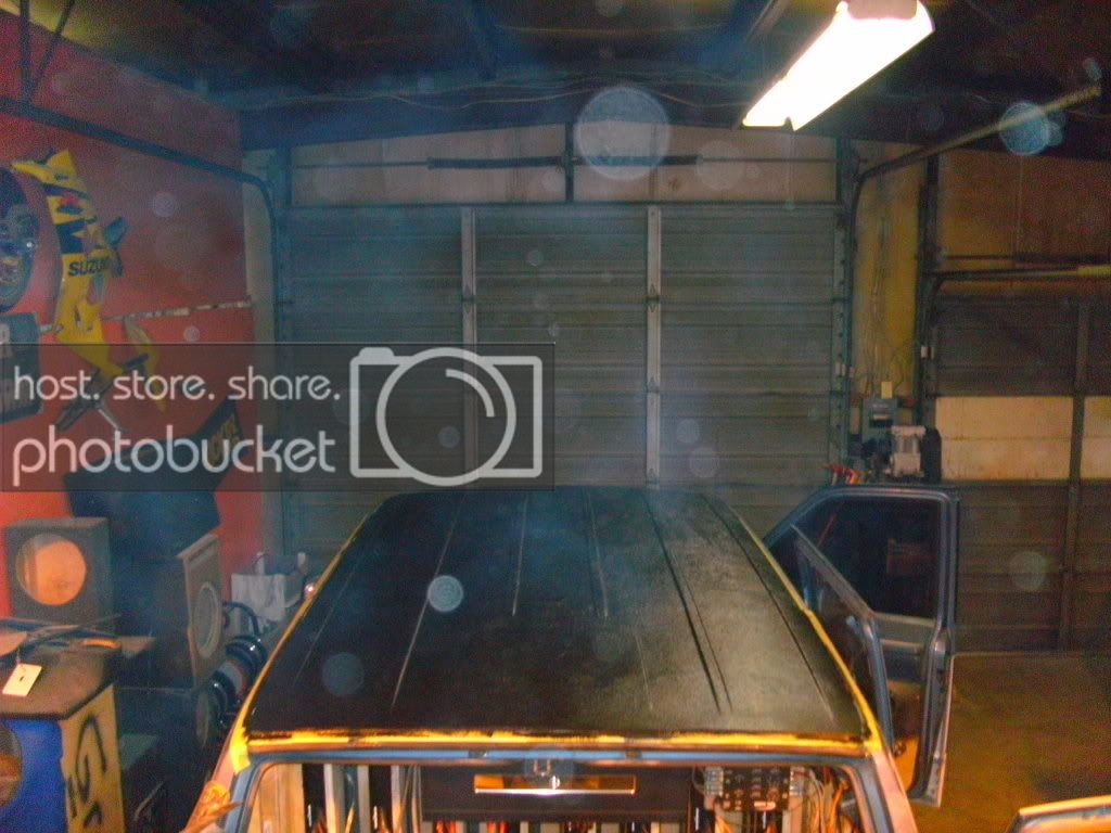

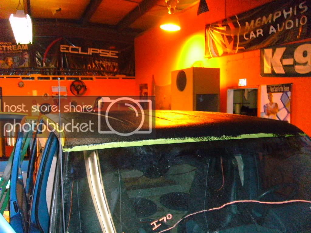

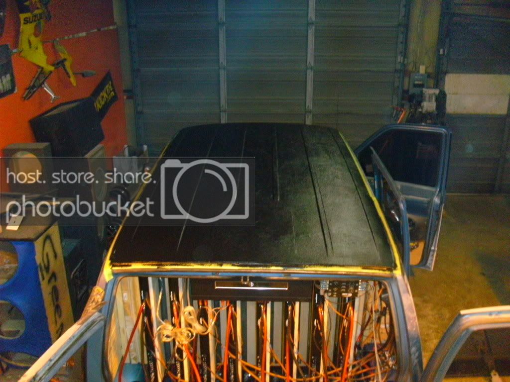

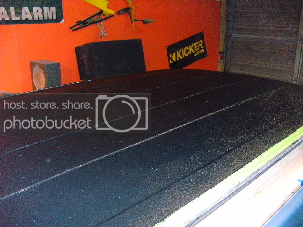

rhinolined the roof with 2 layers so far. probably do another layer or 2 and call it complete
