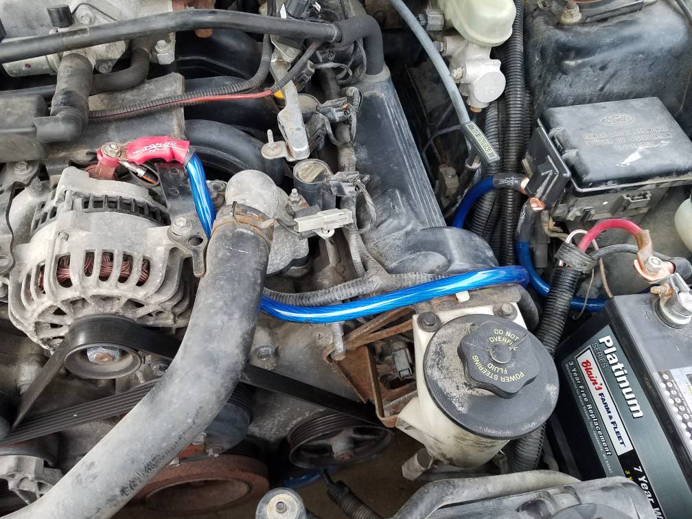

I went ahead and ran it like factory, figured it worked for ford. Plus the original was like 8gauge so this is definitely better lol

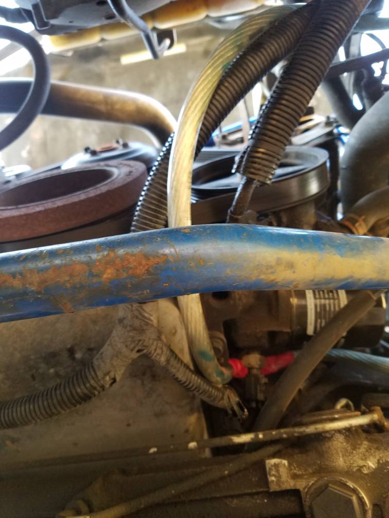

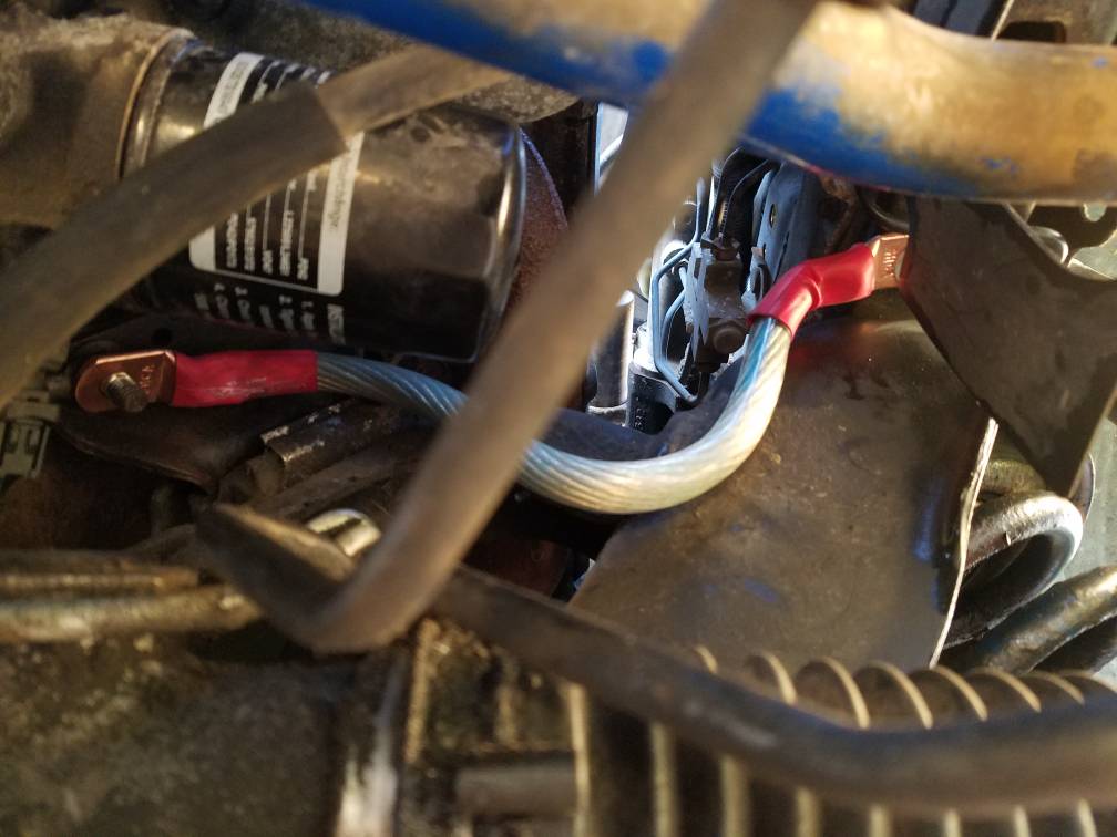

I ran the grounds last night, still need to add some wire loom and extend a couple of the smaller factory grounds. Not a big fan of these battery terminals, but on the plus side my lights are brighter before.
