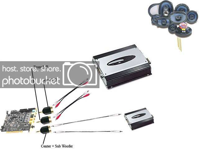

I have a vw jetta mk5 currently i have 3 way front doors, and 2 way rear doors.
I am going with Rainbow SLC's, and i would like to install a midrange 4 inch speaker in the huge useless went
so front driver's door will have a 2 way component, woofer, and tweeter
and passenger front door will have 3 way, and the midrange will be placed in the middle of the dash
would that set up work. i would liketo get an even sound, but i bet you can alway tune a cross-over
Yev
Unless you have something to process the center channel, it will sound like crap. If you try to put 2 in there, one for each channel, it would be even worse as the stereo image will go to hell.
that's what i thought
my audio will be wired out of sound blaster audigy car, and it had 3 outputs, FRONT/REAR/MIDDLE (subwoofer)
i might split the middle, and instal a computer speaker there, it will be wired parallel to the mono amp, and sub

The sub output is probably crossed over, and even if it isn't, it is simply a mono signal and not a derived center channel. A center channel should only have signal that is common to both the left and right channel and will not contain signal information that is unique to either channel. A straight mono signal is a summation of the left and right channels and contains all signal information regardless of whether it is present in one or both channels. It will still have the effect of ruining the imaging of the system.
Just properly set up the right and left channels and don't worry about a cdnter channel.

Not a good idea unless you had a dedicated center channel output, which you don't. Even then, I'm not a big fan of center channels for anything other than 5.1 surround. Very hard to get the level matching/etc correct so that the center channel isn't overbearing and overpowering the L & R main speakers....which will likewise ruin the imaging.
All in all.....you are really better off with properly installed left and right "mains" and nix the center channel idea.
yeah, center channels in cars were only good in the days before kicks became popular. Unless properly setup they'll kill any stage width, while sometimes improving the center strength.
if you have to have a computer, get a sound card with optical out, and run that to a seperate car 5.1 processor unit. but even then it will just be simulated unless you're watching movies or use DVD Audio or SACDs.
thanks for your replies guys, i was thinking about optical out, but it seems like i will be installing computer speakers in the car which i wouldn't.
what about even 5 channel amplifiers, i believe alpine had was 5x50 watt rms, can i hook that up to the 5th channel. my sub will be on separate mono amp,
