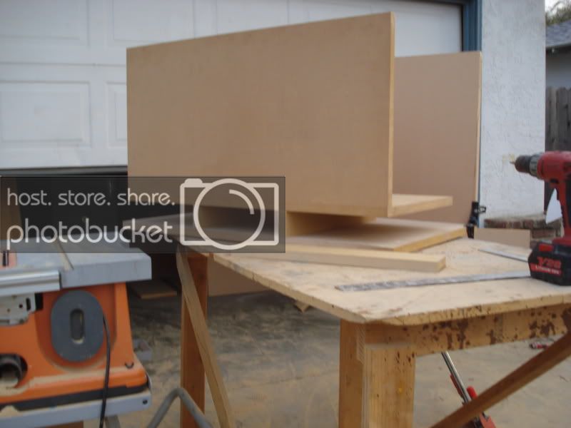

2. RD HW. 18z on RD.D9 [ enclosure ]
Savag3
sav'd out
1" MDF , 2" baffle , 5/8's thread rods.
11cu^ft displaced
120 sq^in divided slot : tuned @ 30.2
[woofers] : RD HeavyWieght v.GP 18"
going into a 99 grand cherokee.
first pic
thx . i always thought steve's ports were small , but i believe theyhave to be in the ballpark with the results. Here are the t.s tell me what you think ? thx.
10″ 12″ 15″ 18″
FS 42.4 HZ 44.7 HZ 39.4 HZ
RE 3.6 OHM 3.6 OHM 3.6 OHM
QMS 7.939 9.63 3.705
QES 0.3066 0.412 0.45
QTS 0.2952 0.395 0.4015
RMS 8.64 11.05 30.22
CMS 0.0547 MM/N 0.0334 MM/N 0.036 MM/N
MMS 257.4 G 378.26 G 451.4 G
BL 28.38 TM 32.14 TM 31.54 TM
SPL@1W 90.43 DB 91.83 DB 93.11 DB
VAS 23.64 L 37.83 L 80.35 L
XMAX 15 MM 15 MM 15 MM
XCOIL 55 MM 55 MM 55 MM
everything on the far right column i apologize for the paste.
Just eye-balling the t/s, it looks like ~5ft^3 with a ~33hz tuning should work well. I agree that Meade's ports are smaller than normal, smaller than what I'd use. I bet yours look smaller because you're using 1" MDF instead of the 3/4" that we're used to seeing.
Just eye-balling the t/s, it looks like ~5ft^3 with a 33-35hz tuning should work well. I agree that Meade's ports are smaller than normal, smaller than what I'd use. I bet yours look smaller because you're using 1" MDF instead of the 3/4" that we're used to seeing.
ok . thx i was actualy refering to the 'weaseL of the Year ' previous owner of RD . SteveMiLLer.
thank you for looking at the t.s i need to learn to read them correctly.
