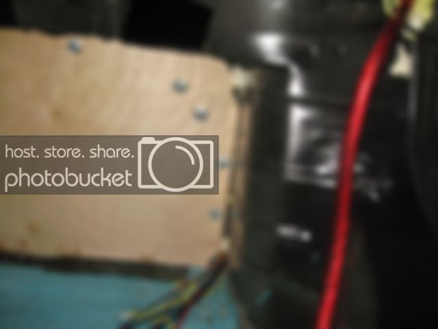

Looks very similar to mine:
As long as you get a good seal, you're good to go.
I suggest you go IB. More efficient, less weight, more trunk space, sounds great, and killer lows.
