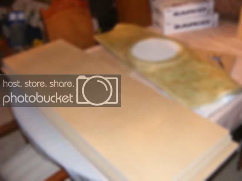

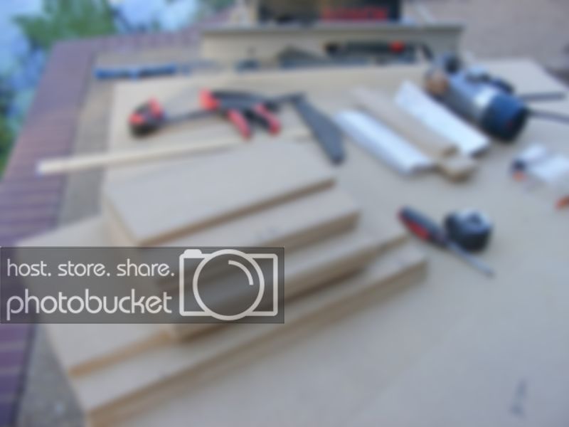

Had two boxes i was planning on doing today, got a little too drunk last night so i didnt get started till like 3 so i did not get as much done as i would like
first one is a 1.95 before placement box for a 12w3 tuned to 32hz
All the wood cut, ports rounded and endcaps rabbeted

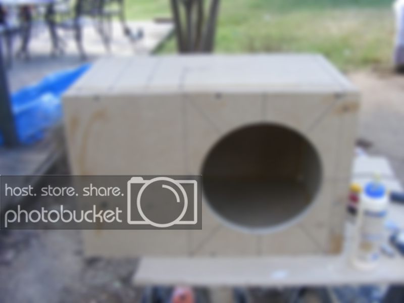

Got some of it put together but ran outa light

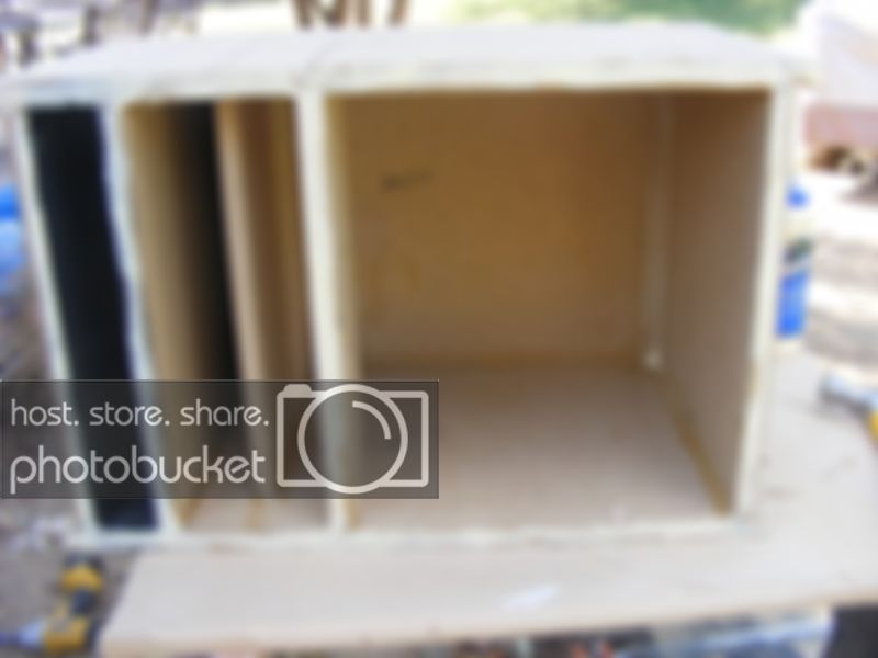

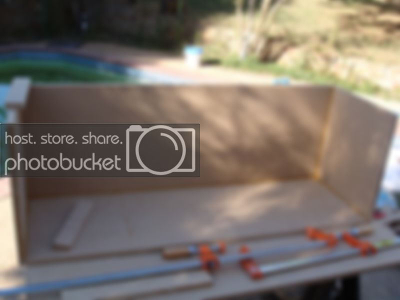

All assembled except for the top, thats glue over all the joints

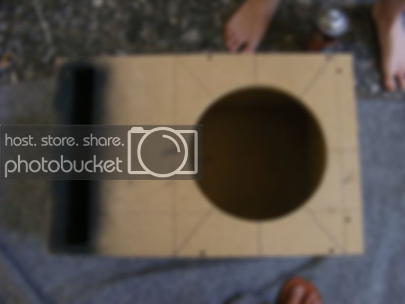

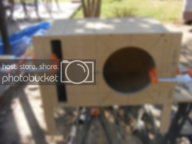

Baffle is on

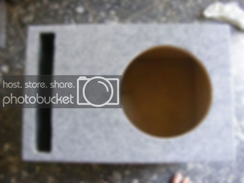

port cut, i love my flushtrim
Somehow the top baffle was about about 1/64 of an inch, some people might have just said fvck it but not i, i use a bosch planer, the wood clamped on the side is so when the planer comes to the end it does not take chunks out of the edge of the wood

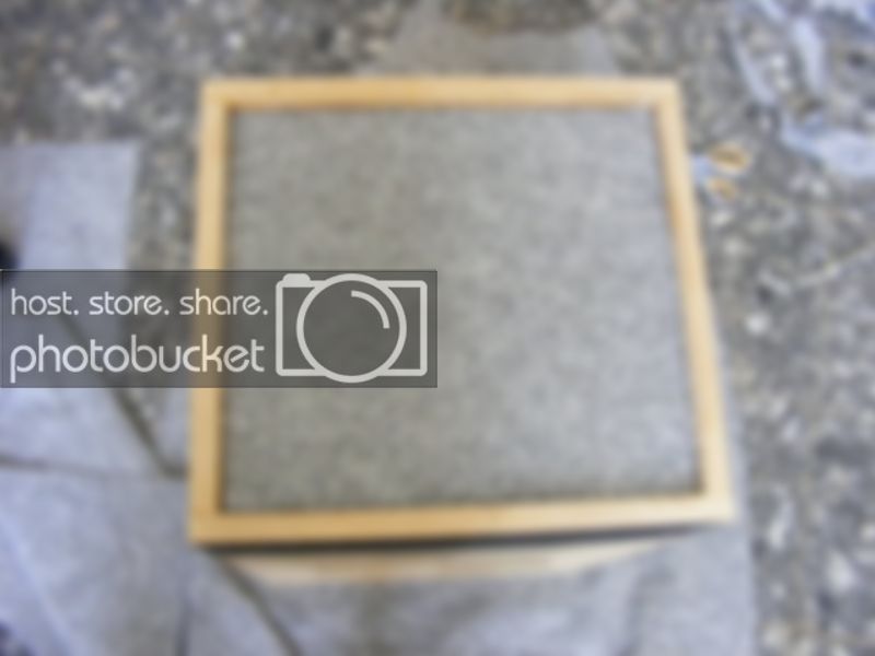

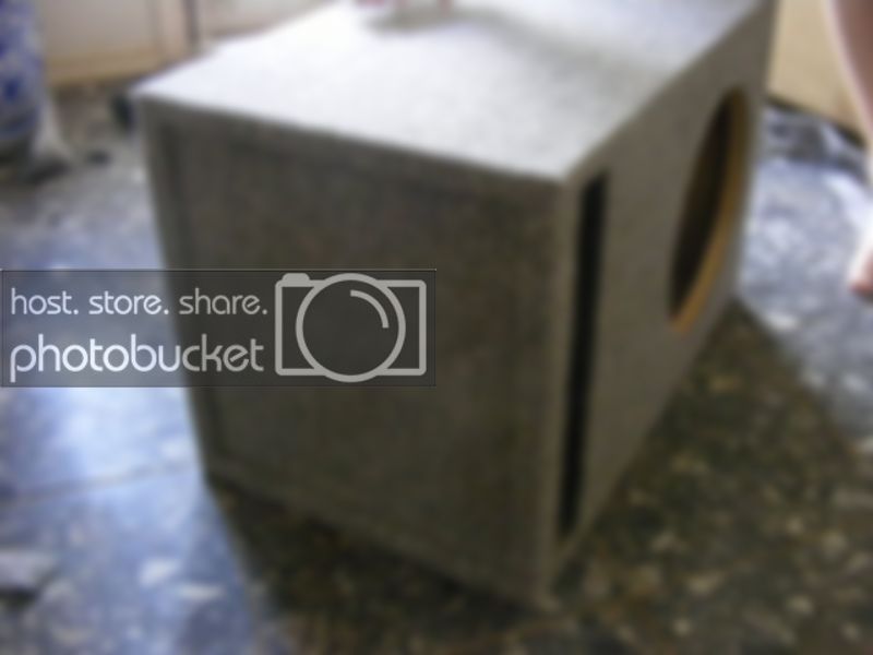

sides carpteted
and done

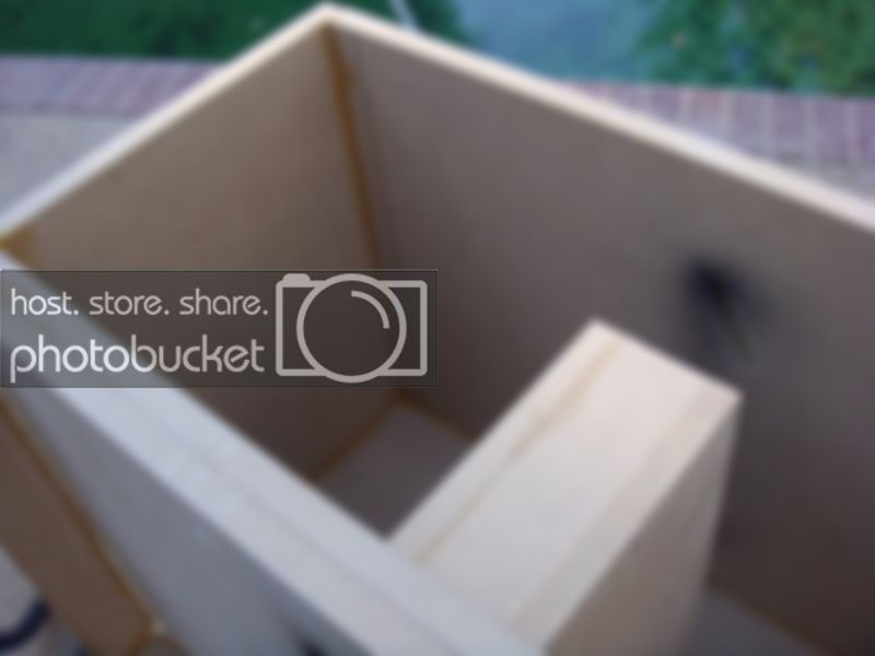

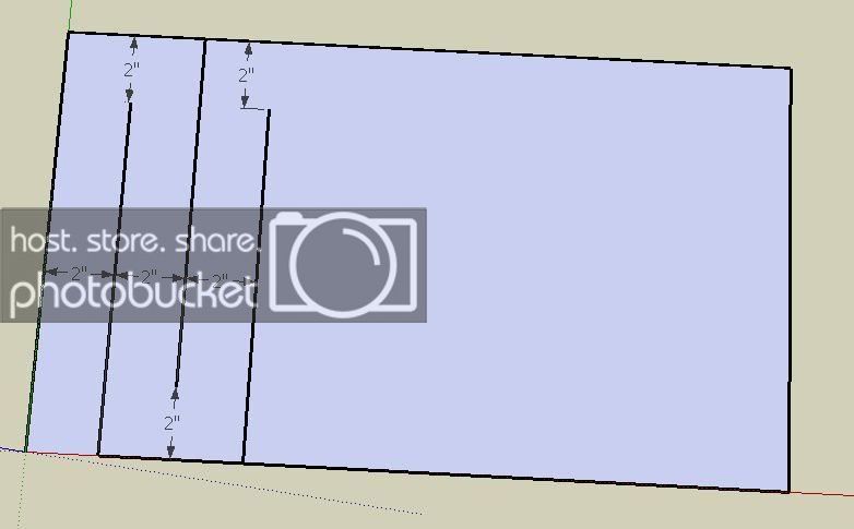

Fierce, I don't mean to bother you, but what's the rule for the winding port like that?
Is the end the same size as the port?
Let's put my ASCII skillz to work:
____________
| A | | |
| | | | | C |
|A| A| | A ___|
Like that?
(Where A is port diameter and C = Chamber)

Fierce, I don't mean to bother you, but what's the rule for the winding port like that?Is the end the same size as the port?
____________
| A | | |
| | | | | C |
|A| A| | A ___|
Like that?

Sorry im kinda confused by the question.
Can you explain more?
^Looks right to me //content.invisioncic.com/y282845/emoticons/smile.gif.1ebc41e1811405b213edfc4622c41e27.gif And then just measure the port length by always staying in the middle of the port the whole way
:nod:
Yeah, I know that. Still trying to get this whole 'port thing' down to a science.
I've been making Programs to do the math for me.

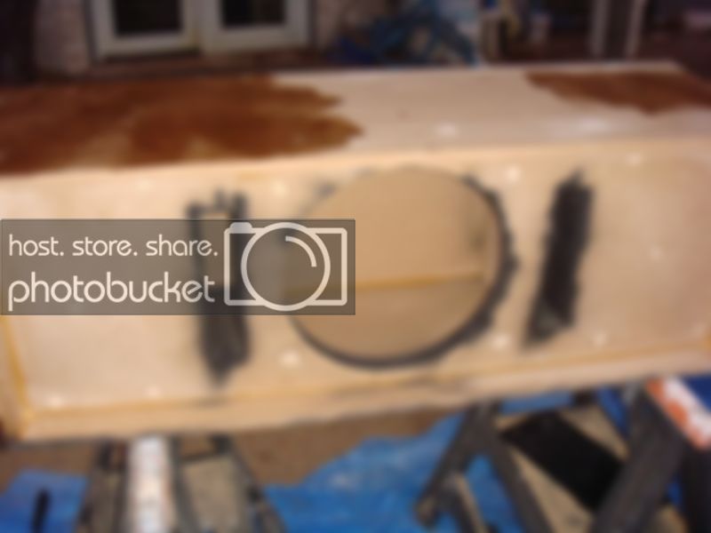

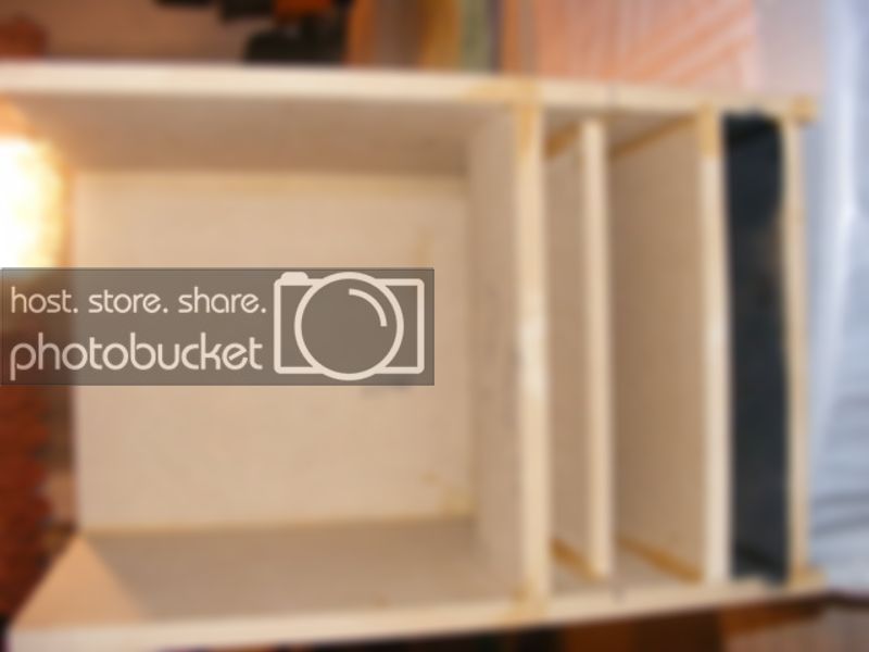

didnt get alot pics of this one but

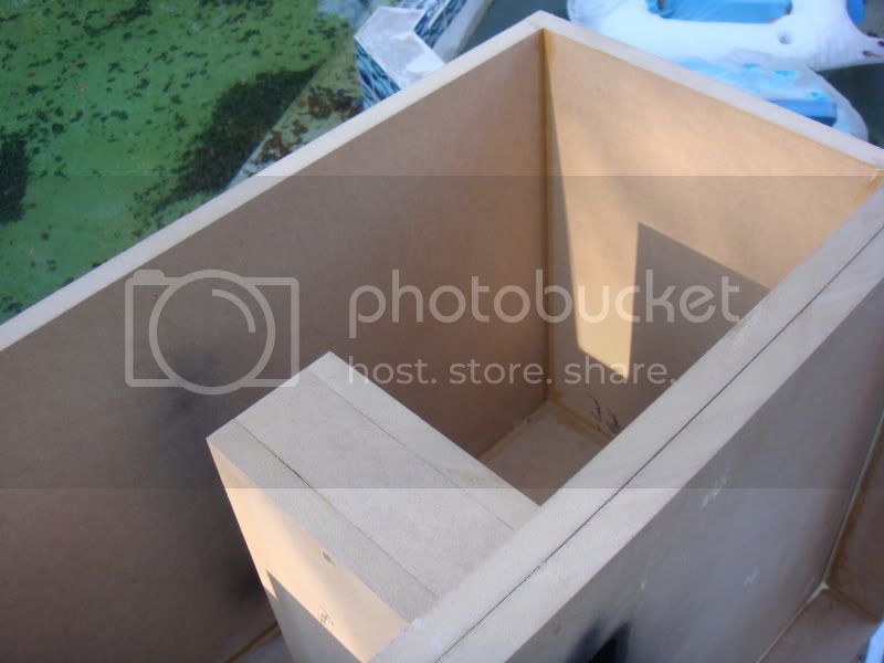

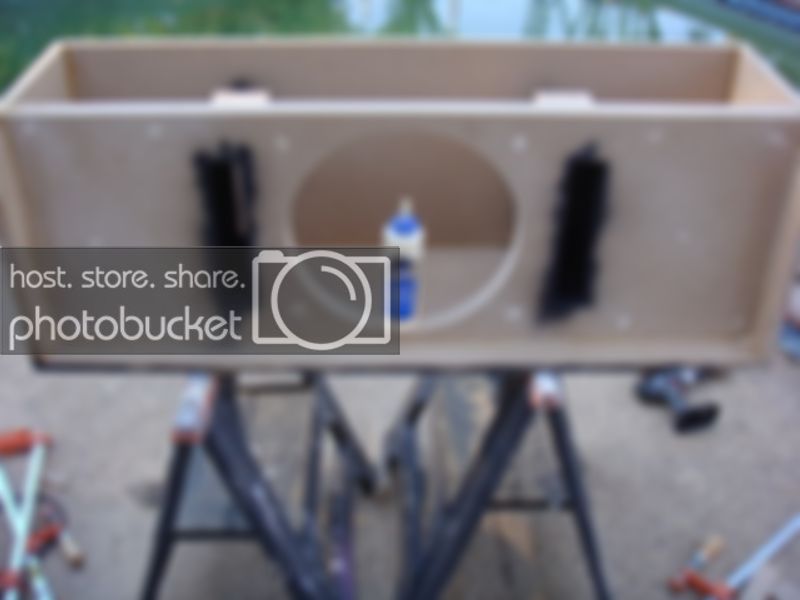

baffles on
double baffled

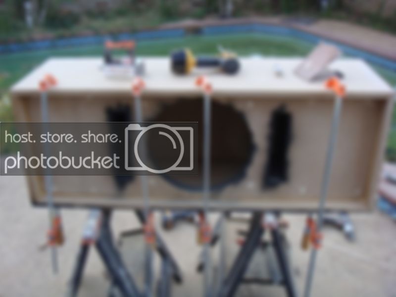

top on
and done, i was going to bedliner it, thats what the stain looking stuff is but the guy brought me the wrong stuff so he said hed finish it at another date. I doubt it but whatever
