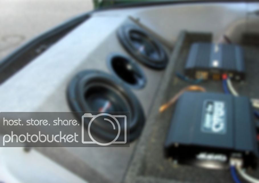

id like to tune to 32. I can get up to about 2 which should be great according to dc autotronics. Aero ports if the port is 4 inch abs if its 3 inch. All I need is an exact volume and port size. Its for a 95 camaro and I know no one will touch the actual design. This is a pic of my current box. Its 2.6 at 32 and it just doesnt sound right.
****. That's a nice setup. How you do you have that port done? You have an elbow on it?
What doesn't "sound right" about this box?
I dunno. Its not super loud and its sounds like the subs unload at low frequencies even though I have my subsonic set at like 25. BTW the matts has been sold so I could fix my computer. I got a few cheap ab100.1s to strap on these subs.
The port didn't need a bend. Its only like 12 or 13 inches long or something and the box is almost 18 inches deep. Its an aeroport but I didn't have a center section so I ground out enough material to fit the flares in the ends. I used the psp calculator to get my port length.
I dunno. Its not loud and its sounds like the subs unload at low frequencies even though I have my subsonic set at like 25. BTW the matts has been sold so I could fix my computer. I got a few cheap ab100.1s to strap on these subs.
Hmm... Just running the numbers, you might be tuned too low for those subs. They prefer a mid-high 30's tune. Easist thing might be to just cut a few inches off of the port.
And "cheap?" shiiiit. Those AB's are beastly little amps.
I think those subs need to be loading off something like firing up more towards the window instead of in a perfect able with it.
Kinda what I was thinking. The original plan was to get as much space as possible. Then I built the box and got almost 4 cubes. I was like holy ****.

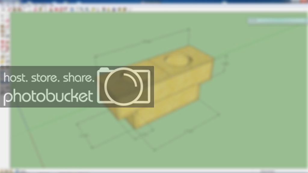

Im stuck on my design. The new plan has like 2.218 after subs. I cant seen to get enough port area. I want to tune to 36 but without ungodly long tubes with bends.
