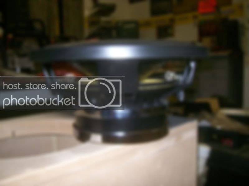

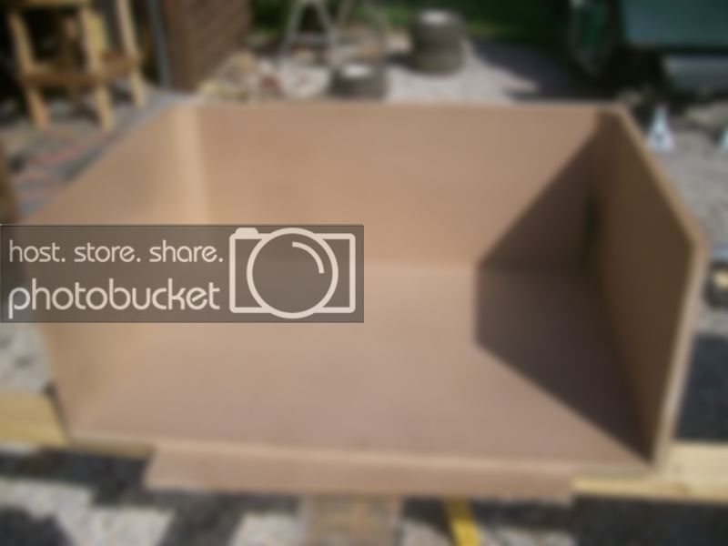

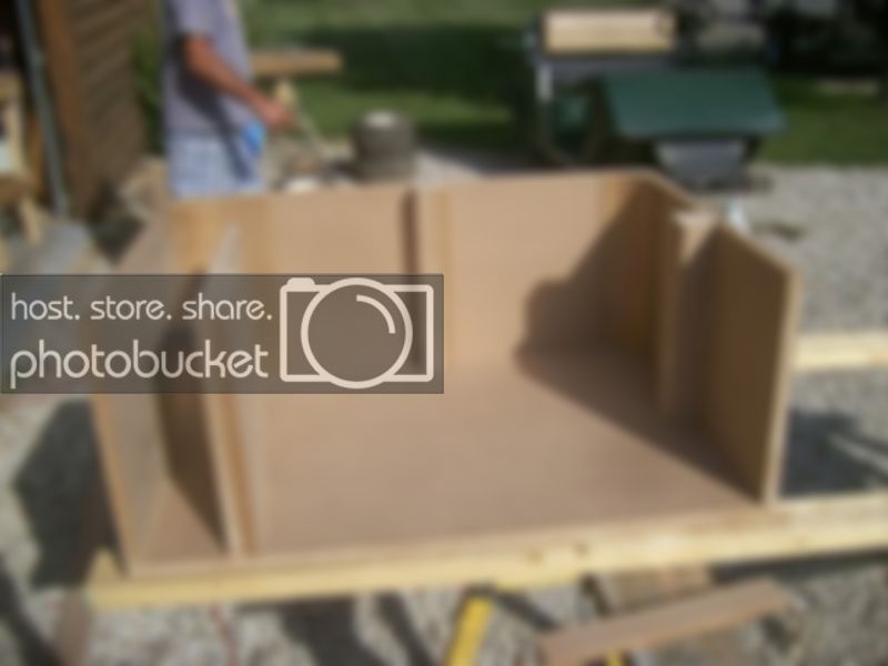

This customer came to me after the shop i work at was wanting to charge him way to much for silly stuff haha. He bought the 2 TREO SSi's from the shop. They are rated for around 750rms but ive seen a pair of 15's take 3k all day. The RF t2000bd was acually my friends that he sold him along with the stinger batt. The wiring is all KNU. the car was somewhat of a challange becasue its all sealed from the cabin. the gas tank is acually right behind the seat, but on the upside the trunk opening is HUGE. so here we go.

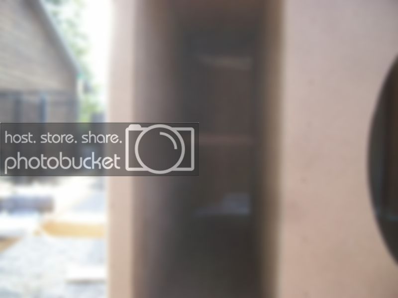

Radius corners with sonotube.

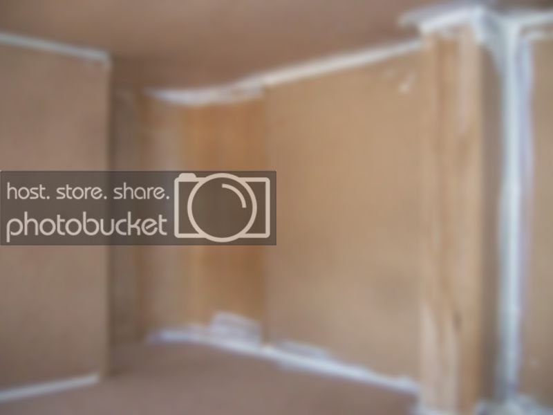

lotts of bracing haha these things like to moveeeee

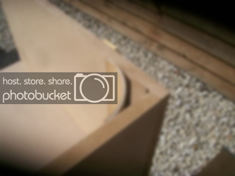

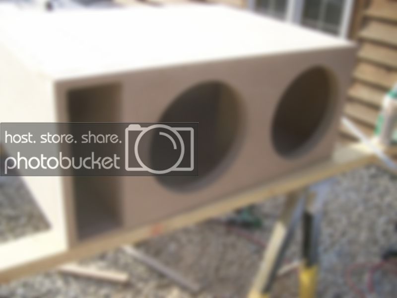

around 5 cubes after disp. i tuned it to to around 28hz becasue the subs tend to be very peeky when in a box tuned in the 34 range. WIN ISD is a big help in finding that out before you do it the hard way haha i had to add a couple inches.... original tuning was 31.

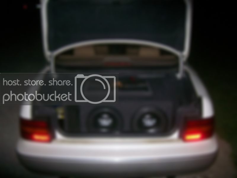

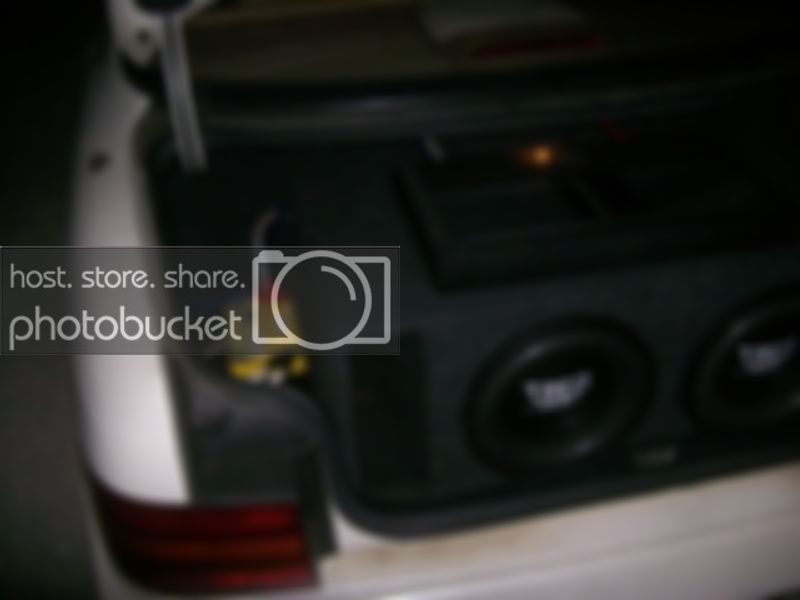

me and rob acually took the rear deck out and removed the factory sub and packing to give it as much transfer as possible. lol thanks to him on the 2 hour wire pull haha
That lexus probably has a good bit of factory sound deadening but it will depend on how loud this set-up is to tell if there's a lot of rattle or not.
haha x2..... sealed trunk with a gas tank blocking everthing. took liek an hour to get the 1/0 through. we did almost the same set up here at the shop with a treo ssx1400.1 and it was loud as shit in a normal-trunk car
