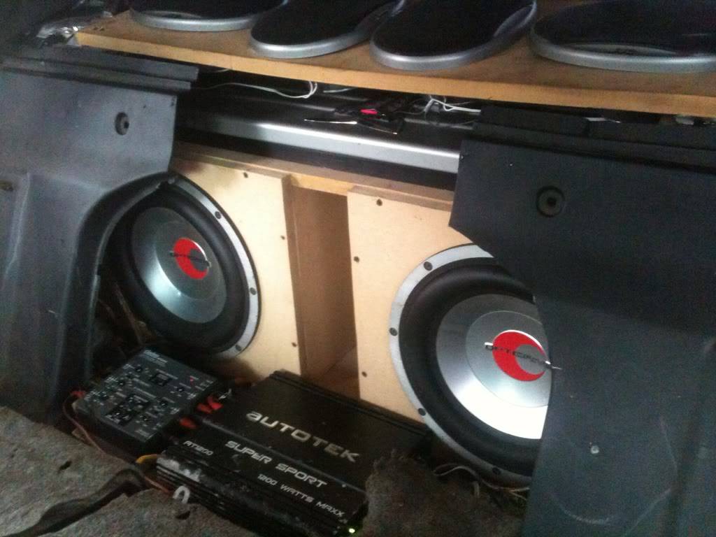

This is a picture of the area i'm going to be working with:
... It's 32" Wide [from Strut mount to Strut mount] - I can go 18" High [maybe 20" if I push the board up] - I can go 30" Deep, but I'm just gonna leave it at 20"

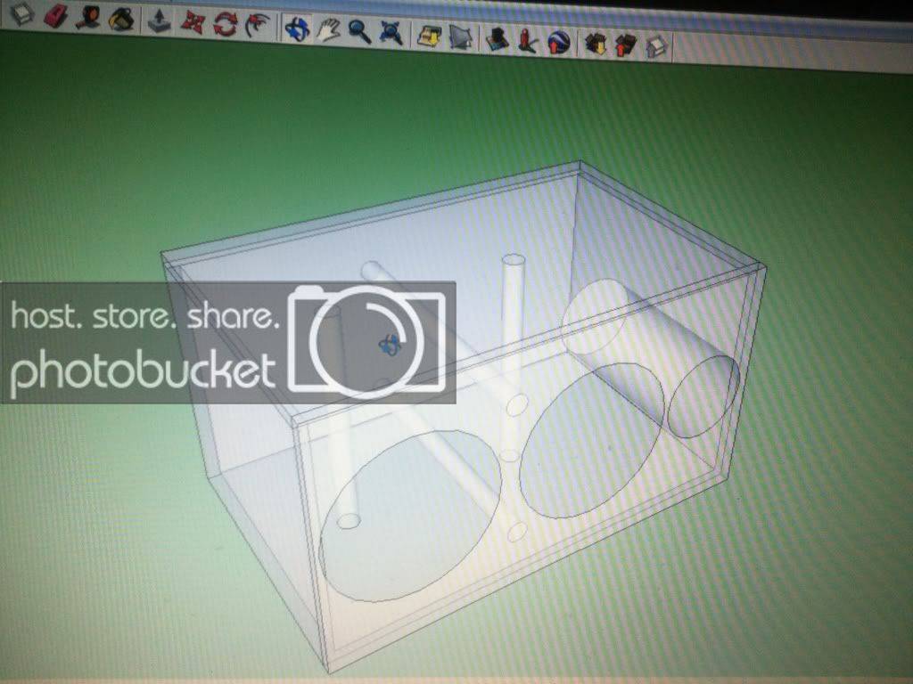

This is a design I came up with... But it looks like I'm going to have some spacing problems...
... The holes are the Cut out diameter... Not the full size of the sub[but subs together are going to take up 25"] I only have 32" to work with... The Aero is gonna take up 6.25"...
... I'm stuck on what could be done... So if a box builder is willing to help... It would be greatly appreciated...
Suggestions, Advice, Thoughts, ANYTHING is welcome...
I though about that... [ Moving the port on the top corner ]
... I wasn't sure if it would effect anything..
That's too much space for the Skars? [ Is that 1.7cuft each? - I hope so.. ]
