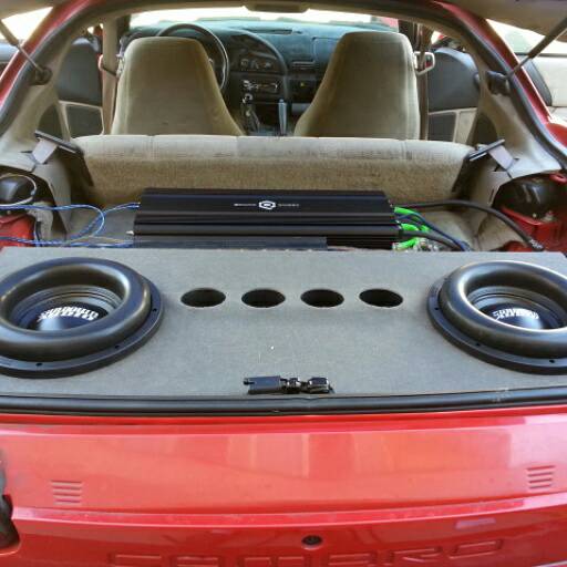

CSCStang Enclosurist 2,994 1 OC, Ca Nov 2, 2016 #2 I built one to fit down in the rear cubby that netted 3 cubes, enough for 2 10s. Ran 4 3" aeros. Housed Sundown x10s Sent from my SCH-I605 using Tapatalk

OP C ConwayCarAudio Junior Member 4 0 Conway Nov 2, 2016 Thread Starter #5 How long was each aero port?
CSCStang Enclosurist 2,994 1 OC, Ca Nov 2, 2016 #6 How long was each aero port? Click to expand... 20" length. Tuned to 32hz. I'll have to look through my notes and see if I have dimensions. Sent from my SCH-I605 using Tapatalk
