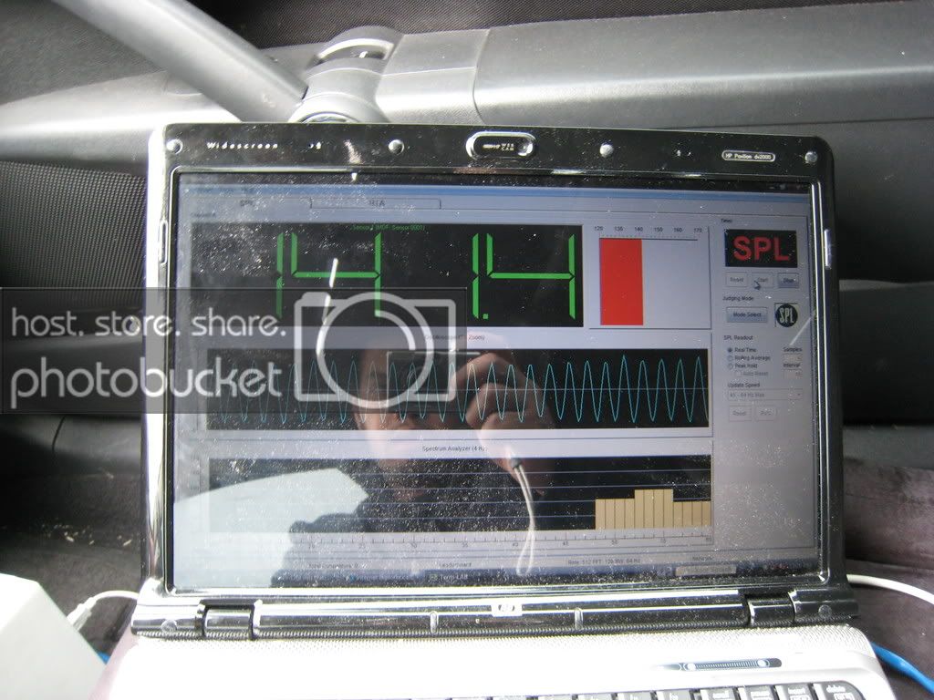

Its powered by a Sundown SAZ1500. Not to bad for music score, next time I will have the correct test tone. I only had up to 45hz. I need something in the 50s
Bigger speaker wires may even bump that up a tad.//content.invisioncic.com/y282845/emoticons/wink.gif.608e3ea05f1a9f98611af0861652f8fb.gif
every little thing helps. I would find your peak, then find some similar music to meter with.

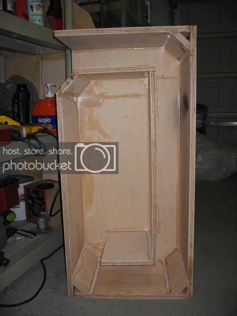

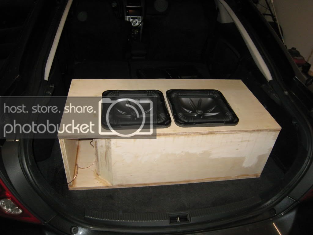

TTB means it was designed by Pete Kulicki.
That a decent score... You could be alot louder with a box that isnt 50% port.... Thats the thing with his boxes, the port is always crazy long.
Much, much, much more could be had out of that setup. 145's wouldn't be out of the question, while still being able to play music.
I'm not a big fan of that big long port or horn or t-line or whatever the hell TTB wants to call it.
Did that thing peak at 55 hz?
How would you change it? That box overall is 35x14x12. Yeah it peaked pretty high.
