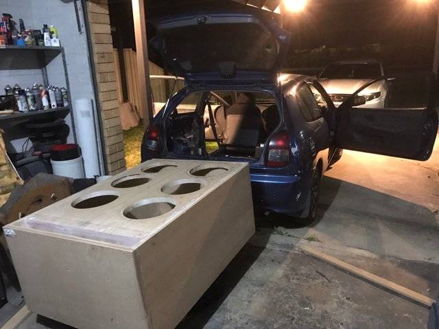

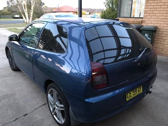

Hey guys! Got a 1999 Mitsubishi Mirage hatch from a mate for free so decided to see what damage I could do in the bass department [emoji16]

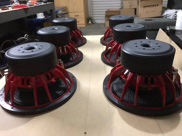

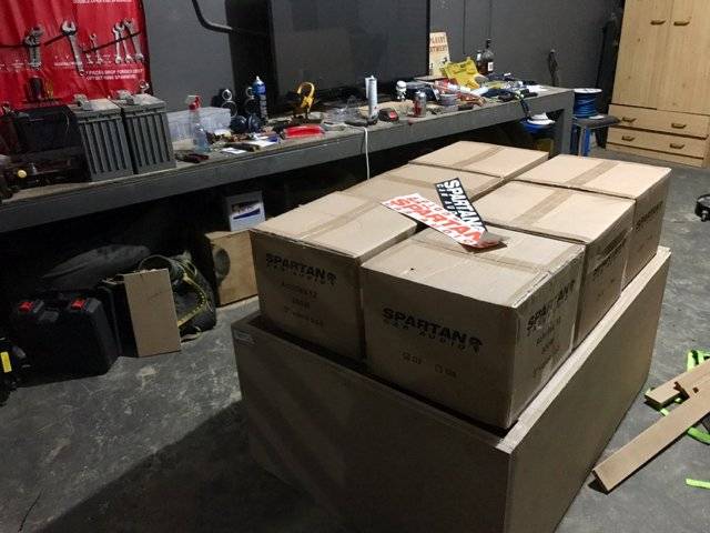

6x 12" Spartan Subs
2x DS18 8" Mids
2x Digital Designs B2 Tweeters
1x Soundigital 8K mono
2x Shark 100.4 4 channels

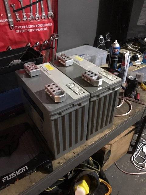

2x extra Batteries (3 total)

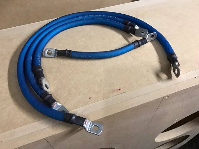

0ga runs + fuses

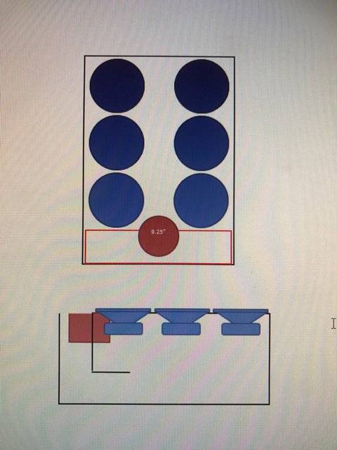

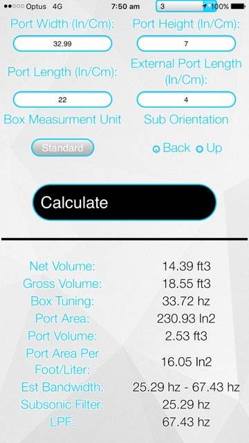

Box size: 18.55cube
Slot Port Tuned to 34Hz (without the external port attachment)
Hope you guys enjoy the build! It's purpose is a general demo car for some fun [emoji16] any advice would be great to help hammer some low bass! [emoji1305]

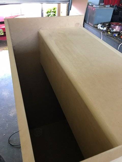

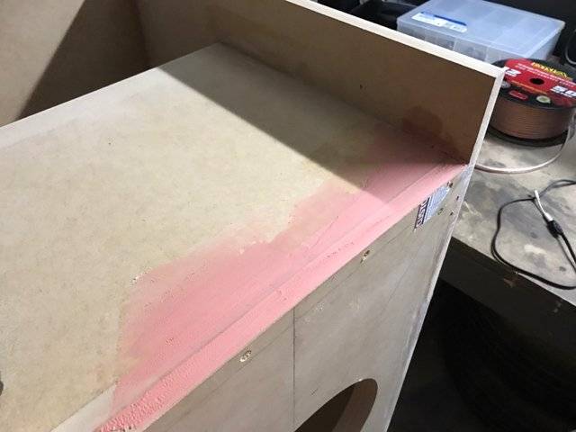

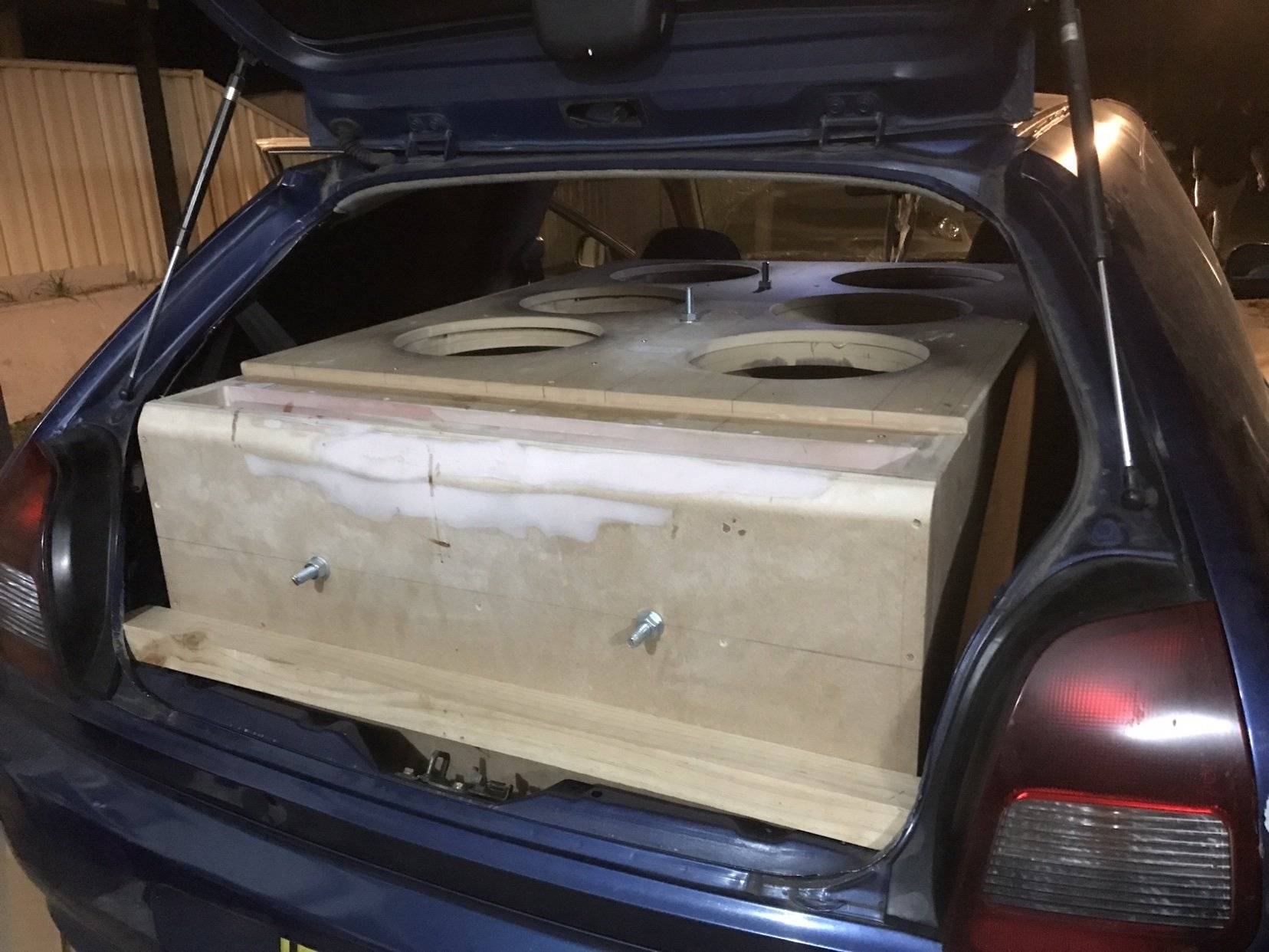

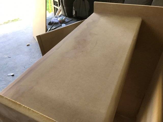

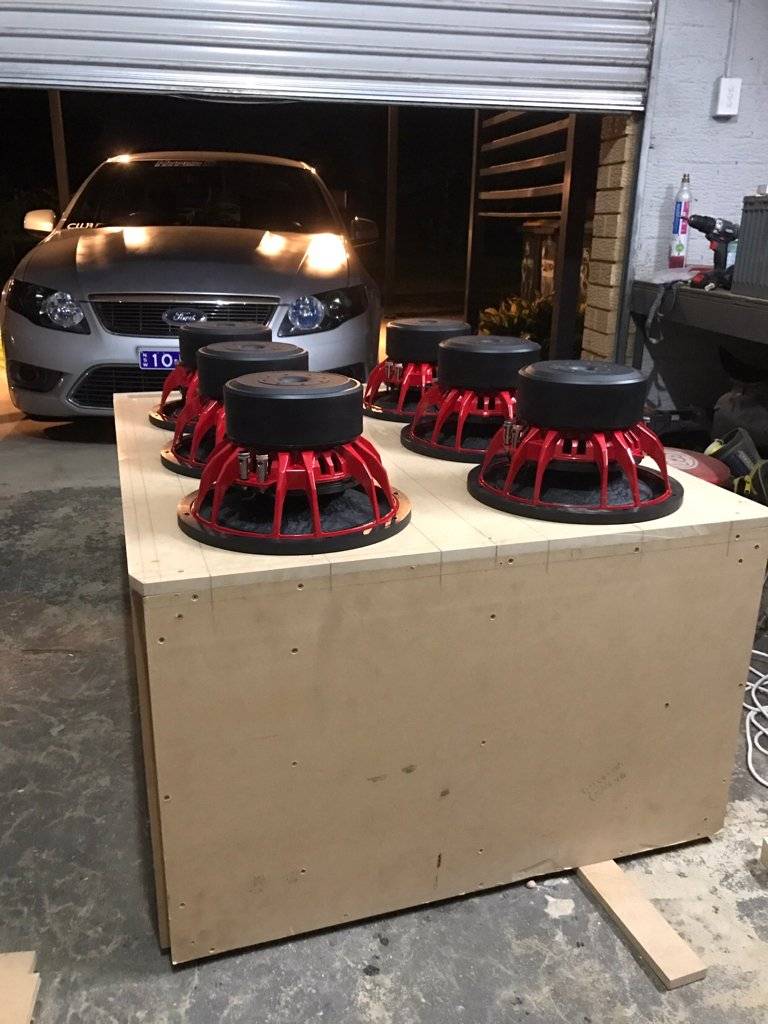

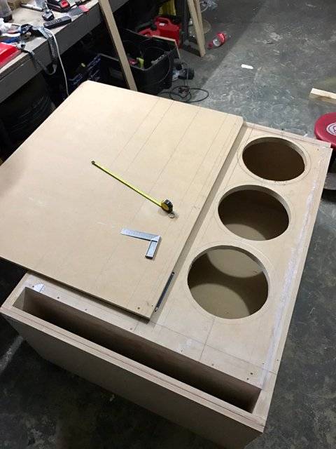

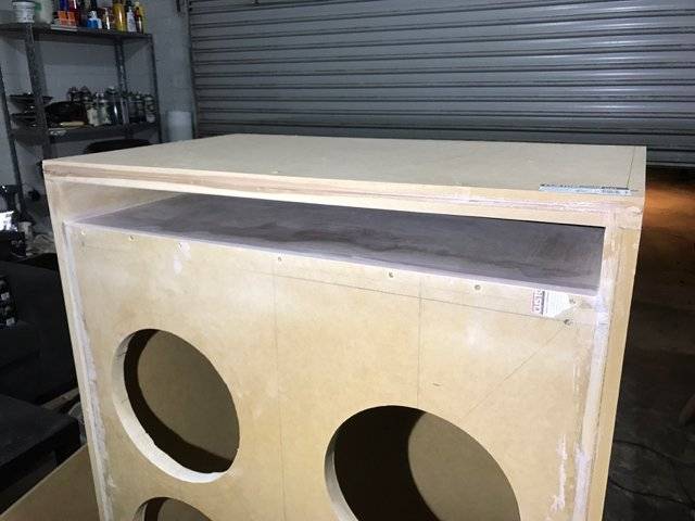

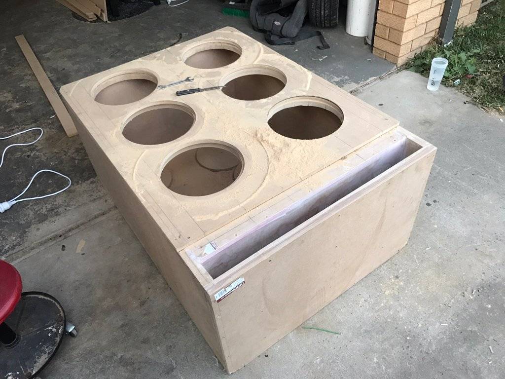

The final baffle cut and smoothed out
Port area looks......weird. looks like it's not enough but when the port opening is small, then goes and hits that bend, it opens up. Why is that?
The external port attachment hasn't been fitted in yet so it doesn't line up with the top baffle, hence the gap you see lol
