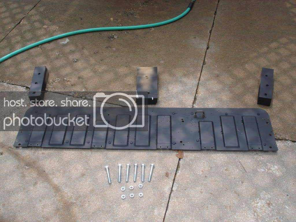

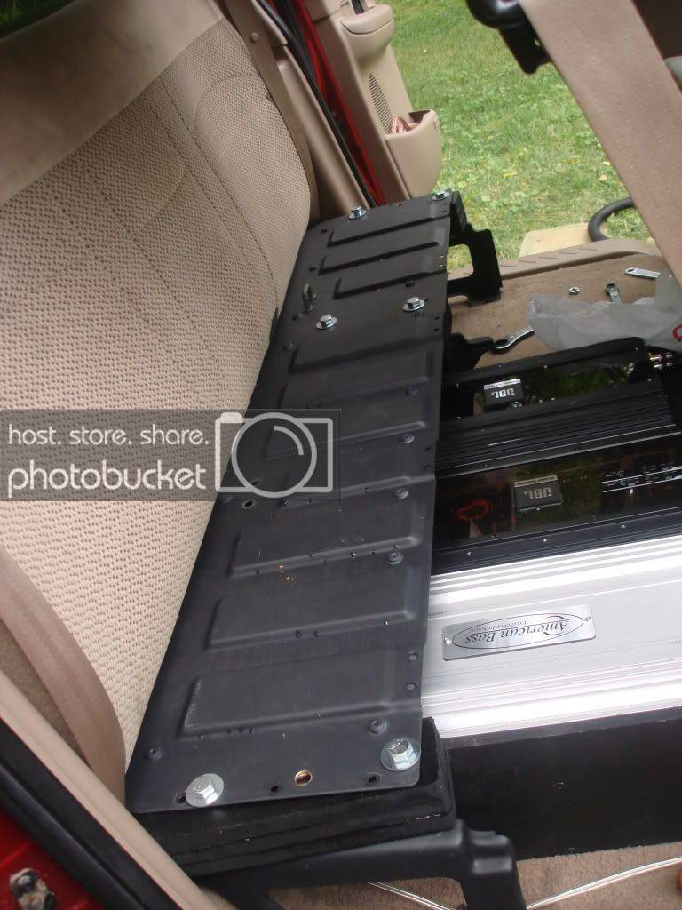

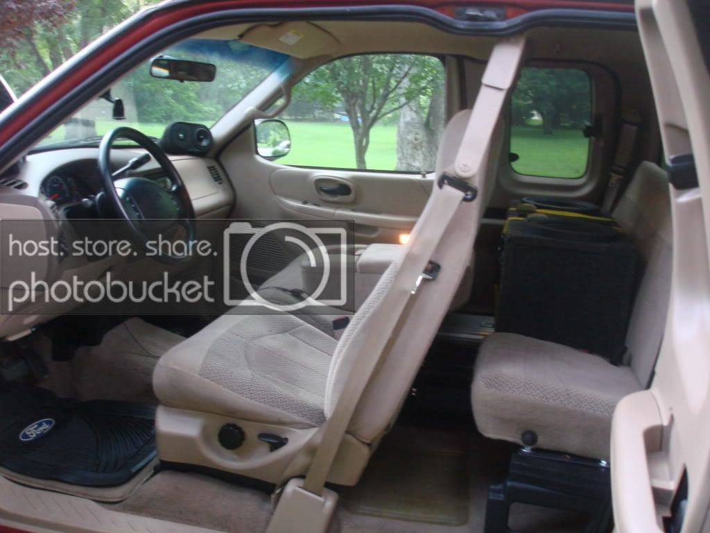

Today I wrapped up the seat lift. I didn't want to pay $130 for a kit, so I made my own. Cost me about $12, plus $20 for a 1/2 inch drill bit. It's extremely secure and doesn't sway at all. I made a new thread in case anyone is interested in doing this themselves: http://www.caraudio.com/forum/showthread.php?p=6481837#post6481837

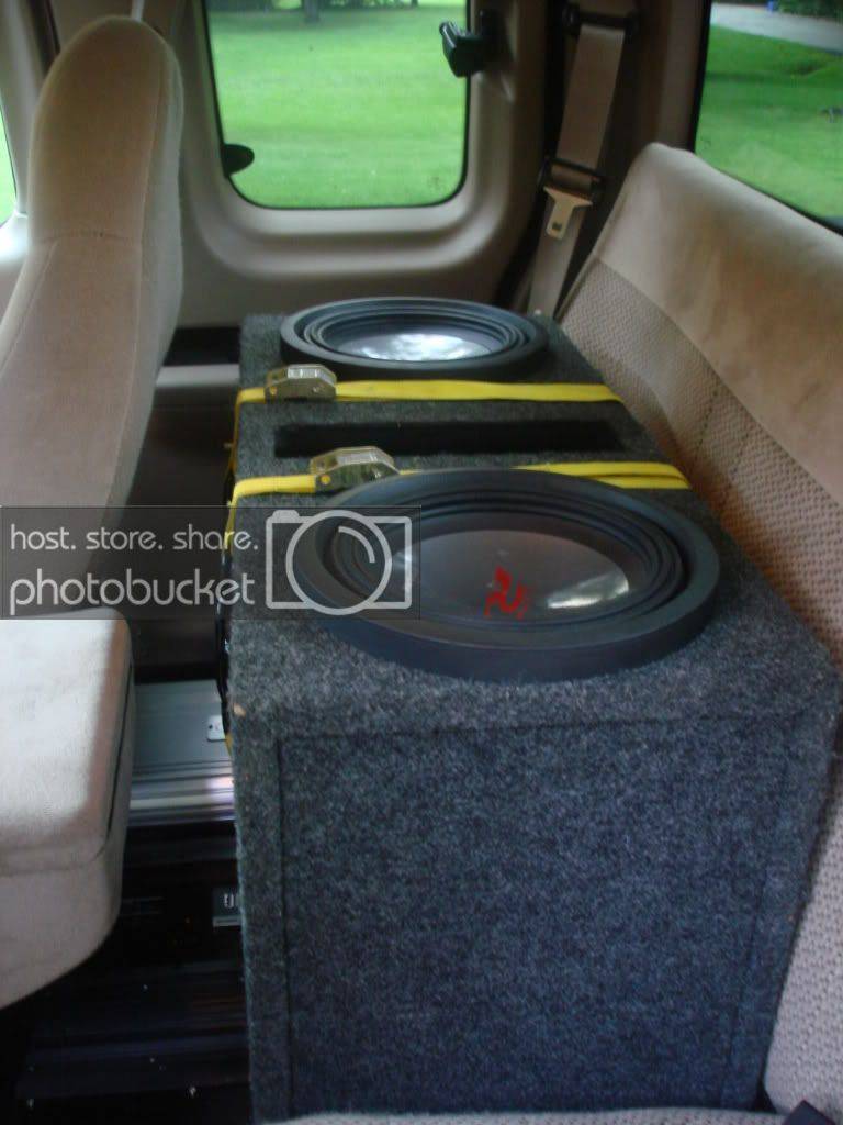

The other day I got pair of 10" Alpine Type R's for $20, so I threw them in a box I had lying around and secured it to the seat. They're running off a single American Bass XD-2000 at the moment. I was pretty surprised at their output! Not the best sounding woofers in the world, but they'll be fine for the next few months.
So my install is finally wrapped up for the time being, and I'm glad I don't have half a ton of crap in my cab. //content.invisioncic.com/y282845/emoticons/biggrin.gif.d71a5d36fcbab170f2364c9f2e3946cb.gif:D:D
