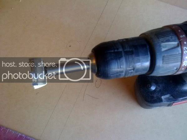

OP info 10+ year member Senior VIP Member 195 2 Evansville Indiana Sep 6, 2010 Thread Starter #21 Ok photo bucket back on line 1 1/4 forstner drill bit

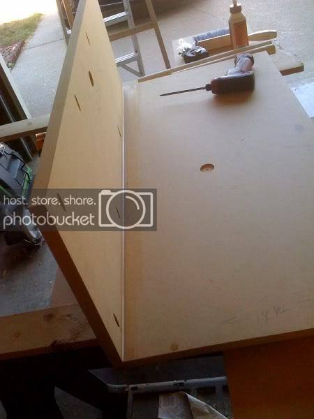

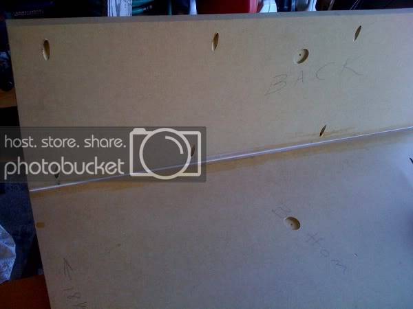

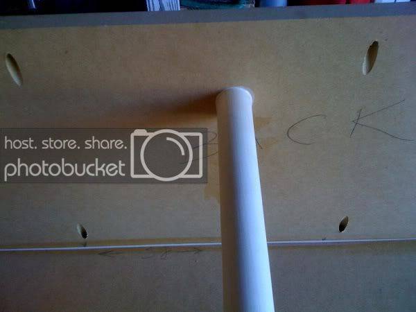

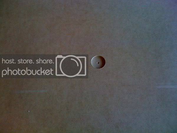

OP info 10+ year member Senior VIP Member 195 2 Evansville Indiana Sep 6, 2010 Thread Starter #22 I started with front panel and back panel . I sandwich the panels together . I Located where i was going to brace ( 1 1/4 dowell rod) I drilled 1/16 bit thru both panels. Now , I know where to use 1 1/4 forstner drill bit I then counter sinked 1/4",, 1 1/4 hole diameter hole in front and back panels . The holes should be perfect in line for assmble I also did the same for the top panel and bottm panel

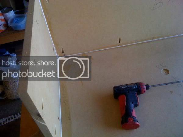

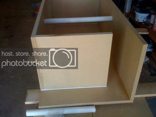

OP info 10+ year member Senior VIP Member 195 2 Evansville Indiana Sep 6, 2010 Thread Starter #24 Starting to assemble the back panel

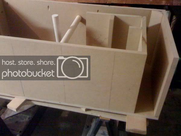

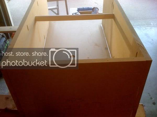

OP info 10+ year member Senior VIP Member 195 2 Evansville Indiana Sep 6, 2010 Thread Starter #26 side panel As you can see bottom panel 1 1/4 counter sink hole for the dowell rod

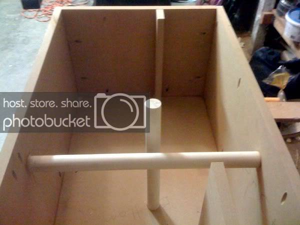

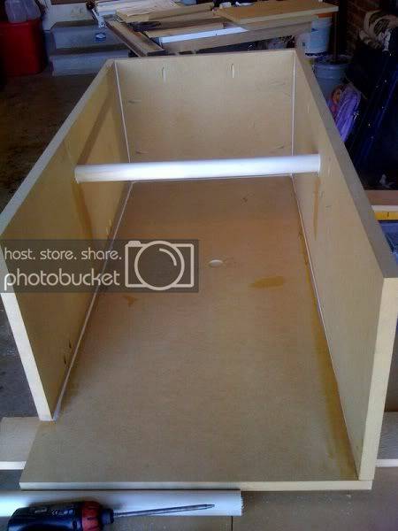

OP info 10+ year member Senior VIP Member 195 2 Evansville Indiana Sep 6, 2010 Thread Starter #27 front panel and 1 1/4 dowell rod support i still gota cut the 4 -8" holes for the subs .Waiting for them to arrive

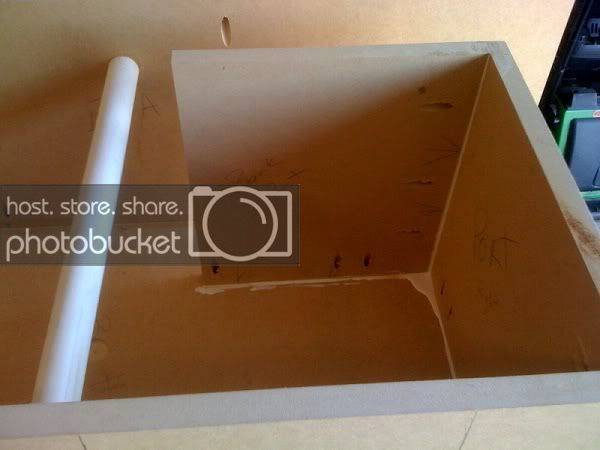

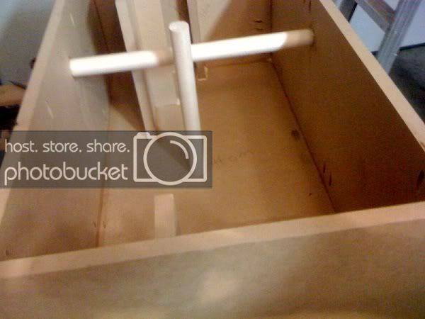

OP info 10+ year member Senior VIP Member 195 2 Evansville Indiana Sep 6, 2010 Thread Starter #28 working on the port opening I got kind of crazy with the glue on this one .LOL

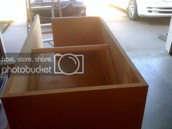

OP info 10+ year member Senior VIP Member 195 2 Evansville Indiana Sep 6, 2010 Thread Starter #29 more to come later
