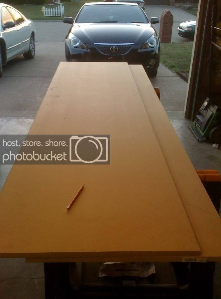

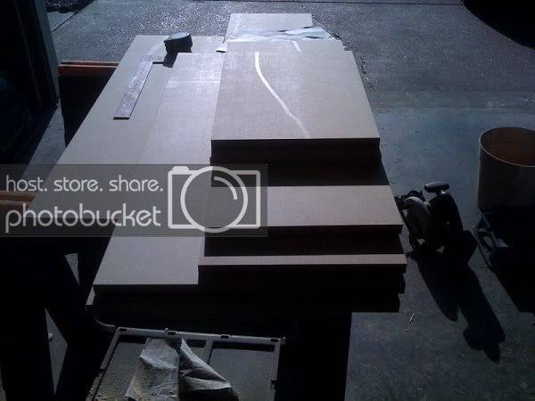

1.. 1 sheet mdf 4x8x3/4 ( Lowes )

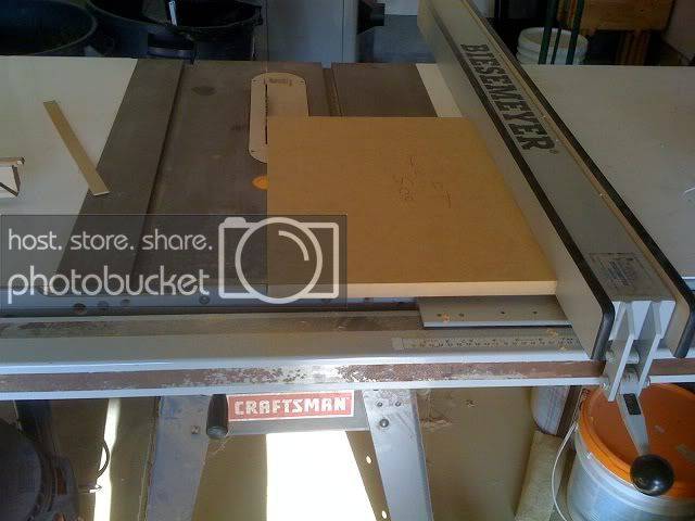

1st. cut . I rip 4x8 in half with table saw , for easy handling

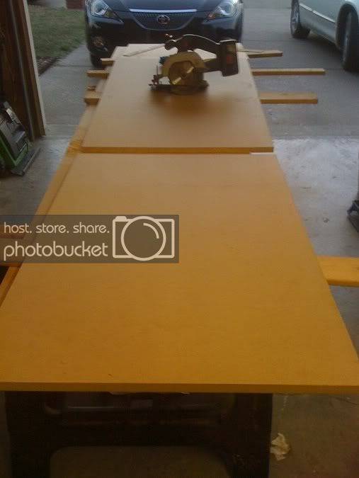

2-2x8 sheets

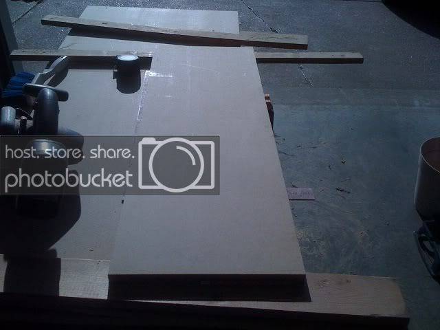

2. Cut top & bottom section ( Rough cut with cordless saw) .
3. Now , I cut top & bottom panel to right dimensions with table saw

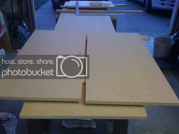

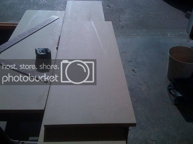

Well ,i finsihed cutting all the panels tonight . Looks like everything is fallen into place . This weekend I will start the assembly .Will take more pictures on the assembly .

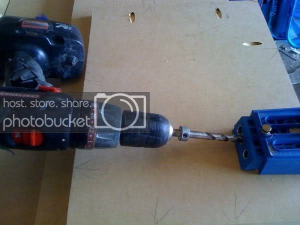

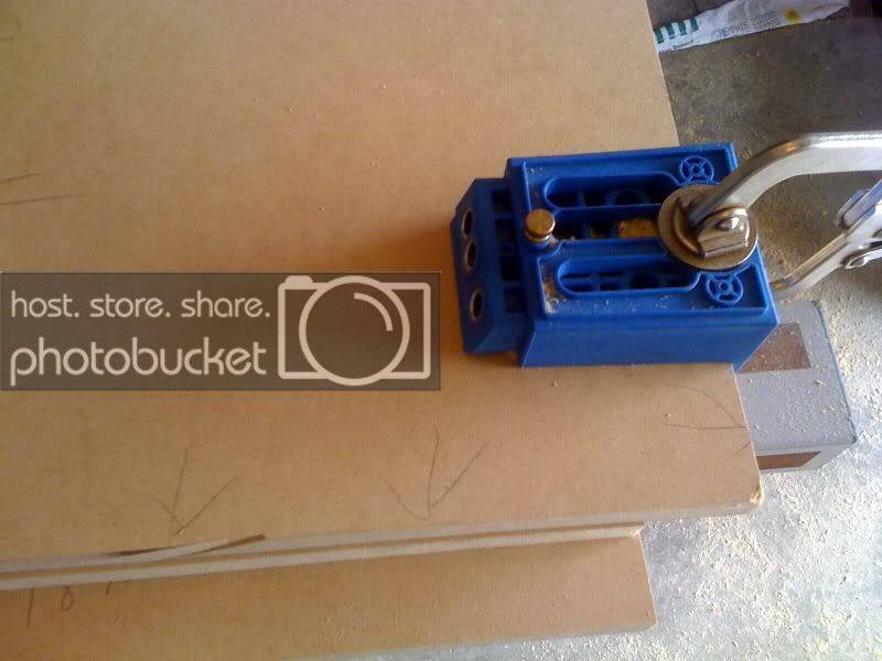

Well, This eveing I start my perp work by using the kreg joint ( I love this tool )

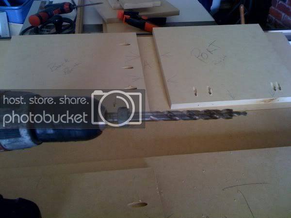

Here is what one panel looks like after using the kreg joint
From start to end process
