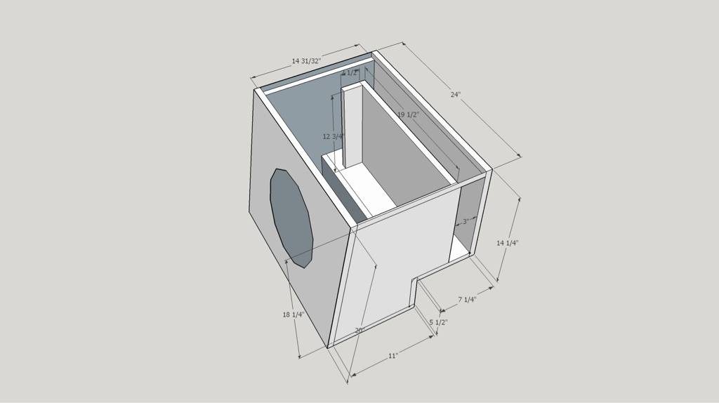

I've been talking about getting a Sundown Audio sub for quite some time but haven't been down to the states to pick one up. My buddy is going with his mom to Seattle and is going to go get one. Of course it has to be when money is tight for me so I can't afford one (or two //content.invisioncic.com/y282845/emoticons/smile.gif.1ebc41e1811405b213edfc4622c41e27.gif). Anyways, he doesn't have the time to make a box that will properly fit in his little ford ranger, so he has asked me to build one for him. Of course I'll do it!
I've come up with a ~3.5 cu ft box that is tuned to about 32-33 Hz that should fit behind the passenger seat.
Any knowledge of similar builds, tips and/or tricks for a successful install would be appreciated //content.invisioncic.com/y282845/emoticons/smile.gif.1ebc41e1811405b213edfc4622c41e27.gif

If his is a single cab then we have the same truck, he's gonna lose a lot of legroom there. Also, just by what you said without looking at the measurements, the box is a little too big. Try between 2.8 or 3.2, depending on port displacement.
