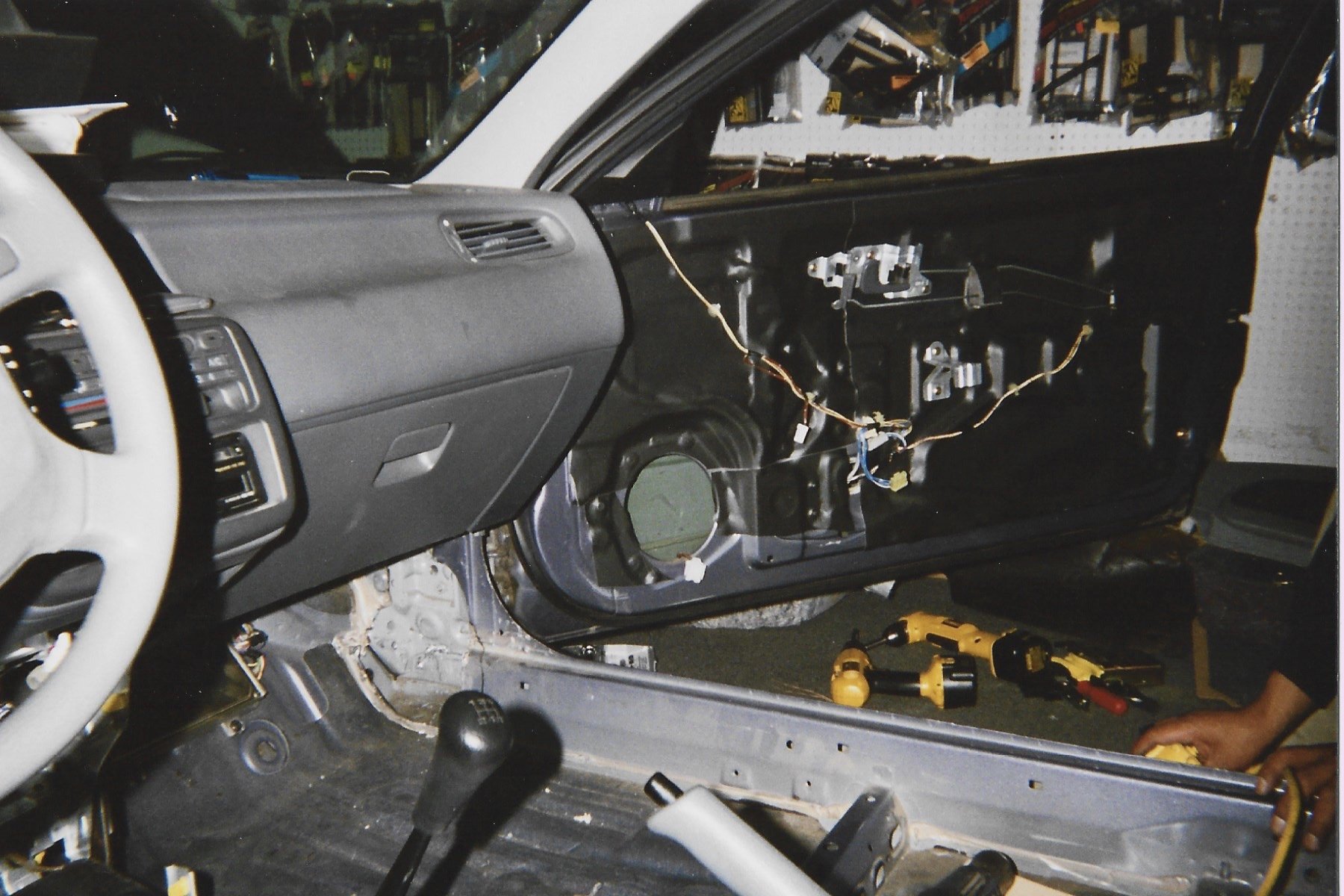

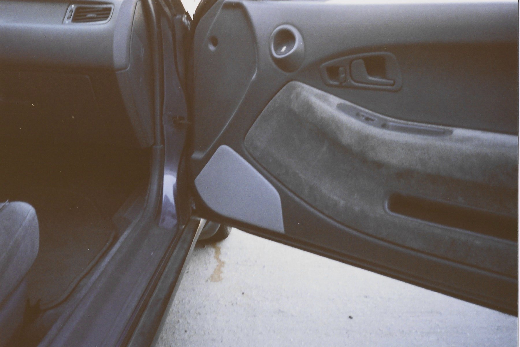

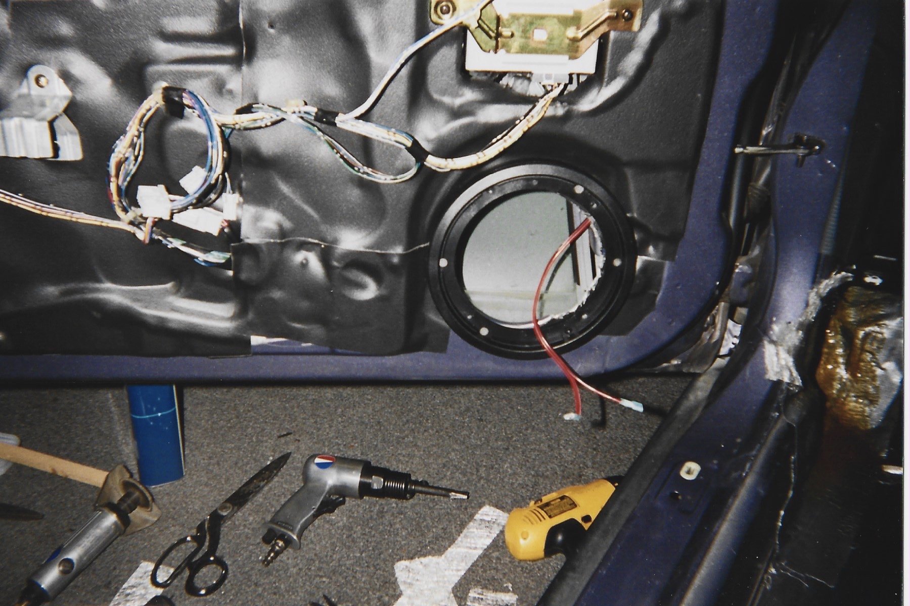

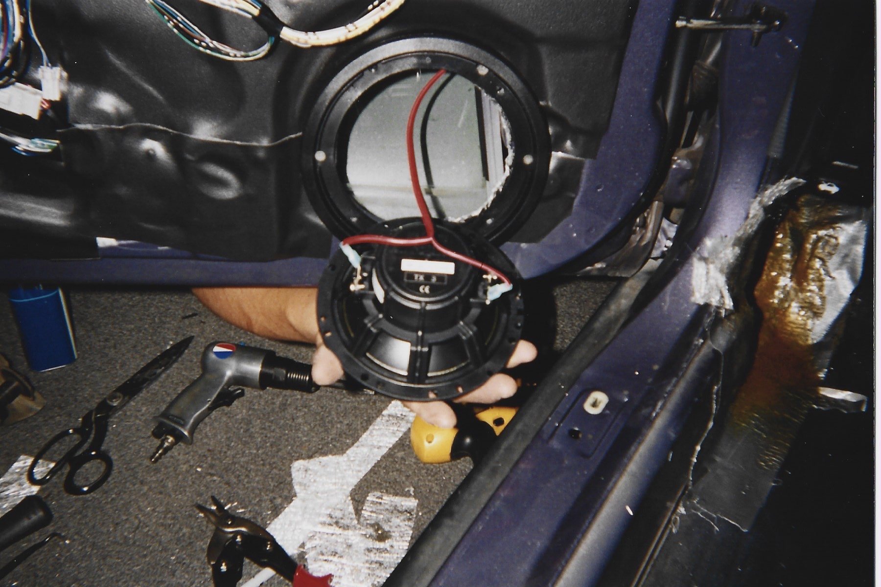

Painted grey to not show through the grill cloth

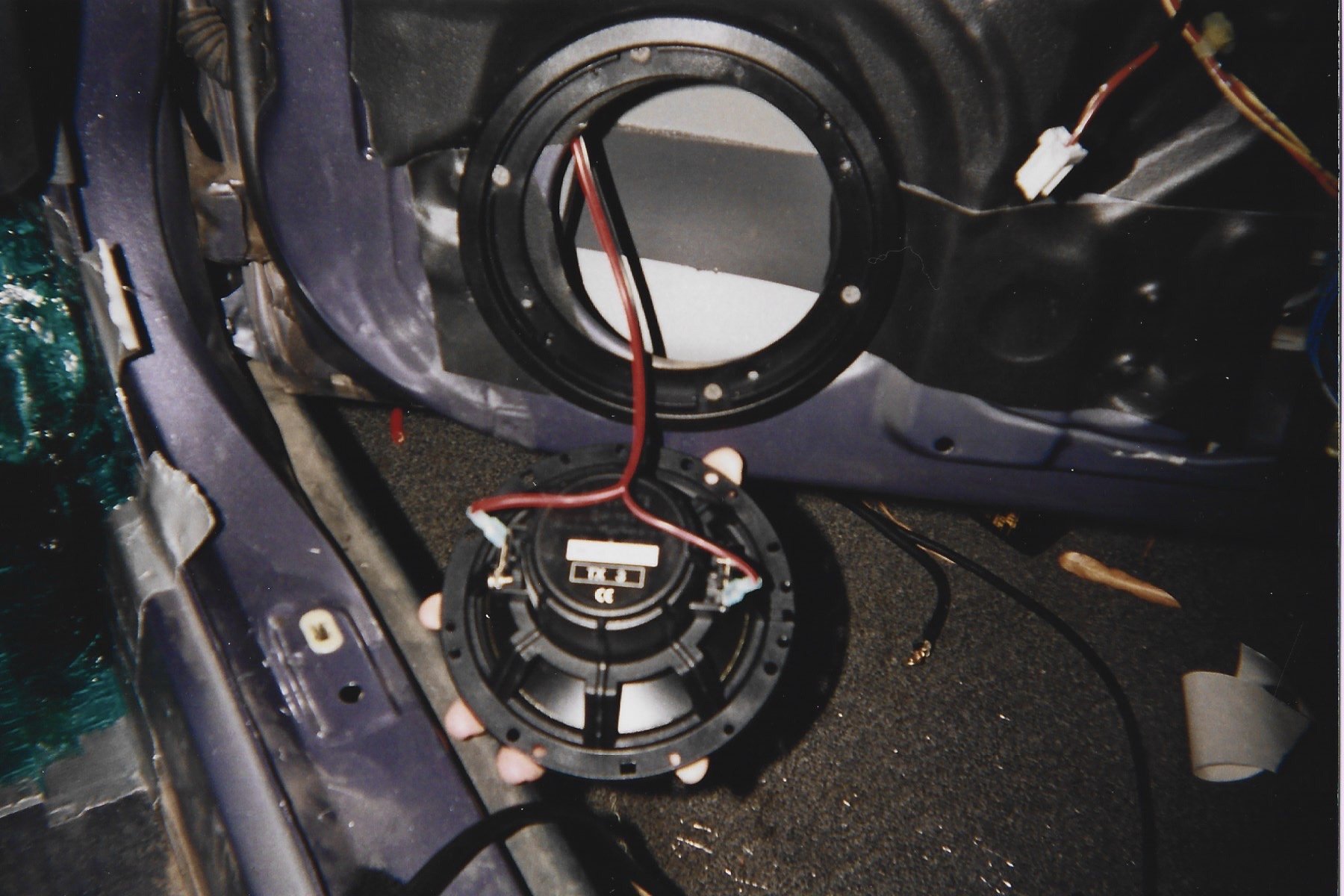

Mids going into the doors

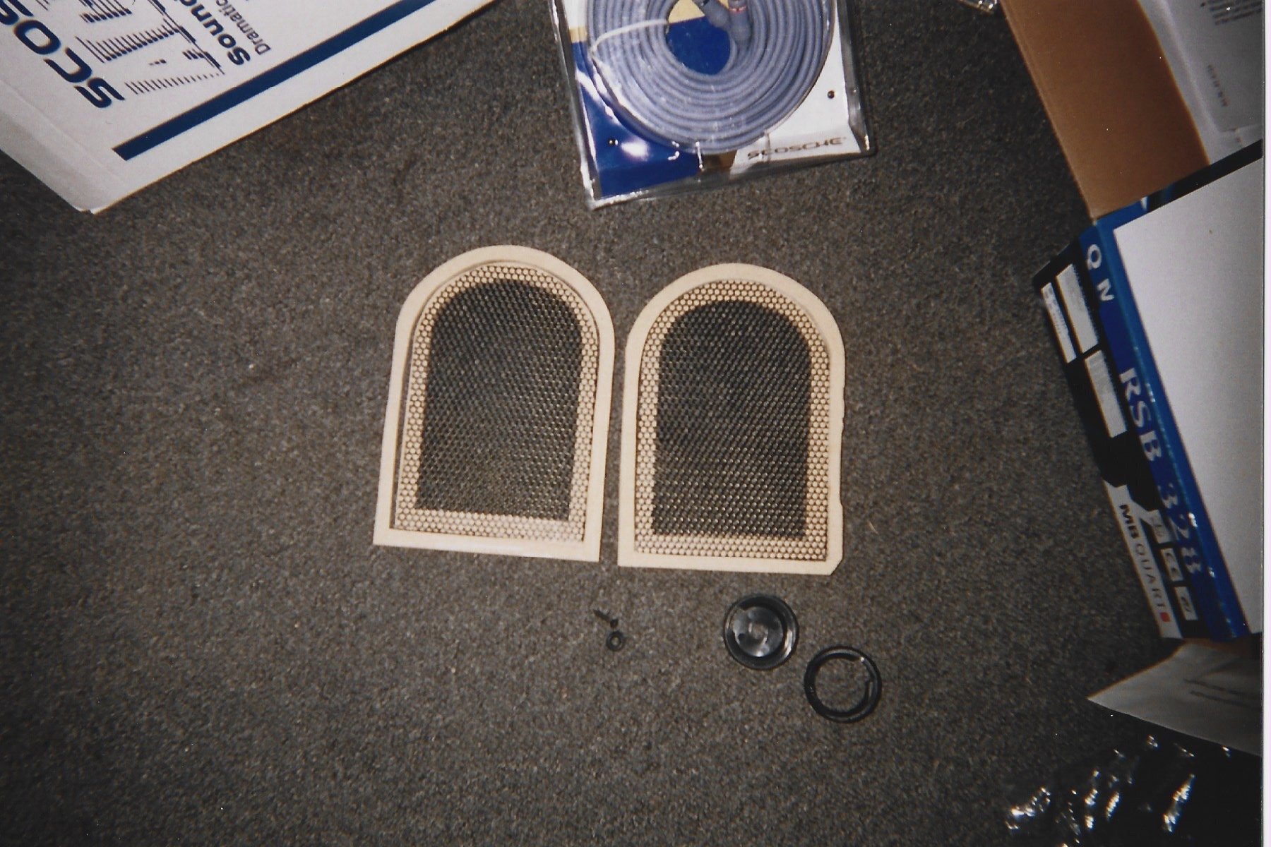

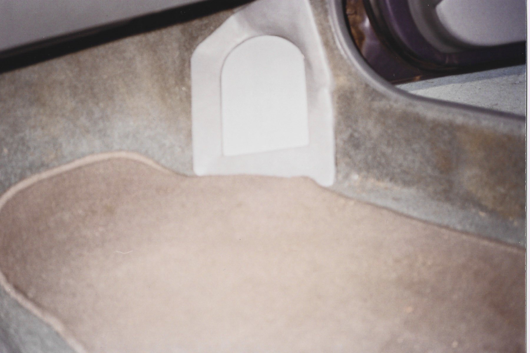

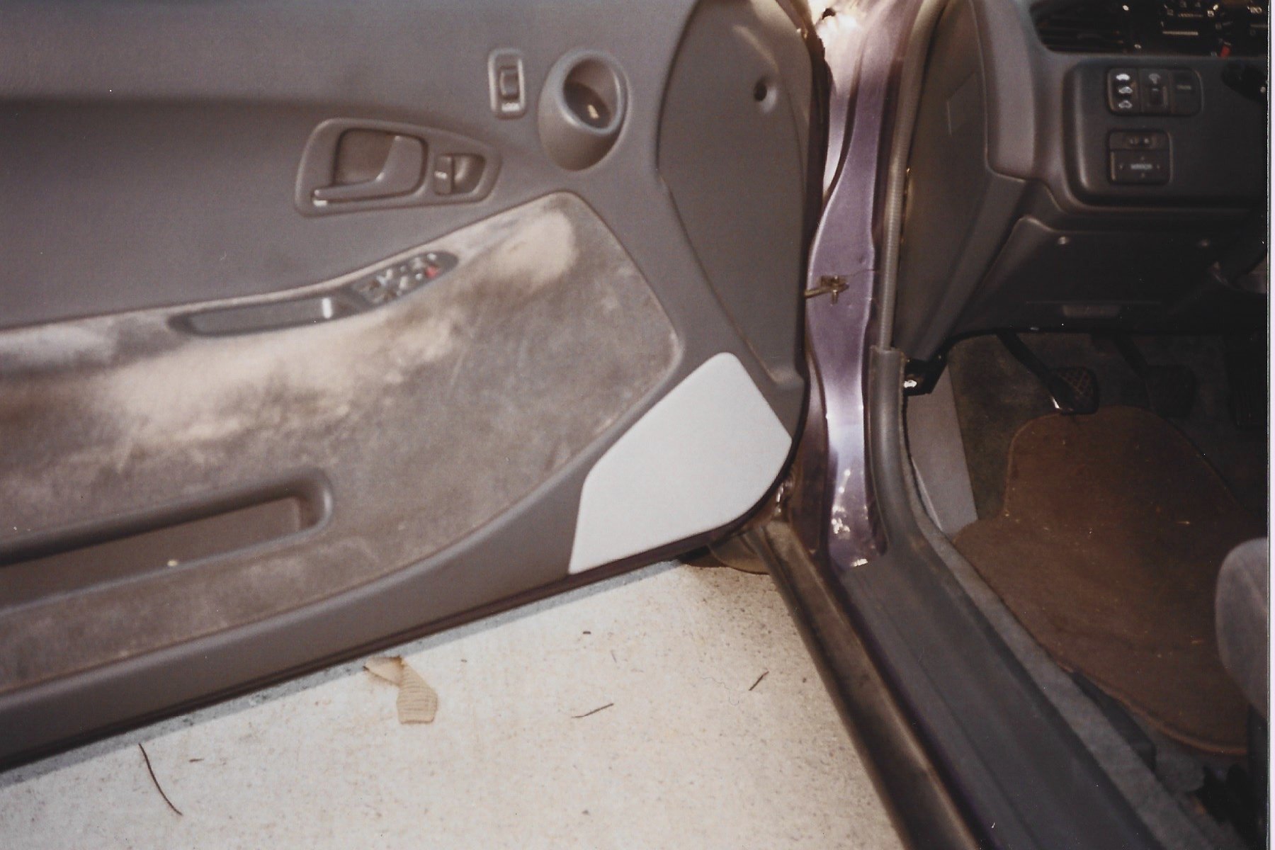

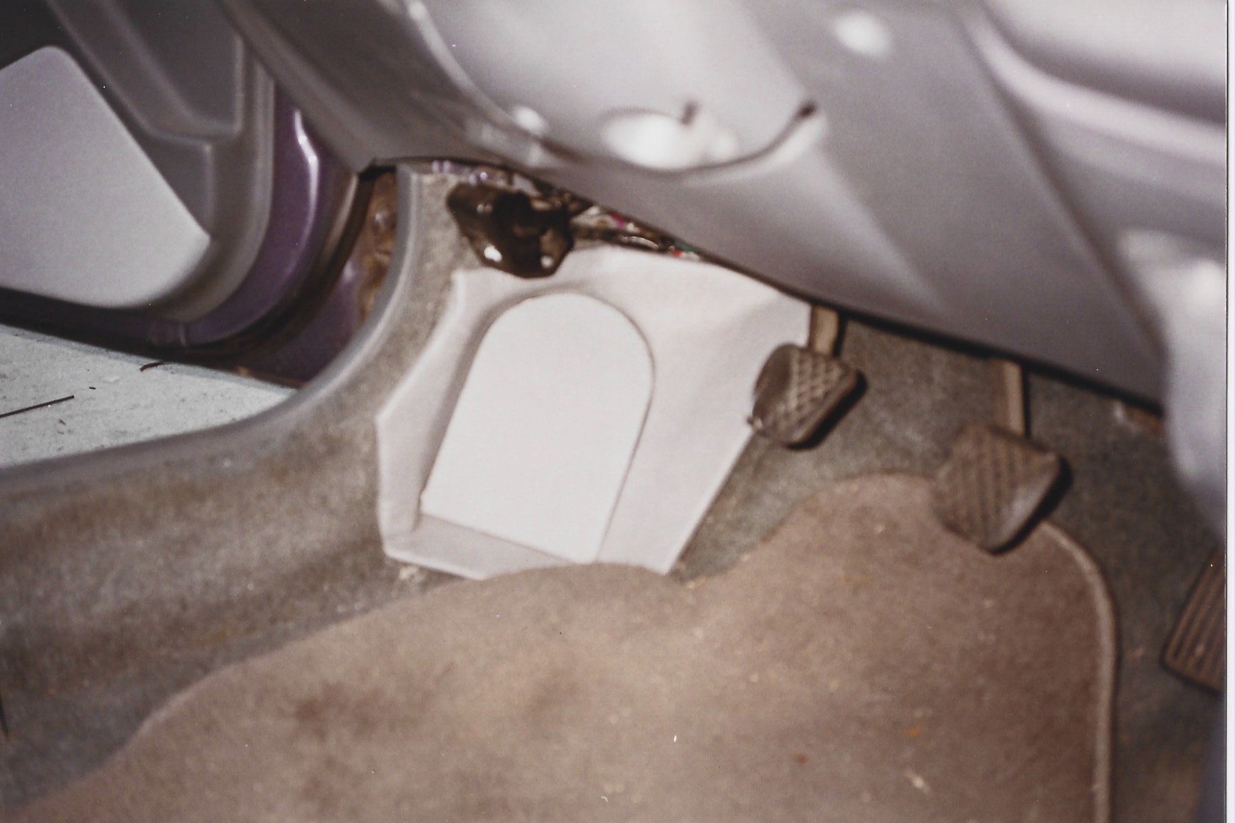

Doors finished with matching grill cloth stretched over the factory grills

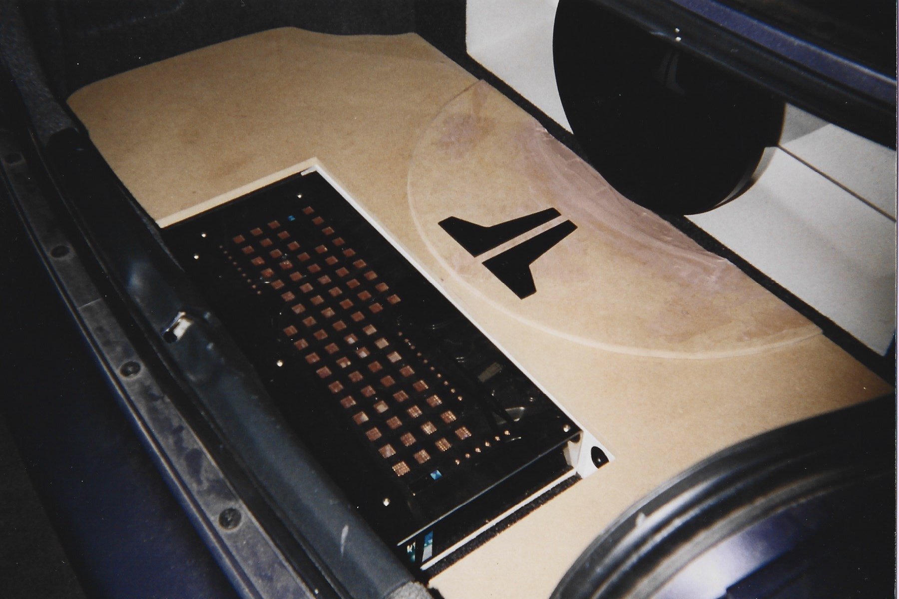

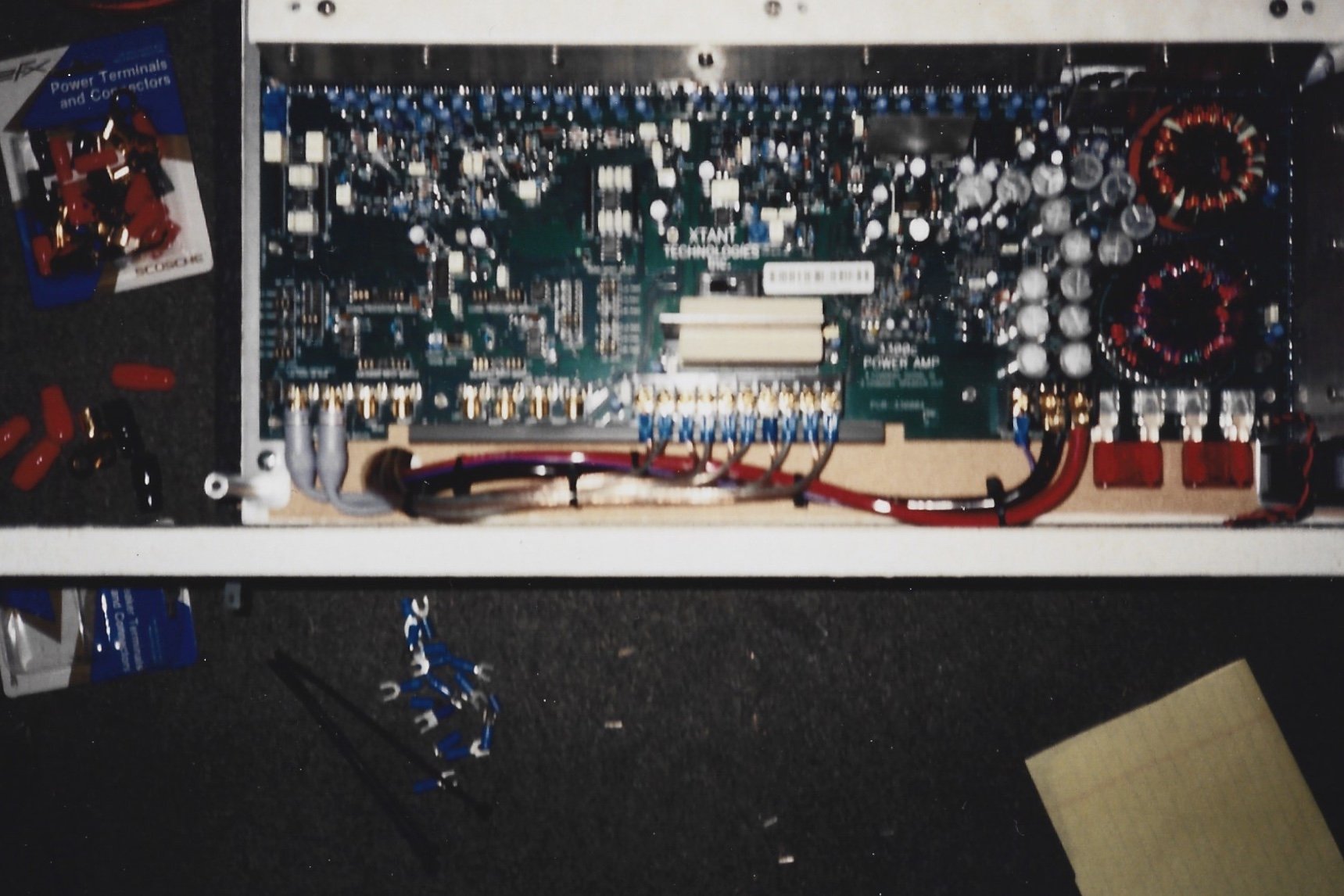

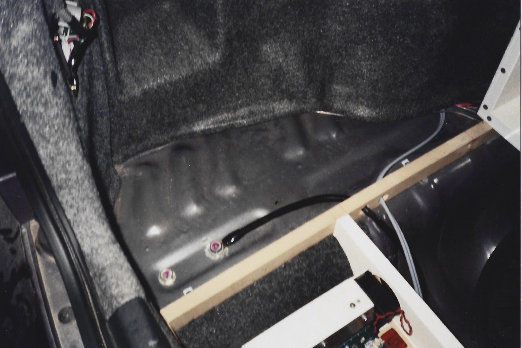

ctant 3300c getting wired up

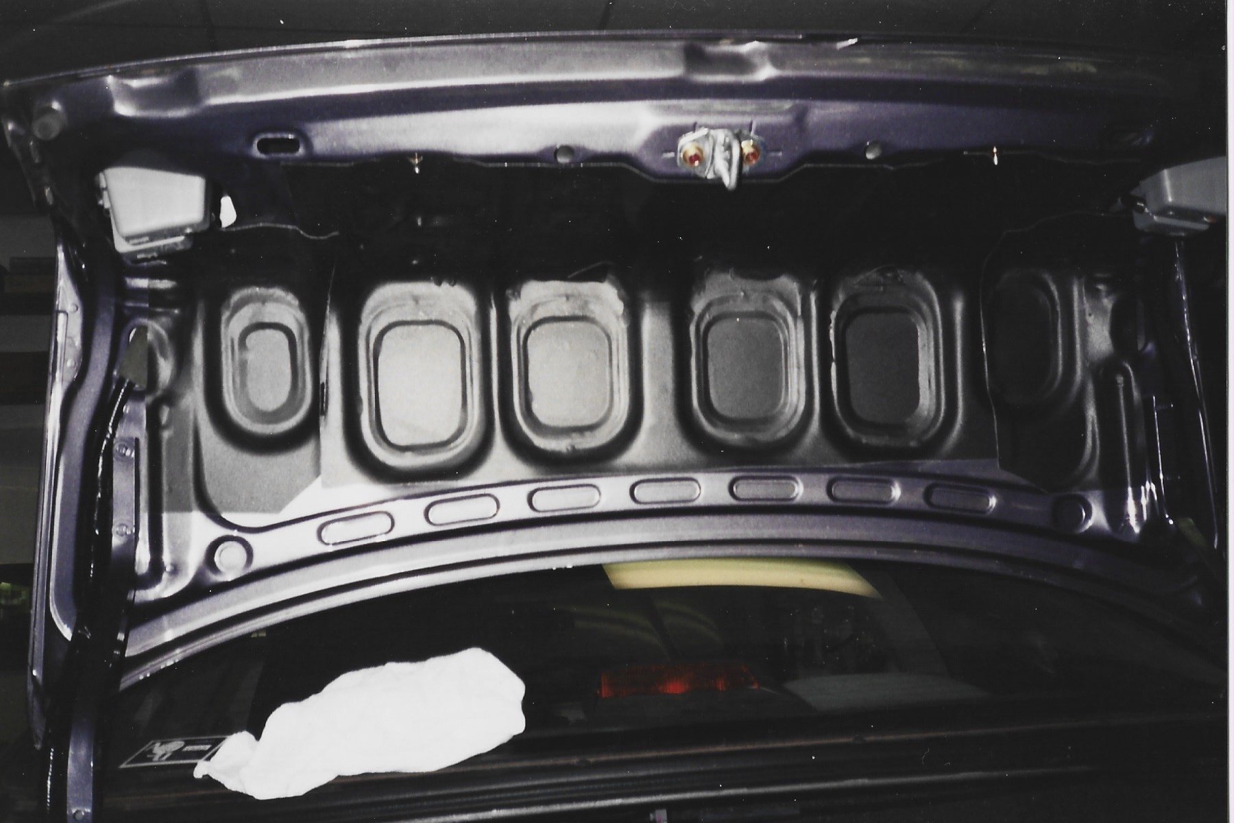

Ground wire terminated, also some of the framework to raise the trunk floor

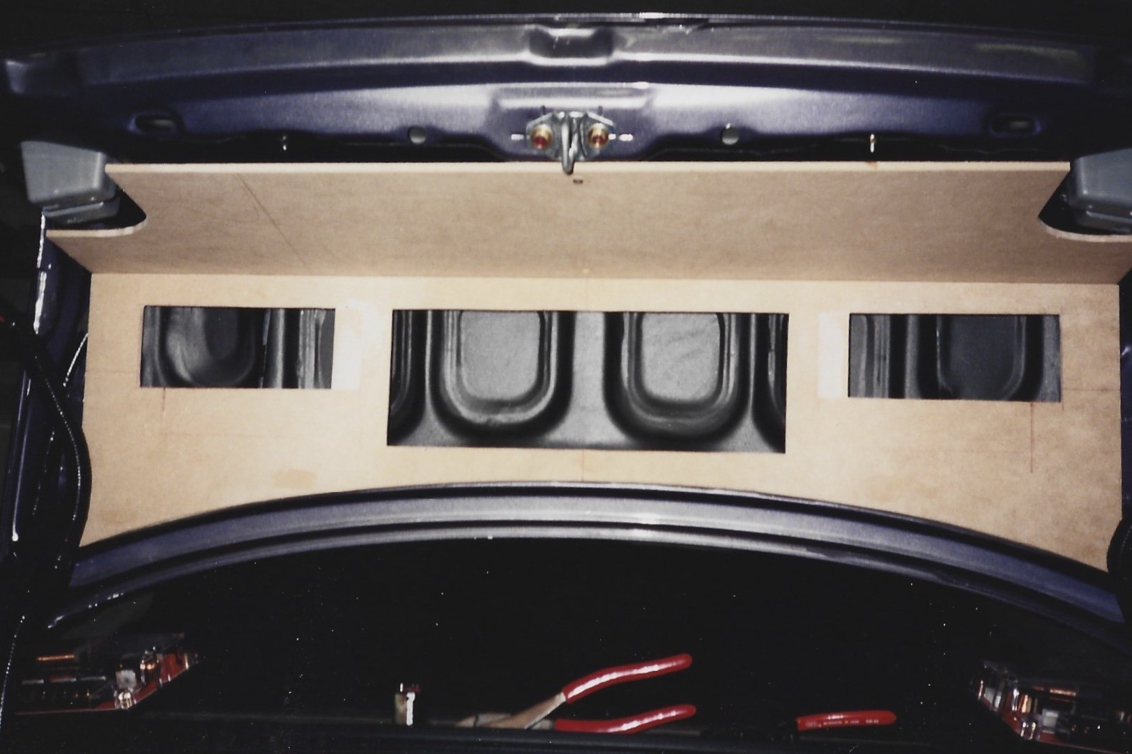

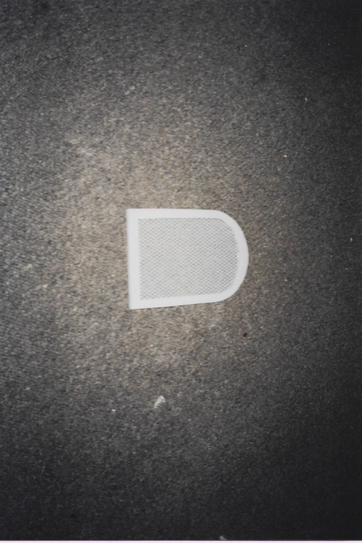

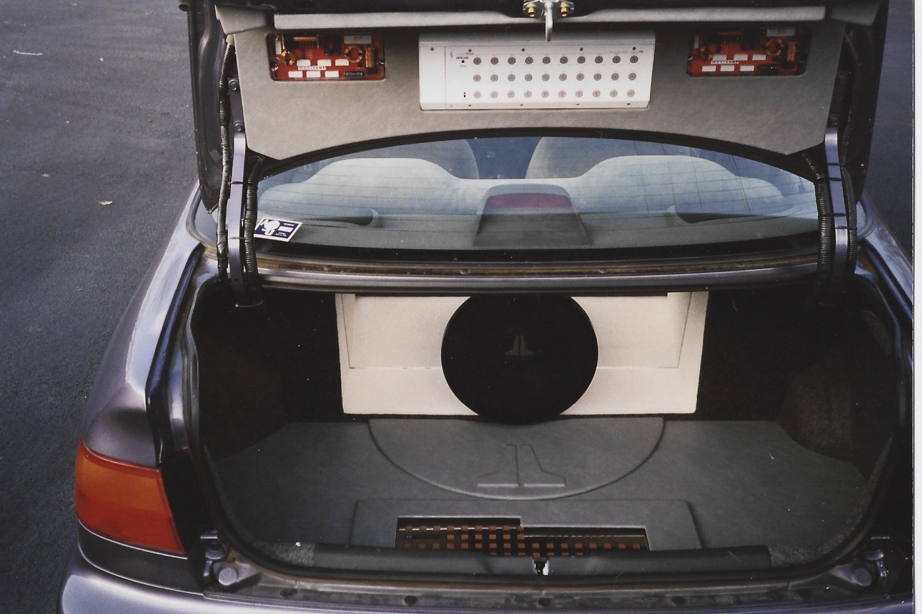

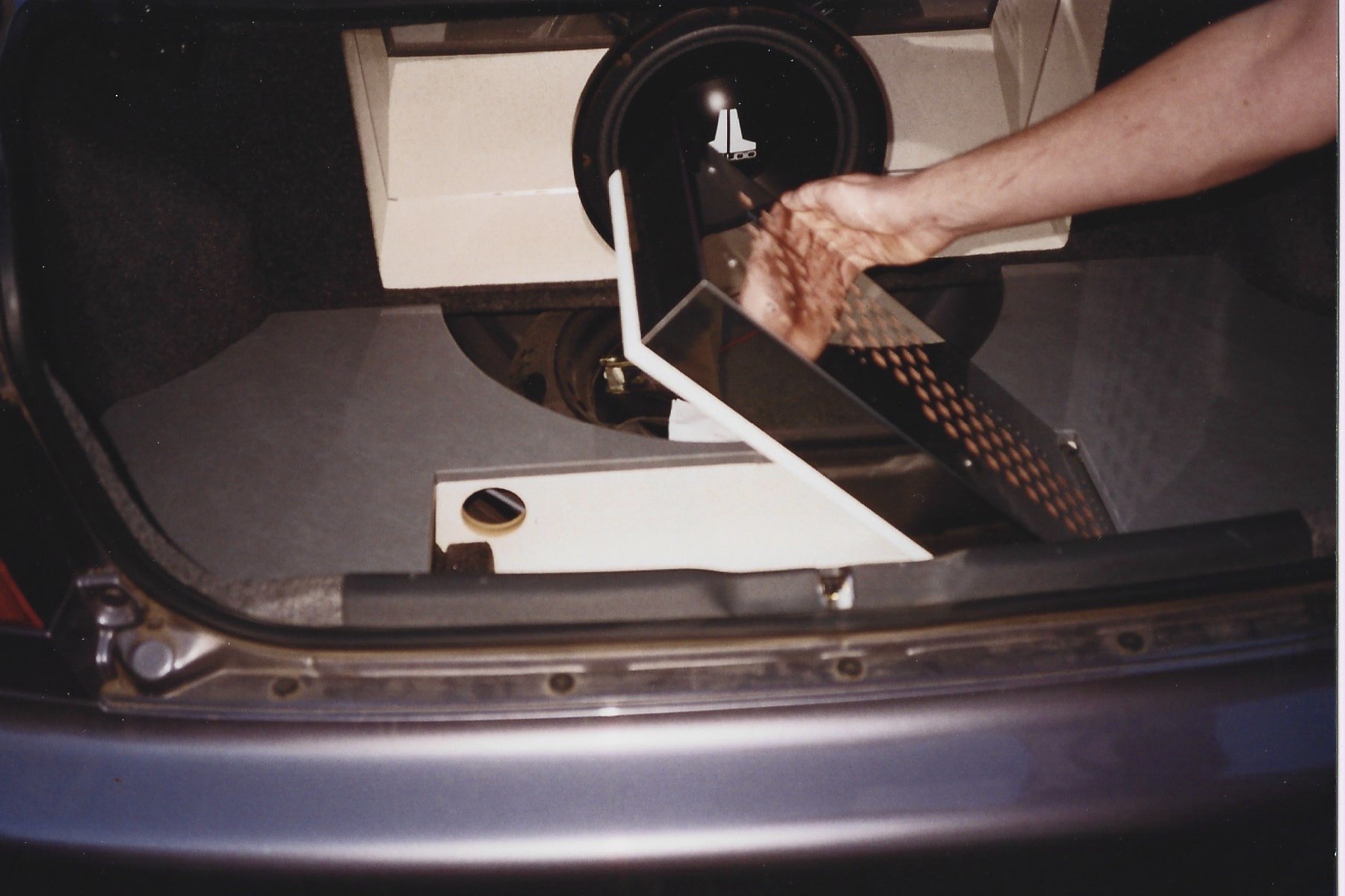

Trunk trim panels test fitting. The half circle with JL logo was removable and the spare tire was accessible through it.
Trim panels for crossovers and EQ being fitted.

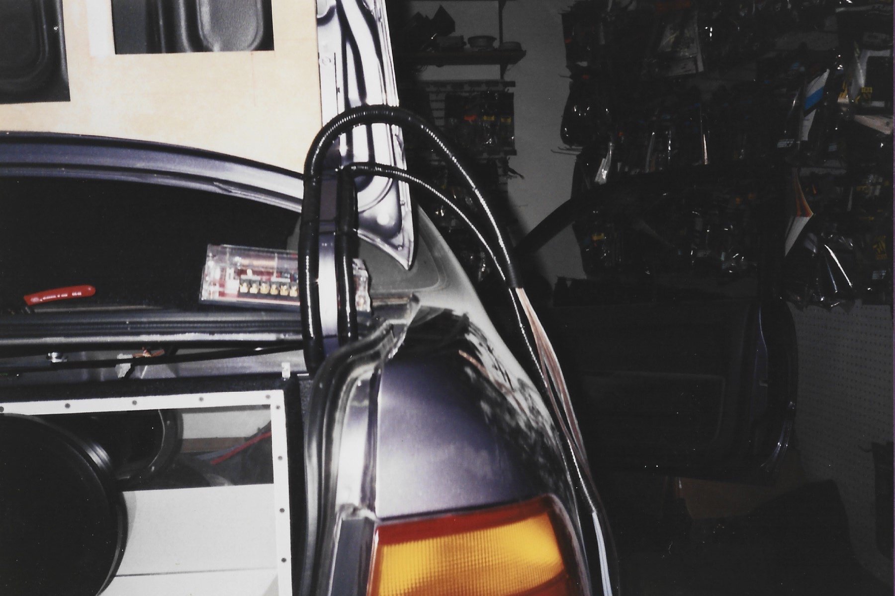

Wires getting ran through loom to the EQ and crossovers

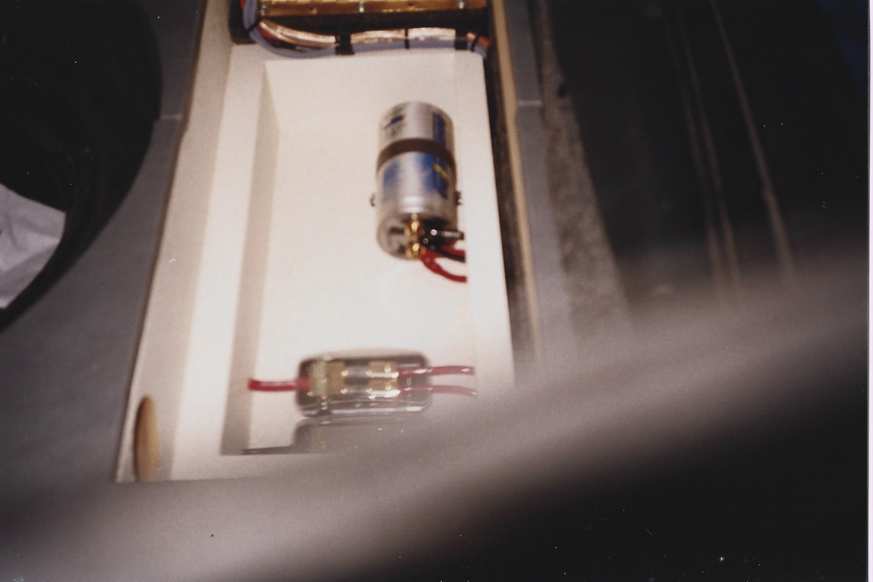

Amp rack was hinged in order to access the fuses and capacitor mounted underneath

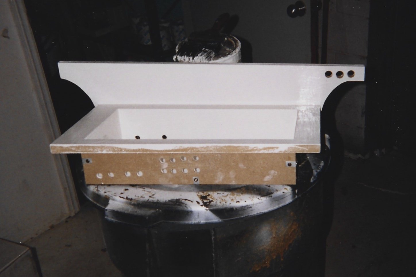

All trim panels installed. First generation 12W6 in a 2 cubic foot sealed enclosure. It’s mounted to 5/8” acrylic le an with white Flekstone paint and mirrored plexi on the back wall.It was also lit internally with purple neon.
