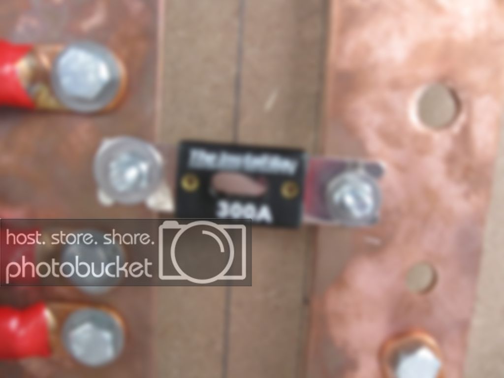

fuse is in! lets hear some musiccc
On the Bus Bar Setup, For Positive, Do you have like 5-6 Runs of 0/1 going from the battery rack Bar to one in the truck, then the 300amp fuse, then another positive buss bar, with two positives comming off, that feed the sub amp?
Thats kind of the way it looks but the pic with the fuse(s) was kinda cropped so I couldn't tell well...

Hey, Yes the 6 runs of 1/0 come in to the left side...Then goes across the fuse into the right side...then 2 runs of 1/0 go the the big sub amp.
The Reason i did it like this is because we have a American Bass 500.1 (5k at 1 ohm) and are burping it on 2 35 amp fuses. this actually helps it out with keeping the fuse from blowing longer.
and yes you will not find anything in the store like this, and it will be better looking by the time im done with it
