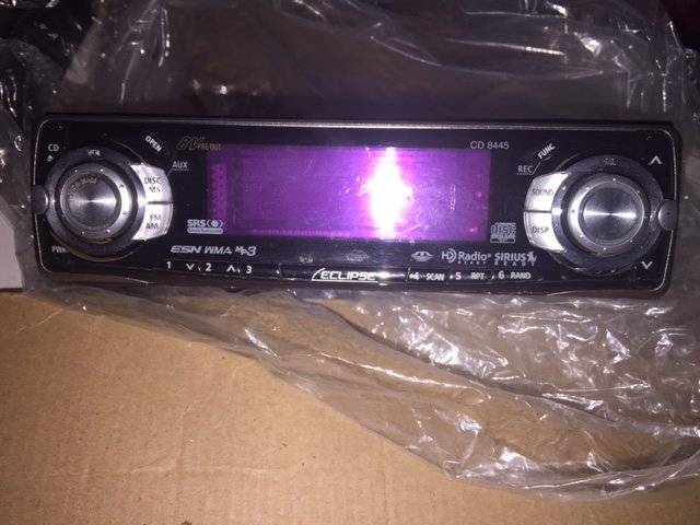

For the HU I already had an Eclipse CD8445 sitting in my storage...

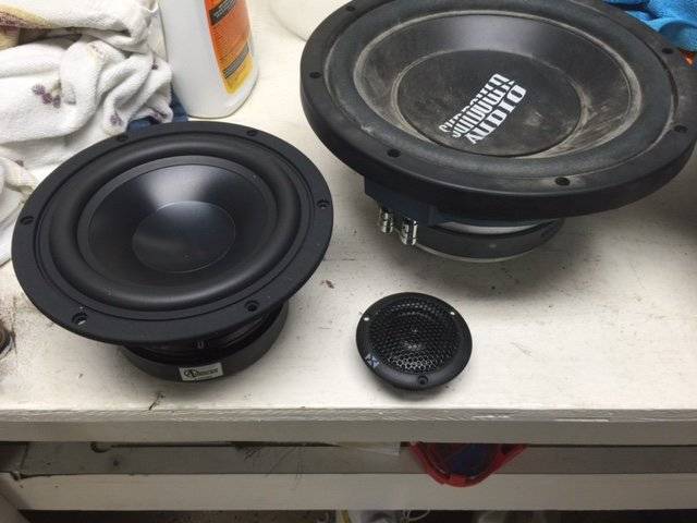

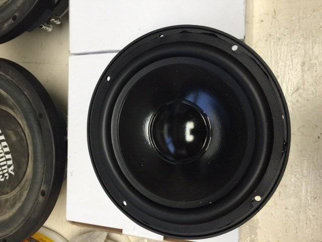

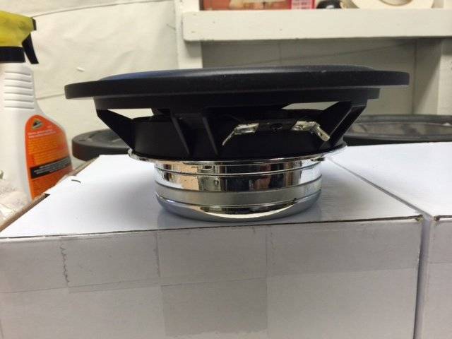

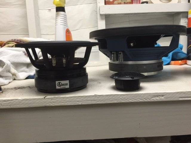

For speakers I went with NVX XSPTW tweets and I was going to go with Exodus Anarchy mids but they turned out to be too deep and I found a set of Stereo Integrity TM65s to run instead. I had a couple of Sundown 10" SD1v2s in my storage that I pulled out for sub duty...

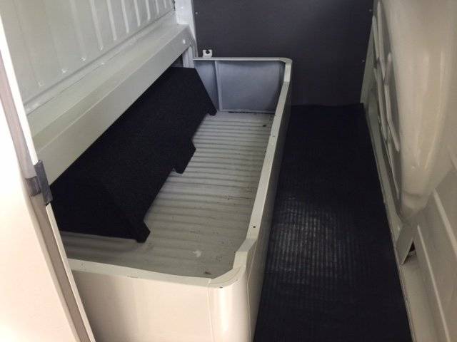

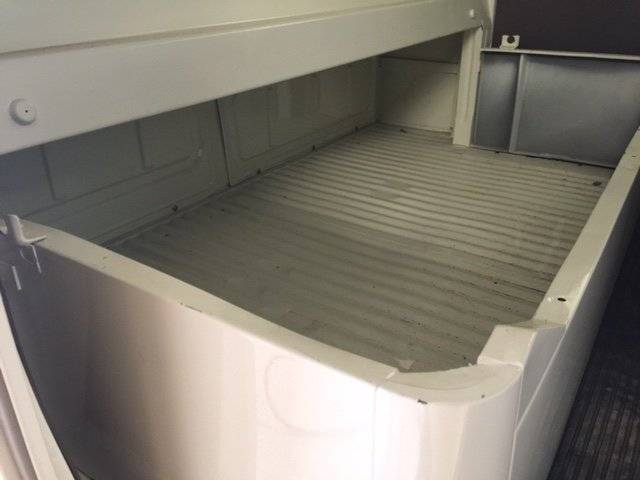

Here's the area where everything is going to go. It's a tool compartment that is underneath the rear seats...

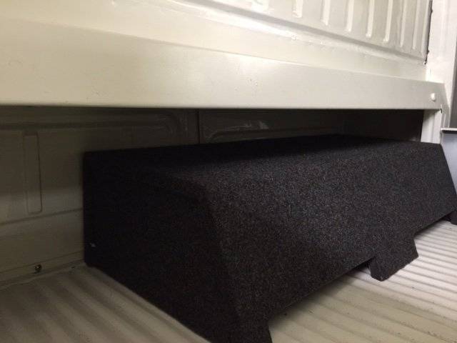

I ordered a prefab downfiring box for the subs that just happened to be the right size to fit comfortably in the tool area...

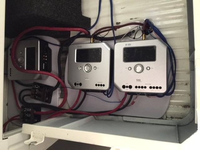

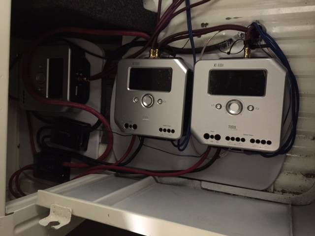

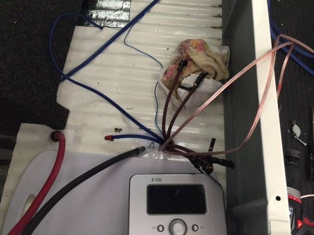

There's really no way to run wires cleanly on the inside of the cab so I decided to drill a hole and run everything underneath along the frame rail. I used a screw in wire pass through to get all of the wires through the floor...
Wiring everything up and mounting everything to some cutting board amp racks...

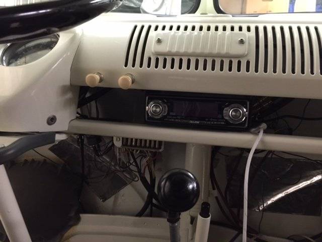

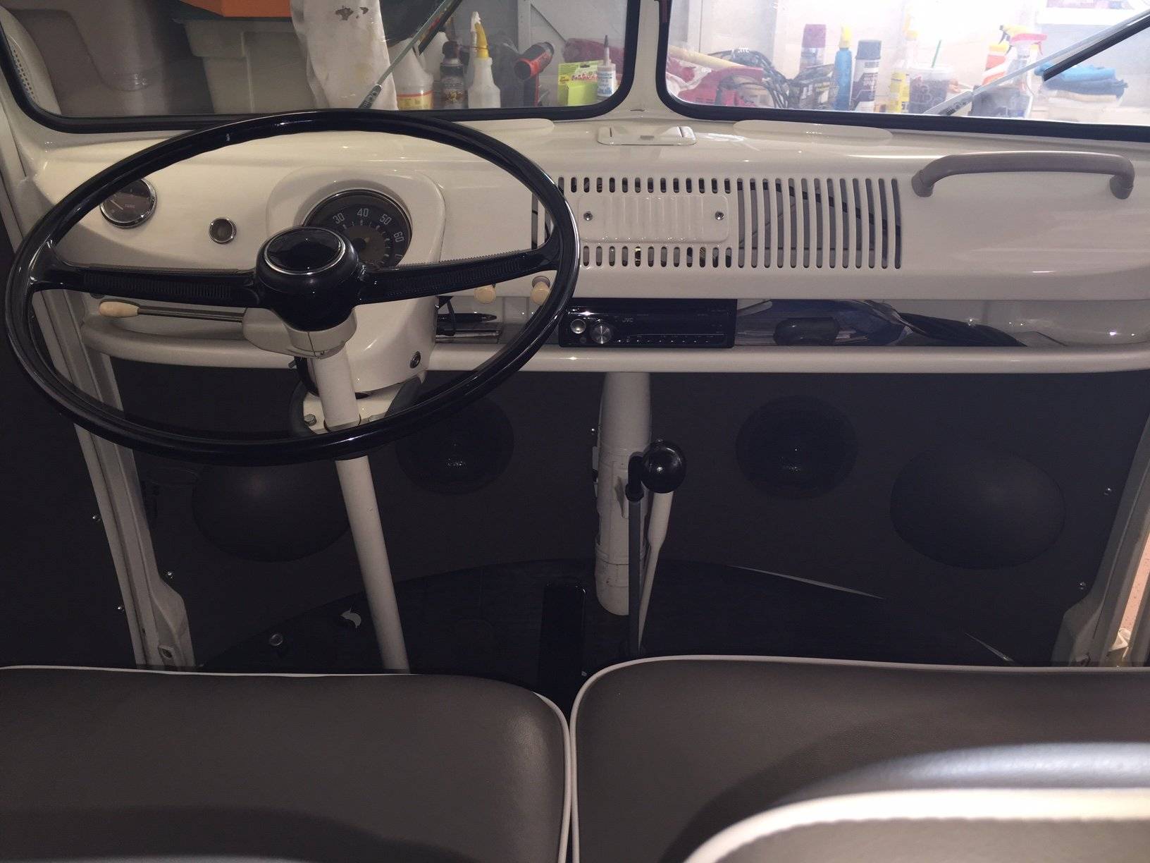

The Eclipse mounted and the front wiring...

Those anarchy mids are beefy. Are you gonna do some sound deadening?

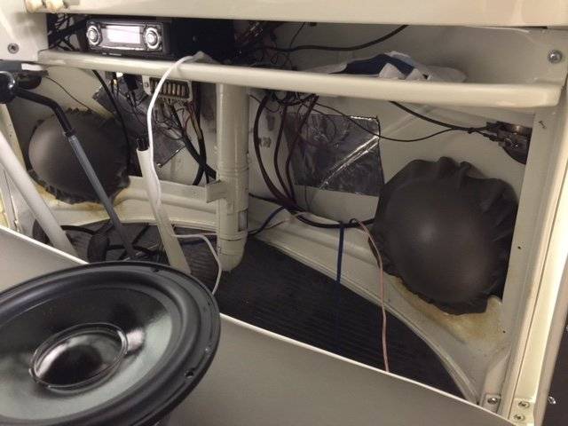

Hell yes they are. I wish I could have made them work. The SI TM65s are no slouch though just a more manageable package. I deadened the tool area where the subs and amps are and threw a file tiles on the front sheet metal behind the kick panels.
I'm going to deaden the heck out of the fiberboard kick panels once I finish mounting the tweets/mids on them.
