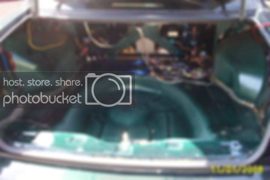

Last but not least here is an actual picture of the trunk taken before the sound deadening for visual clarity
I would want the box to be about 5-6 cubes of internal volume... I've long since forgotten the trunk measurements and haven't gotten into the specifics of it yet but this was just a preliminary idea I was tossing around... anybody worked with a design like this?

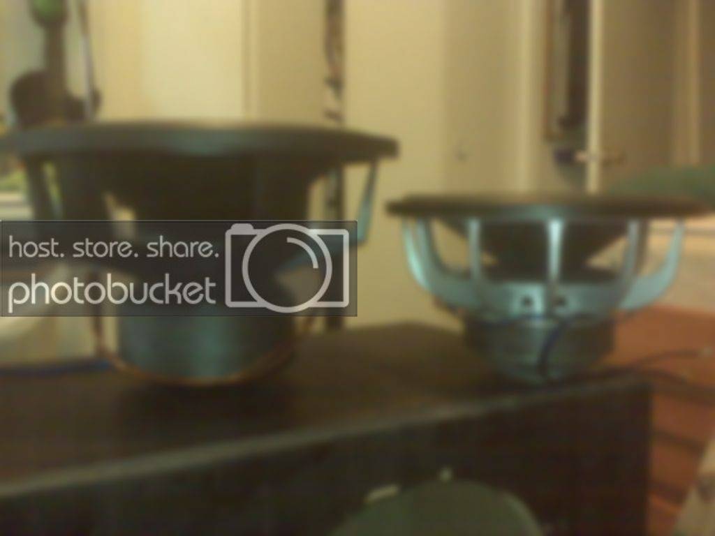

Oh by the way if anyone wanted to see this big bastard here it is next to my 15" Fi Q lol
