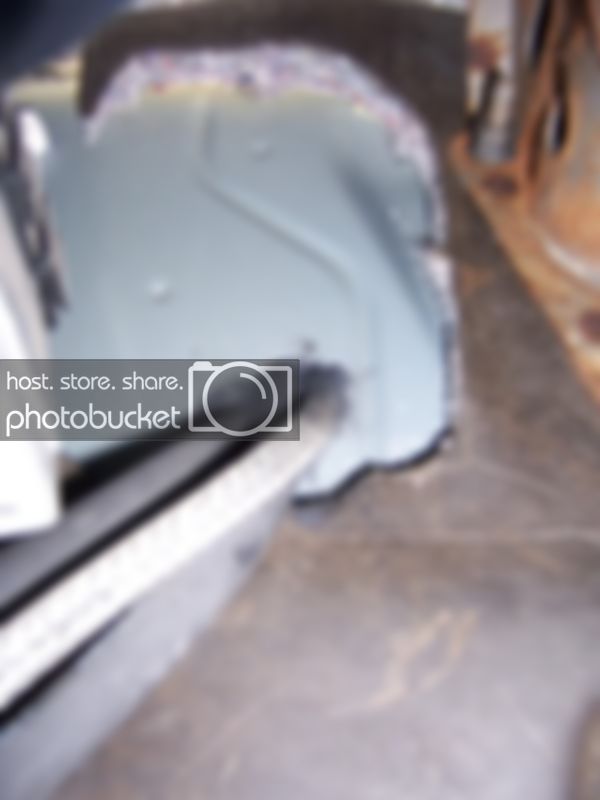

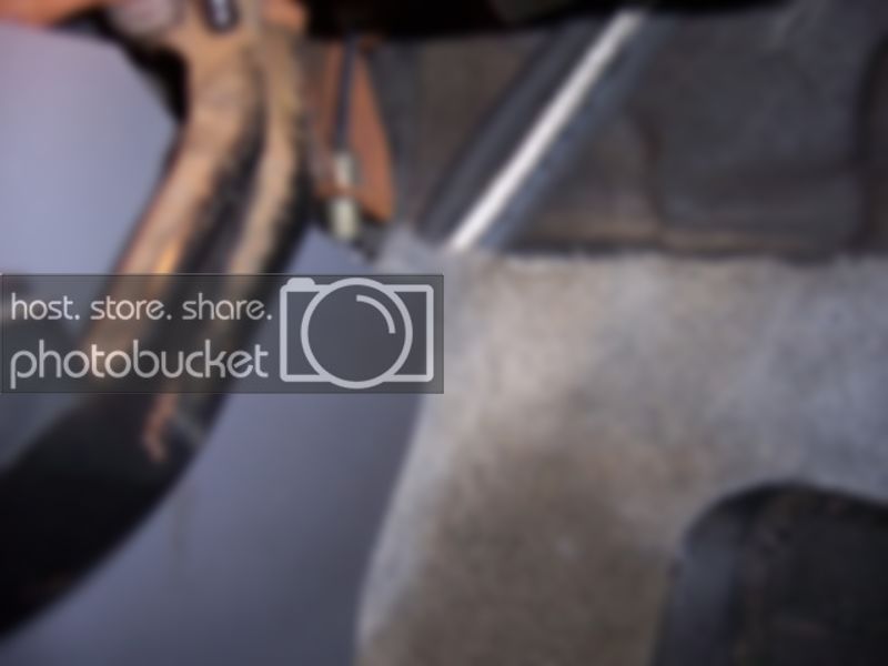

^ Had a handfull of grommets but couldnt cram them in the monsterous hole/holes that I drilled out with the hole saw. Barely fit all the wires in but I got a good amount of caulk in there, after it hardens up it should be okay but Im going to keep an eye on it just incase.

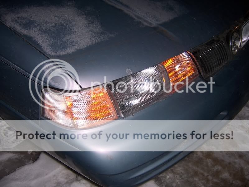

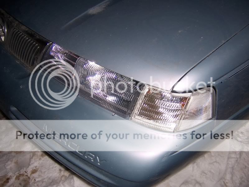

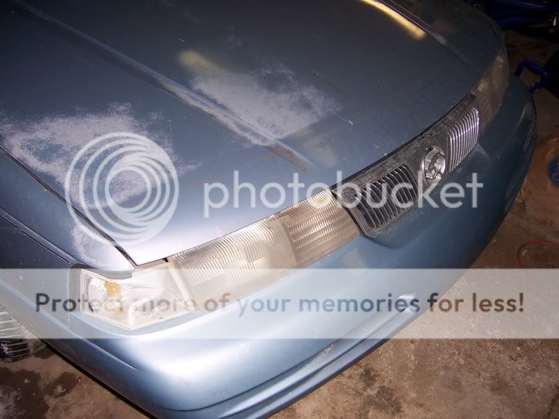

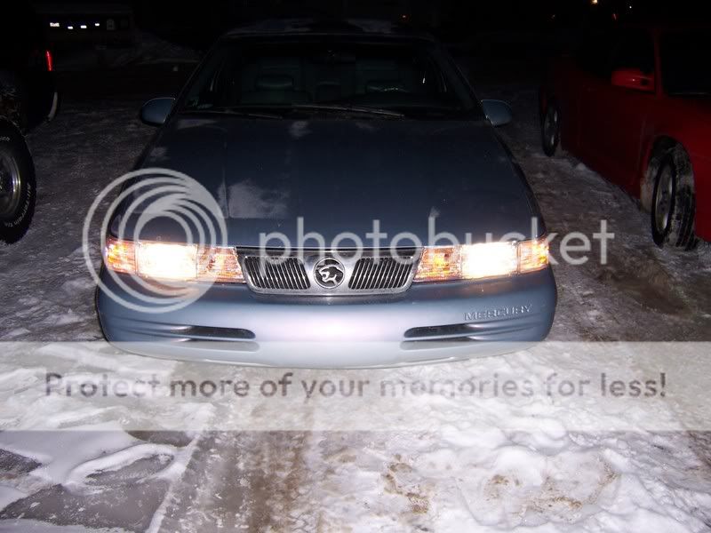

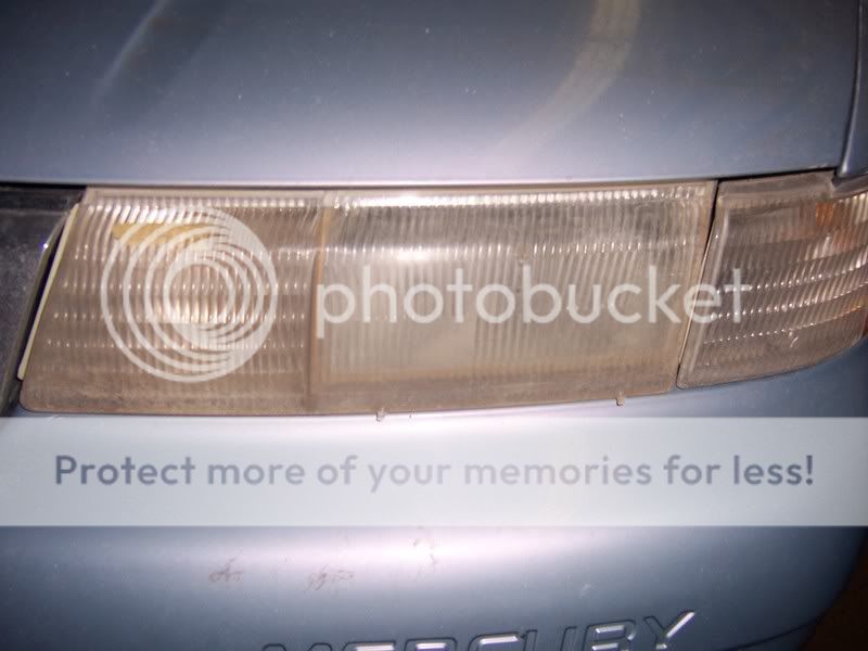

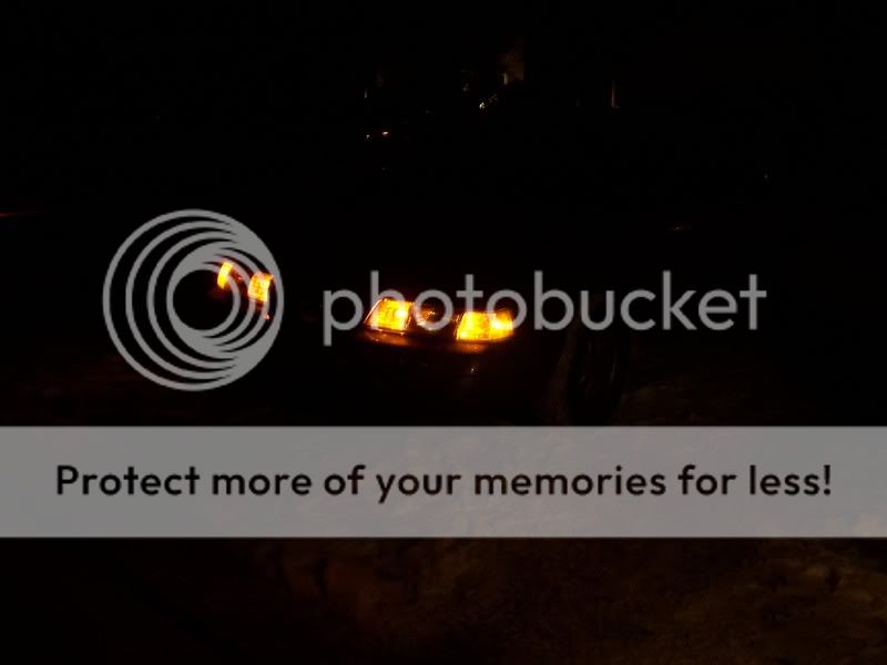

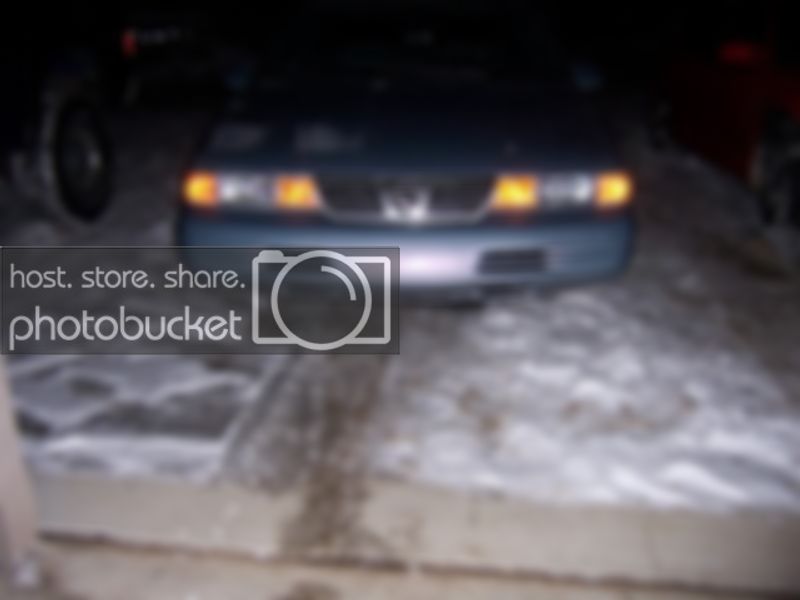

Old shitty headlights
Couldnt see shit at night
Now I can see!!!
As for the car, I need to throw on a set of mufflers in the next weekend or so, and then it gets paint in the summer!

Same for me, I head to lean up underneath the dash on the drivers side. I was attempting to drill out a hole at like a 45 degree angle, which is next to impossible especially without a punch. Well I found a small dented spot in the firewall, so I was able to get the bit to grab, as soon as the bit made it through the hole saw just ripped the ***** apart.
But then I had to have another hole next to it for the other run of 1/0. But there was no other small dents in the firewall to drill on. I basically just stuck the bit of the hole saw in the existing hole, pushed it to the top and let that ***** bite a little bit and it ripped right through.
Didnt turn out how I expected because I wanted to have two purdy holes with grommets but it ended up working out okay. I dont think it will have any problems, its caulked all to hell and the wires arent going anywhere. Zip tied and sealed up tight //content.invisioncic.com/y282845/emoticons/smile.gif.1ebc41e1811405b213edfc4622c41e27.gif
