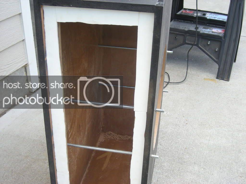

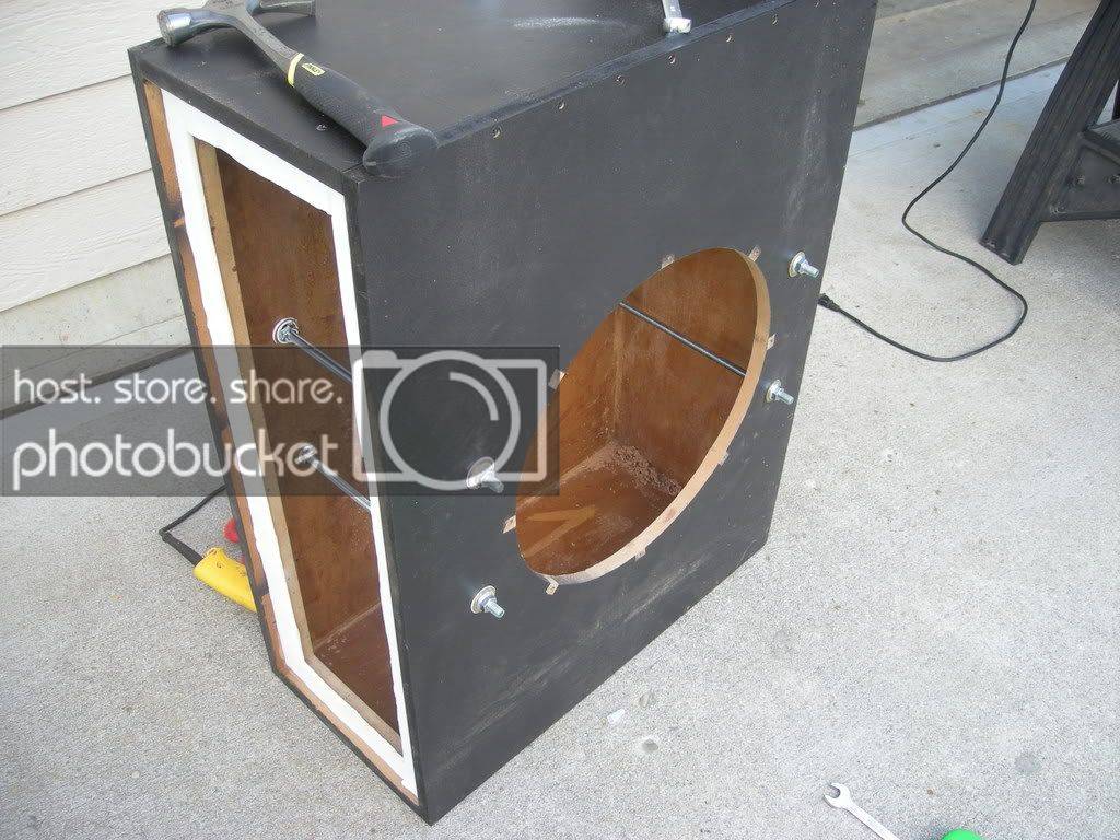

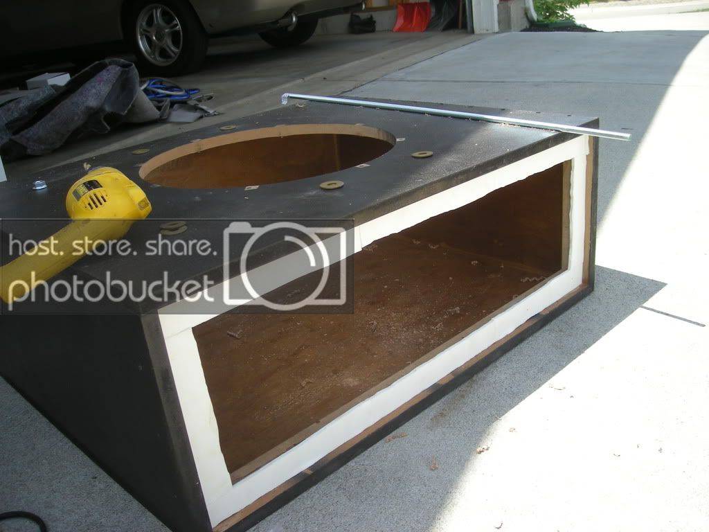

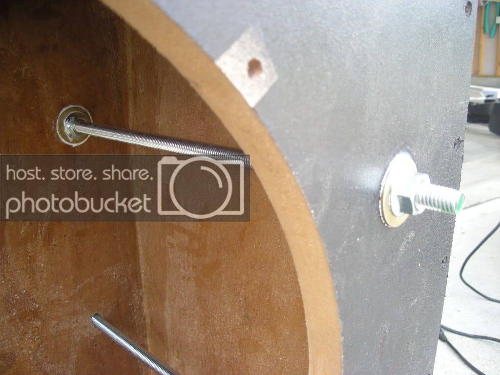

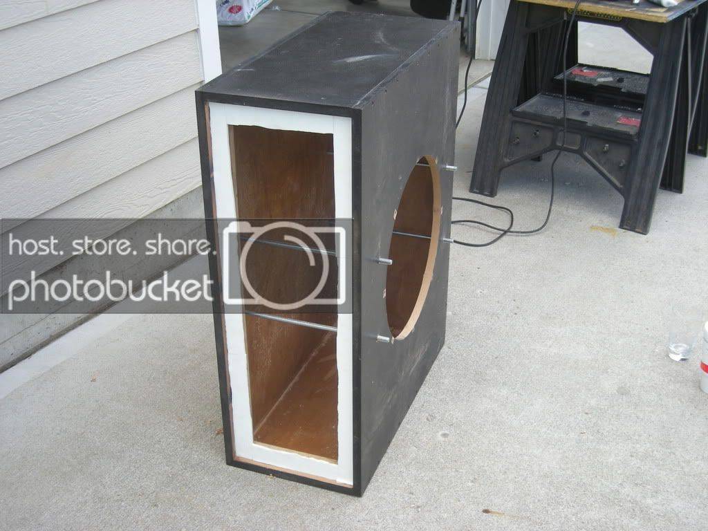

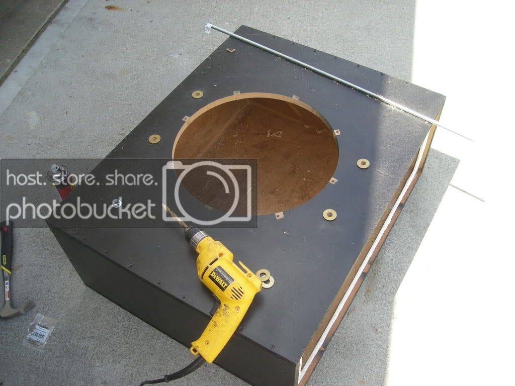

Shoot, I didnt even post the updates on the box...haha, well here they are

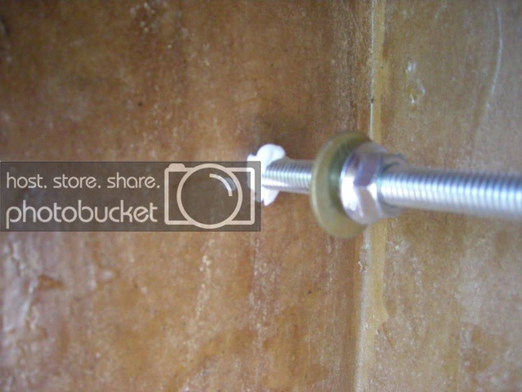

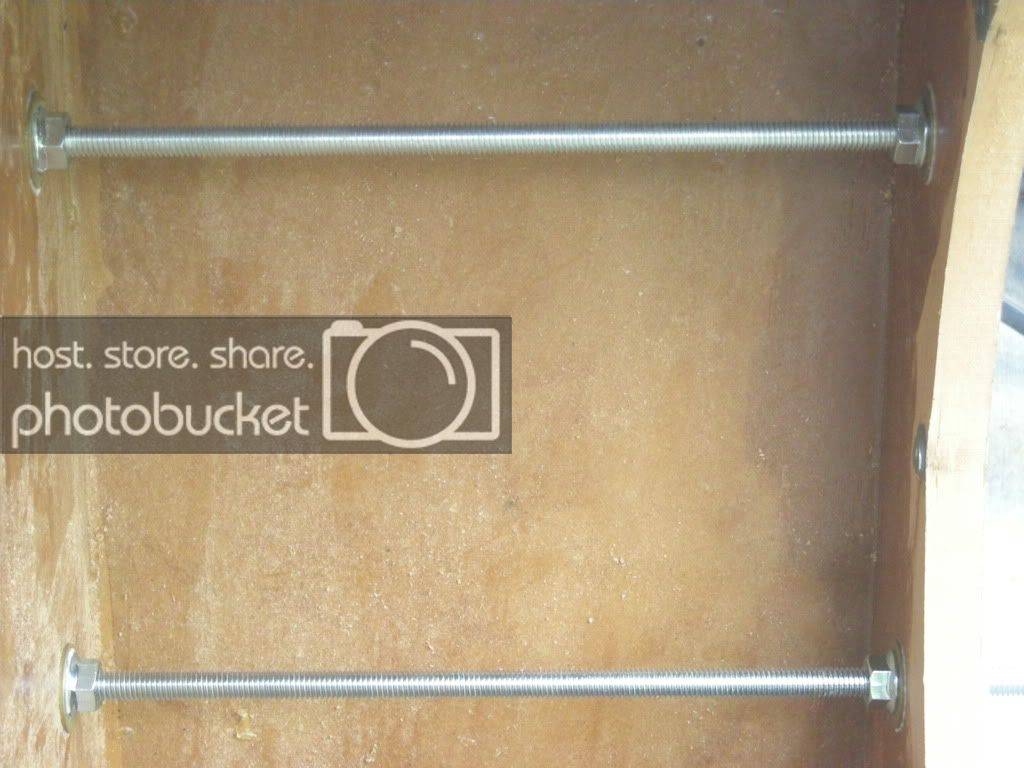

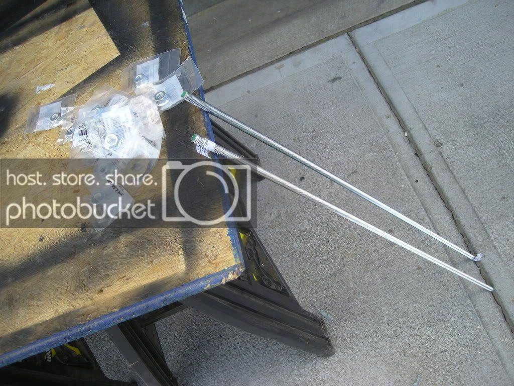

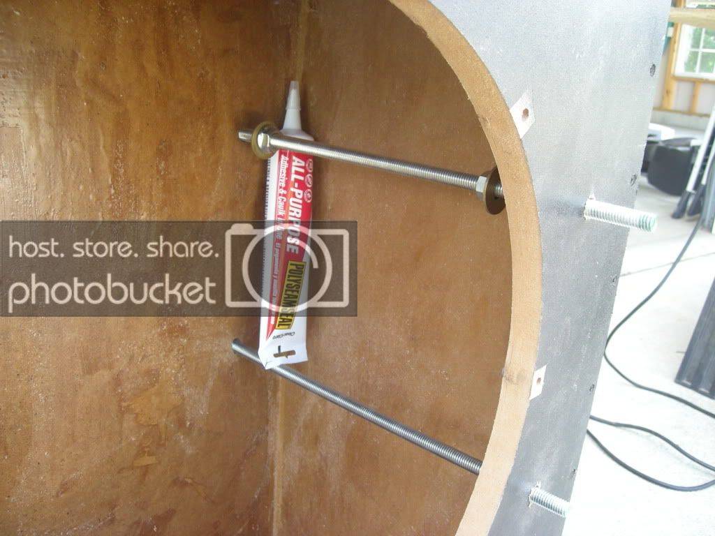

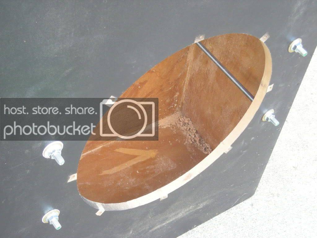

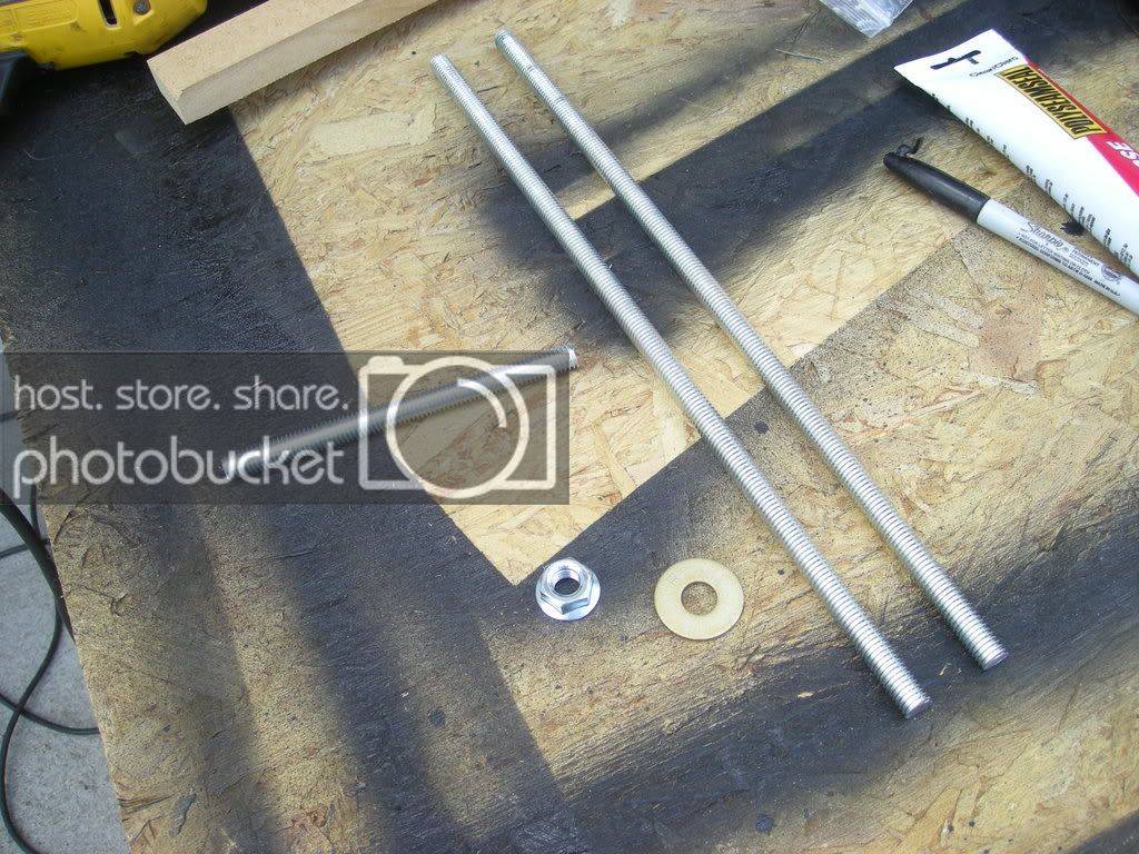

Got some all-thread supports for it and resined the inside...along with adding rubber-foam to the lip to make a nice seal..
Putting sealant on each washer and nut..
Done..
And thats that...I will be rebuilding another port-wall soon, im not going to lie...this port-wall was a complete fail when I drilled the holes for the mounting points...multiple didnt line up right when I drilled them quickly...but its for the better, next one will be better, stay tuned
