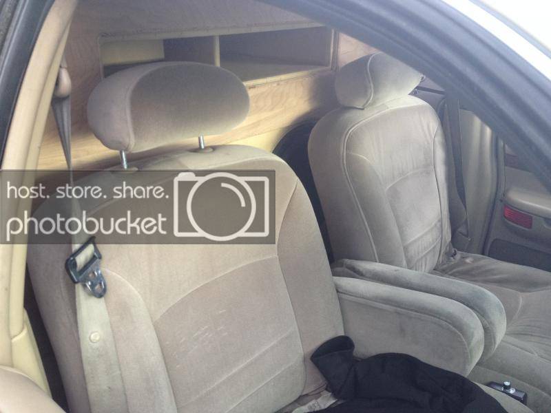

Here is a member on heres setup. On 6500rms though.
