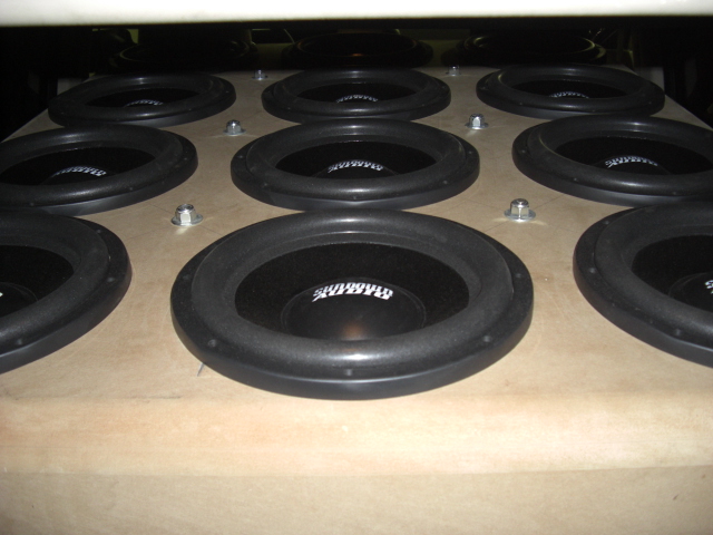

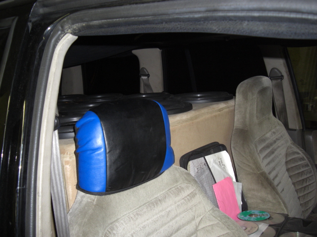

Currently doing 153.1 dB @ 35 Hz sealed on the dash on the TL with an American Bass 1000.1 wired to 1.33 DCR per "side" (as it is two amps in one).
Power not measured but the subs are moving maybe 1/2-3/4 inch P-P wired at that load.
Derrick will be in shortly with more pictures and pictures of the TL screen //content.invisioncic.com/y282845/emoticons/smile.gif.1ebc41e1811405b213edfc4622c41e27.gif

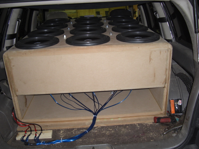

Port is 288 in^2 tuned to around 44 Hz "on paper" but peaks at 35 hz in the vehicle.
Roughly 20.4 cubes after port displacement for the box... so after sub displacement just a hair over 1.5 per sub.
wires through port make me sad
Not a problem with 288 in^2 of port area -- he also drove in from out of state and we wanted to get it playing before he went home //content.invisioncic.com/y282845/emoticons/smile.gif.1ebc41e1811405b213edfc4622c41e27.gif
port wires are kind sad.
X3... makes things look "ghetto rigged". Also, the setup loses points for a ***** enclosure. Don't get me wrong, I can understand if this is a test setup, BUT, for a competition setup, the installation should look much better.
