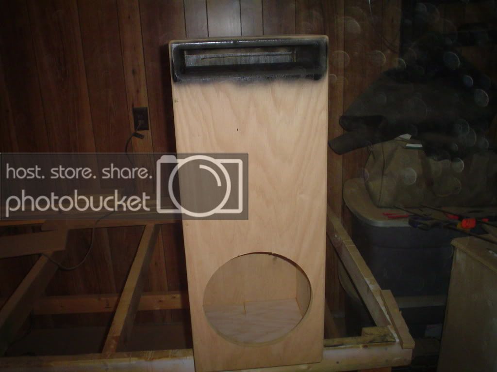

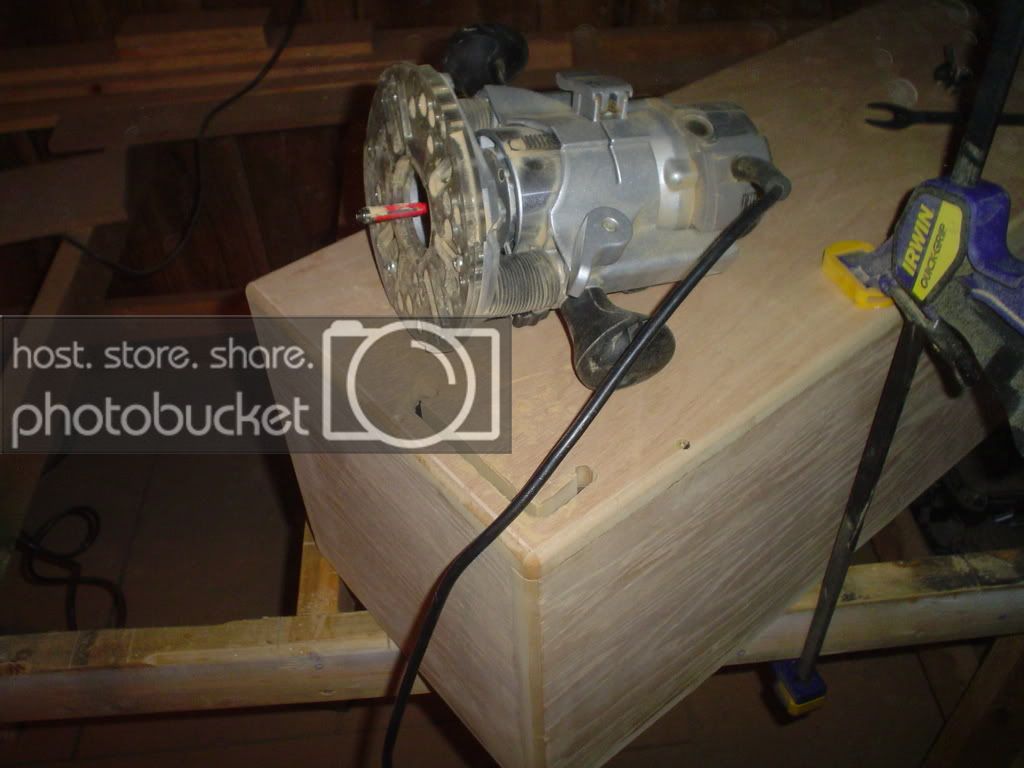

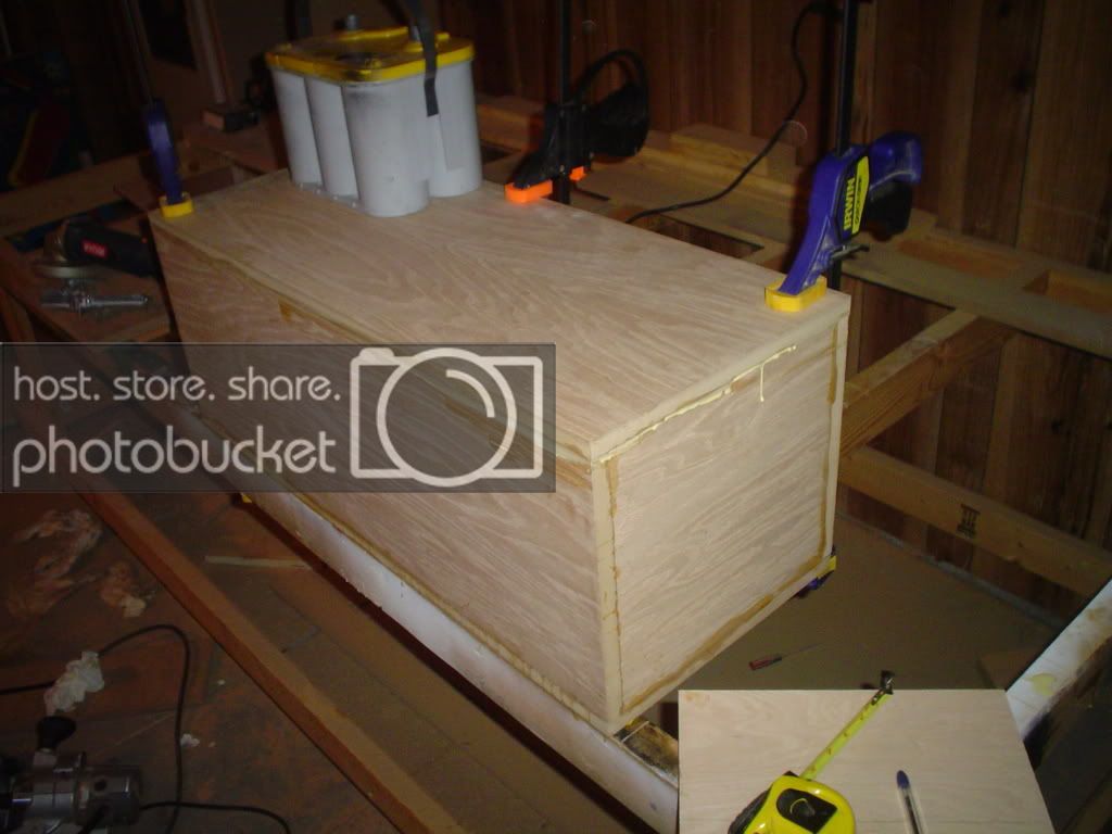

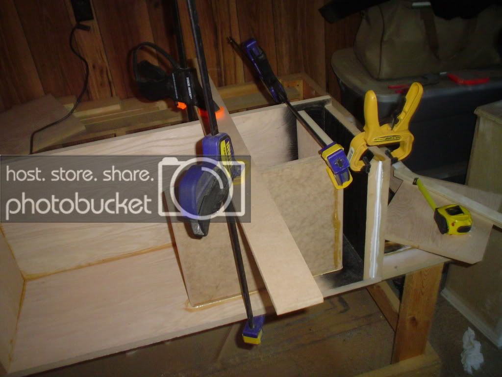

Built box for another member here for a 12 W7. Box is 1.75^3@32 htz.
In the process of carpeting now. Had to use oak ply....MDF with oak veneer because i didn't have a truck to move full sheets so had to use some 2' x 4' pieces.

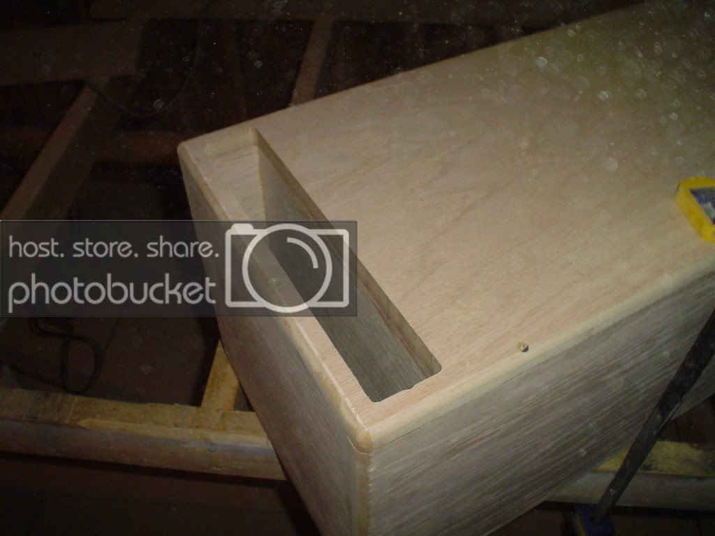

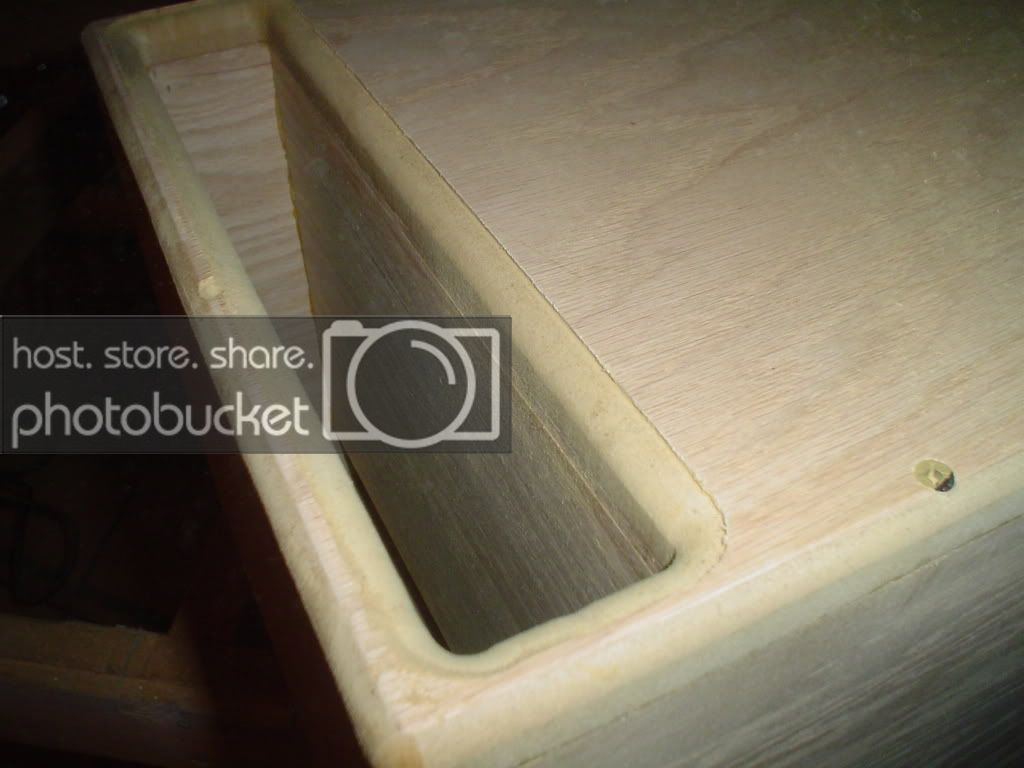

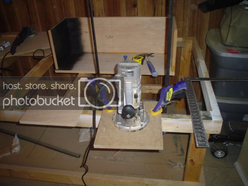

Youll get better results on the port if you precut it out first with a jigsaw. I see you had some bit chatter and took a chunk out of the wood in a place or 2. Your bit will also last much longer.
definately...i was in a hurry to finish it last night and didn't have any sharp jigsaw blades:crying:
Looks good.

whats the dimensions of that box? and same question how much to build something like that? might be hitting you up soon for something similar if ur up to it
Looks really good Bones! I would critique ya, but I couldn't do much better.................actually anything near that good. I el sucko at making boxes!
word...thanks man. Let me know if if you ever need a box built, or any custom house speaker cabinets made. As soon as i get a new vehicle, i have a special box in mind:naughty:
