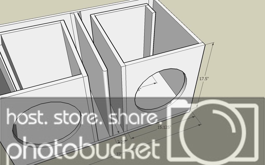

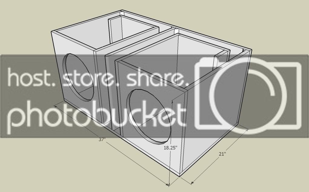

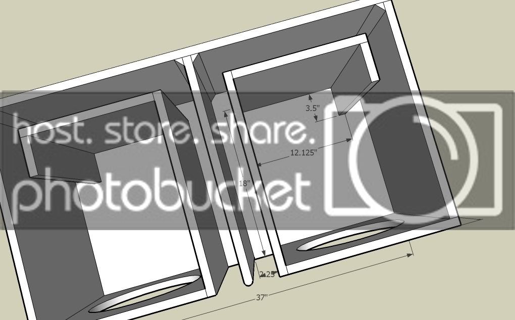

Here's what I whipped up..
This will bring you to:
-2.13 cubes net
-tuned to 29.9Hz
-37.5 sq inches of port area
Any Q's just let me know //content.invisioncic.com/y282845/emoticons/smile.gif.1ebc41e1811405b213edfc4622c41e27.gif

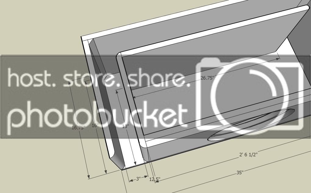

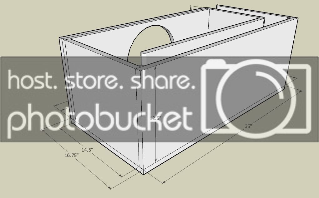

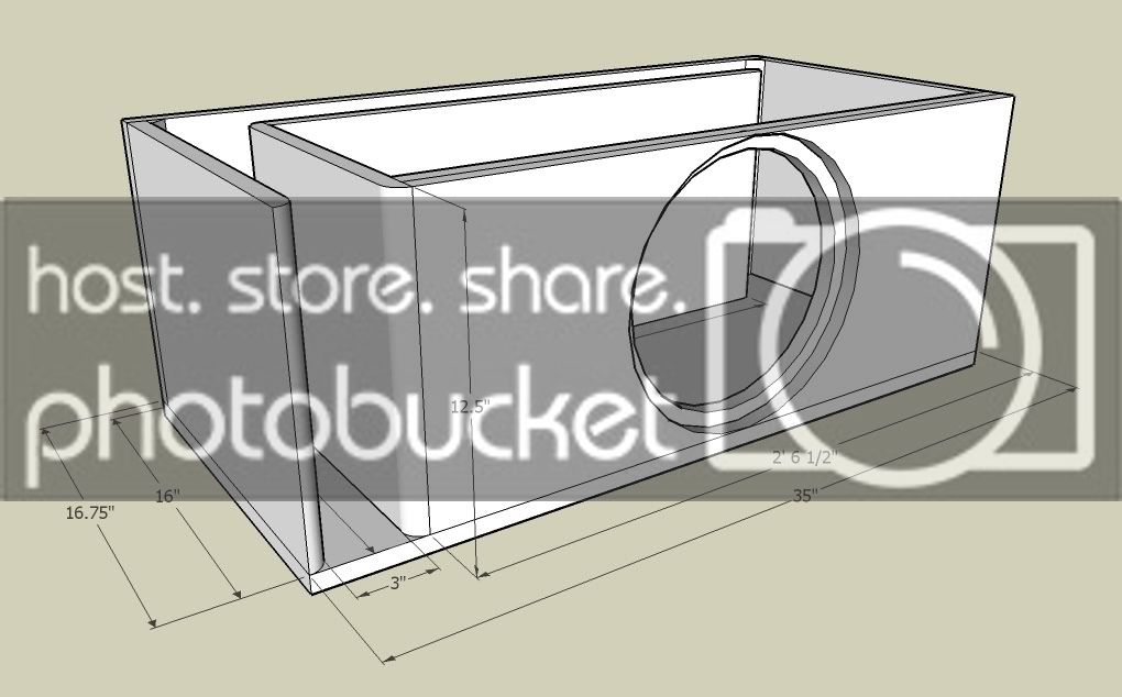

Alright, here's one for both of them...It isnt perfect because it isnt tuned as low as you wanted //content.invisioncic.com/y282845/emoticons/frown.gif.a3531fa0534503350665a1e957861287.gif
But it comes to:
-2.12 cubes per sub, net
-39.375 sq inches of port area per sub
-Tuned to a hair under 33Hz
