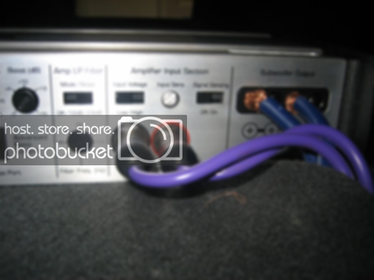

ima go take a pic of my amp (BACK) and post it, but i have no leaks and.. its coming right from the woofer.

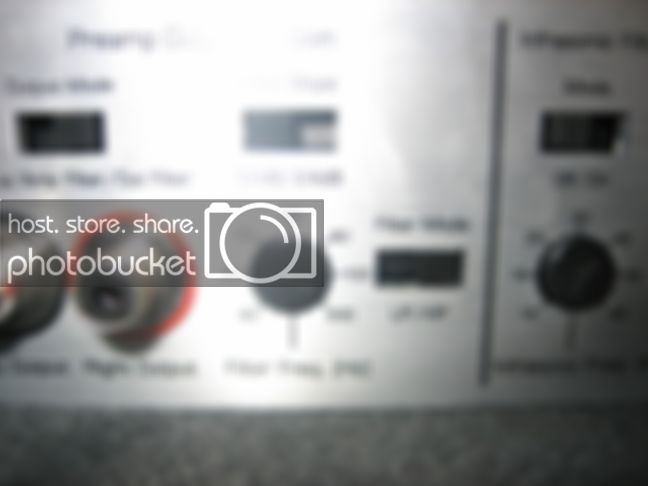

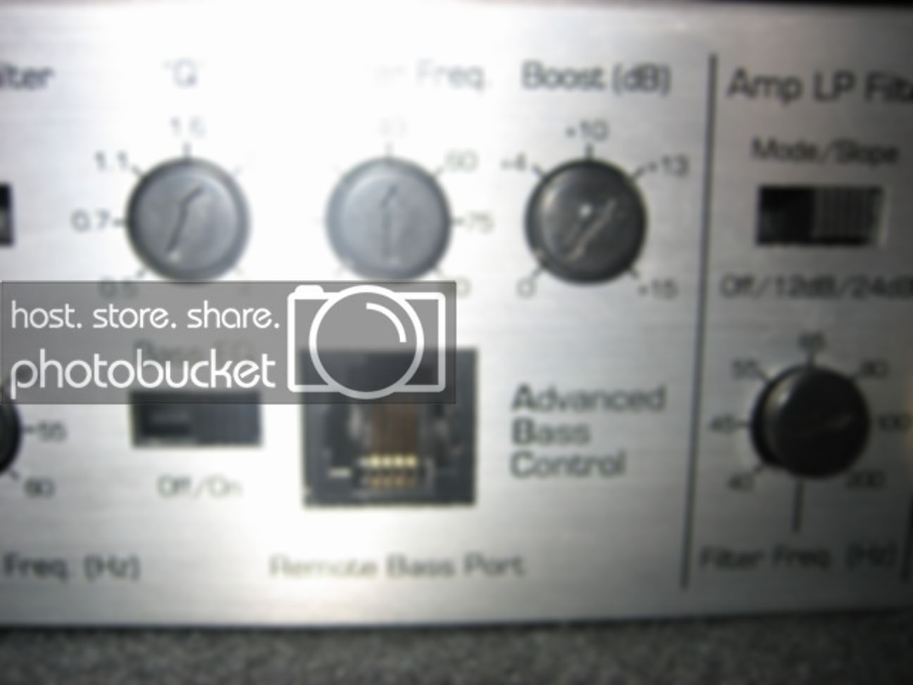

alright, here are the pics of my settings. i didnt re-size them b/c i wanted you all to be able to read the settings.
turn ur q down to .7 ... u should never have ur bass boost that high, the first pic means nada cuz its for preout amps... line out converters are junk, but since thats what u have check the gain/ knob on the loc... ufyi ur always gonna get a pop from those useless things...
