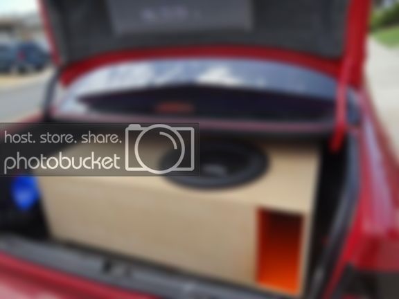

This is imtjnotu's box, nightshade 15
So he built that box, looks purty good:
