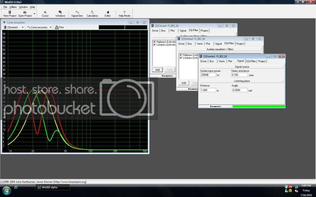

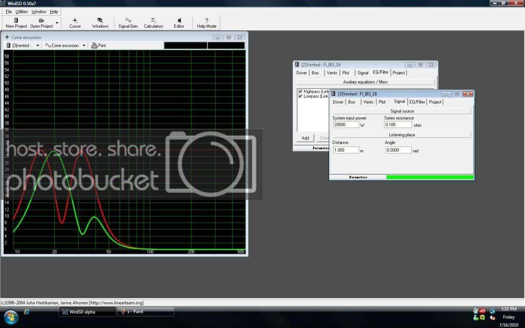

all three plots using Linkwitz HP 22Hz LP 32Hz
excursion plots, bringing power up until Xmax is reached
red 50 cubic feet 23Hz tune. power 49000 watts
green 50 cubic feet 32Hz tune. power 20000 watts
Note that at 32Hz, the red is at its peak excursion while green is at its least, and that greens "high side of the impedance saddle" excursion is still very little, as expected. Going from 23Hz to 32Hz is inverted. Whole different ball game.
same as above but included 55 cubic feet sealed, yellow, port takes up 5 cubic feet. 20000 watts.

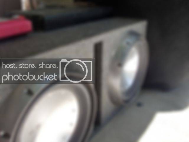

some more junk we did on the side today:
talking him into selling his prefab and going single slot port down the side, along the back

BL is a relative term, you need to look at BL^2/Re if you're concerned about motor force, the SS has a lot more than the RE. These are actually two very different drivers. So im not sure what you're trying to compare here? The RE has very high stroke, but very low sensitivity - don't give up on sensitivity, that displacement really only comes into play for a very limit passband. For the most part, you do indeed need sensitivity in order to even reach high displacement so you really need both if you can get it. Just relying on power and stoke is a very bad idea. You'll quickly reach the power compression limit or cook the coil. Also, most of these drivers have grossly inflated power handling ratings. You'll cook the SS's coil rather quickly if you manage to supply it with its "RMS" limit which by the way is an amplification specification that has no meaning to subwoofers.
Both of these drivers will be very peaky in 50 cubic feet. Are you planing on using just one 18? The RE might have a chance if you tune it much lower to have flat response. If you're just after high Q boomy box - ie lots of SPL right around tuning, then either will give that no problem in that kinda volume.
Also you need to decrease the Q of your high pass or move it up in frequency, you should aim for symmetrical excursion peaks above and below the minimum (tuning frequency) so you get the most of out the driver. You'll run into the displacement limit while you fight the box as it unloads -basically just nerf'ing your SPL above tuning....
