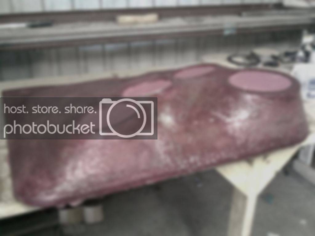

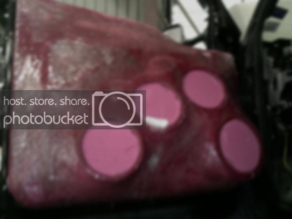

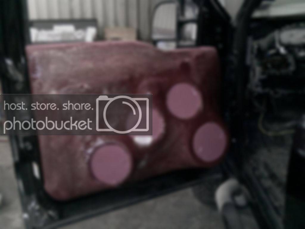

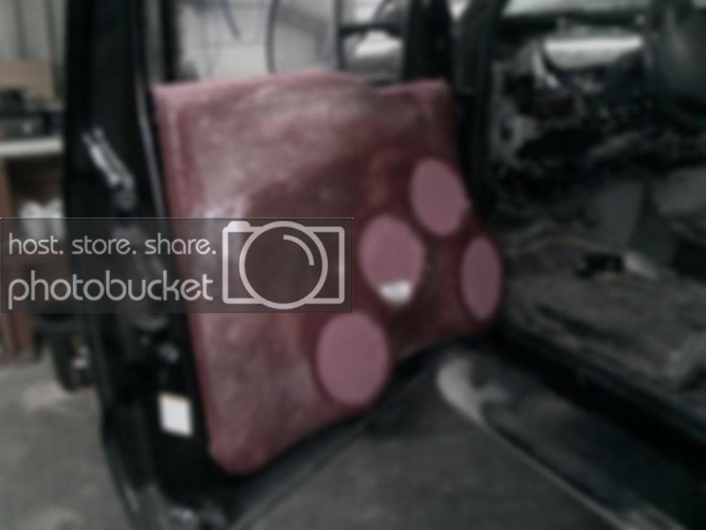

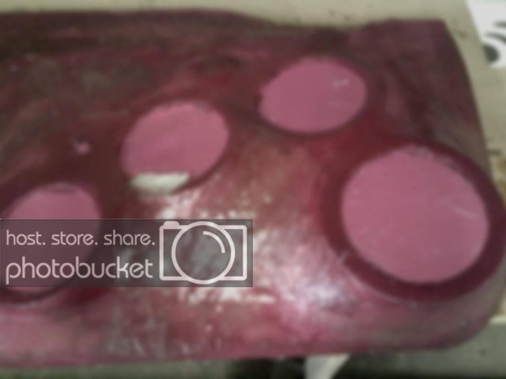

Here are some pics i started out with the doors because i have to send them off to paint and airbrush and i can finish the box and interior while they are gone.
the front doors will each hold 3 ck6 comp. sets and a 8" midbass,no inside handles,no switches all fiberglass.
