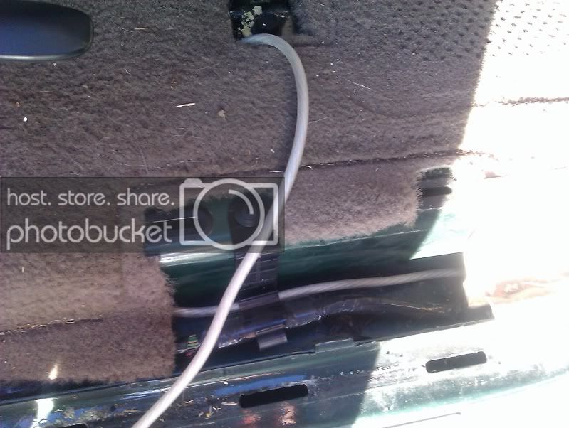

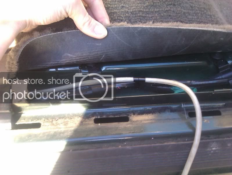

Power wire ran

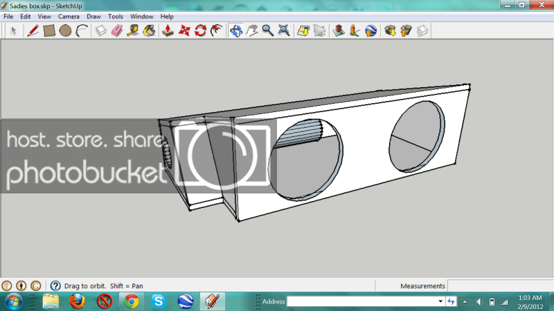

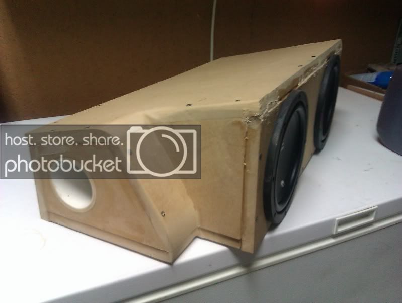

Box
1.2 cubes after displacement tuned to 35. Designed to fit snug under the rear bench seat.

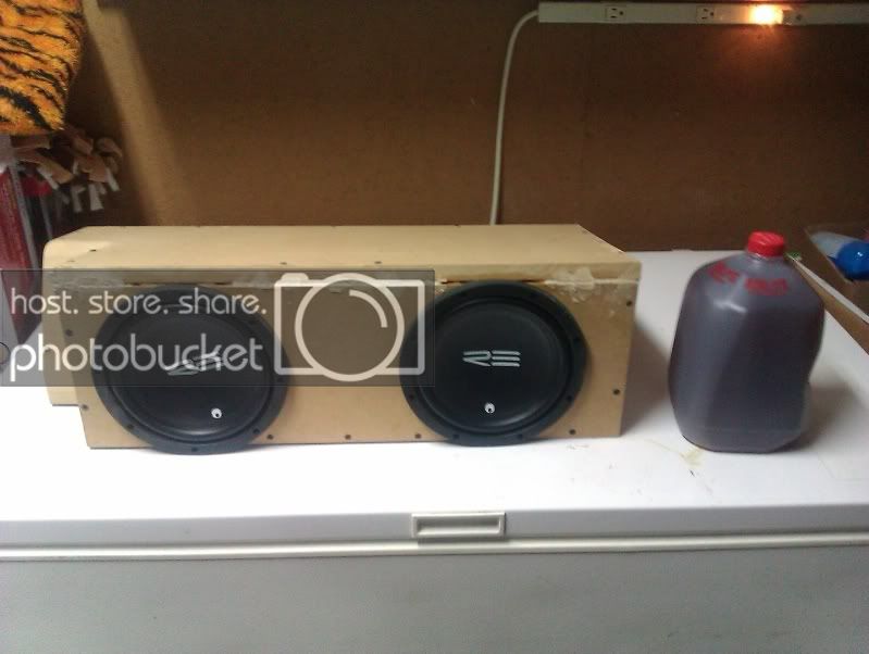

Got the box done, ran all the wiring, installed the amp, got the LOC installed. Tried the subs for about 10 minutes and I'm pretty surprised. For how much they cost and what they are, they're pretty good compared to other drivers in the same price range and size.

Box pics

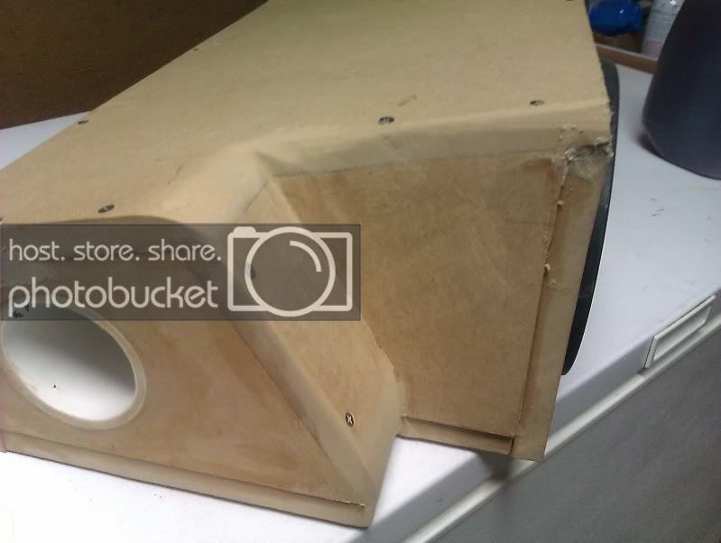

Angled area for the seat mount

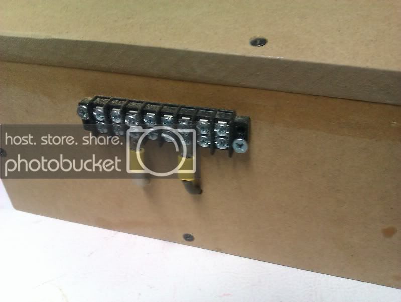

Terminal for easy removal

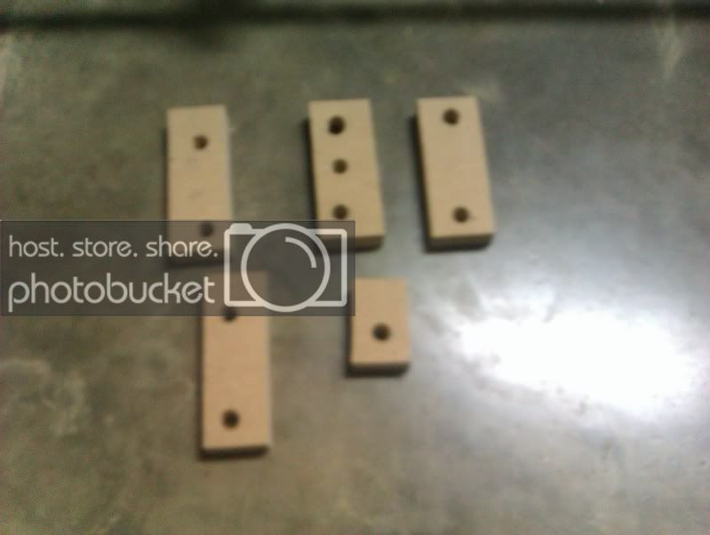

Box ended up sitting too high for the seat so I made 3/4" risers for the seat mounts. I'm carpeting the box tomorrow and then it will be put in. Then I'm going to put the seat back in on the risers.
