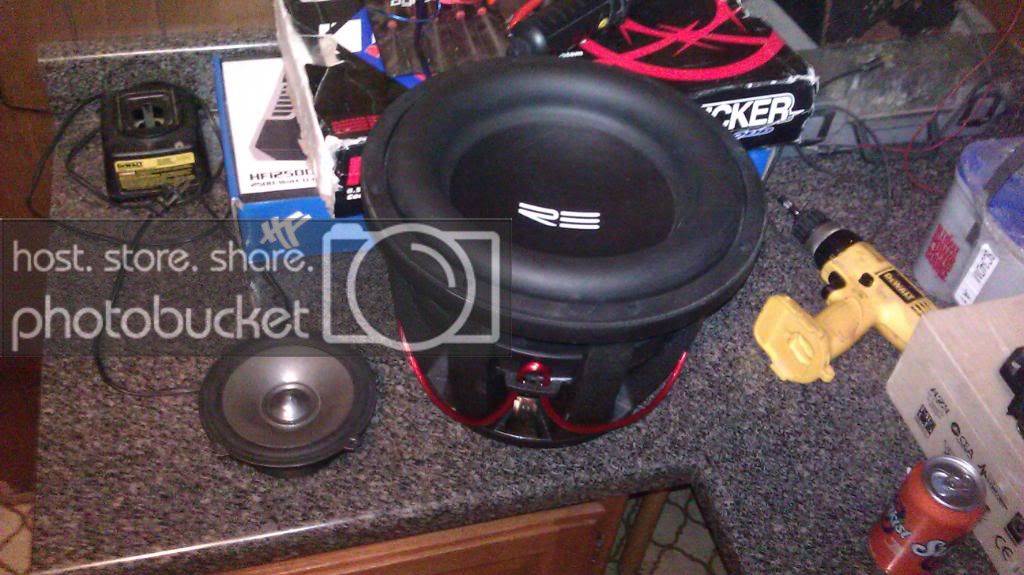

This is all the stuff that i am installing or have already installed.
Kenwood Kdc-Hd942u
Solid Audio SQ5
Kicker Hyperflex 1/0
Big 3 done with 2/0 welding wire
Mechman 250amp alt.
Optima yello top
Rockford Fosgate renegade 1100 watt 4 channel.
Hifonics HFI2500d
Audiobahn ACIS 63 component set.
2 Re audio MX 12s

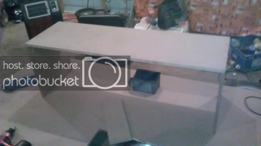

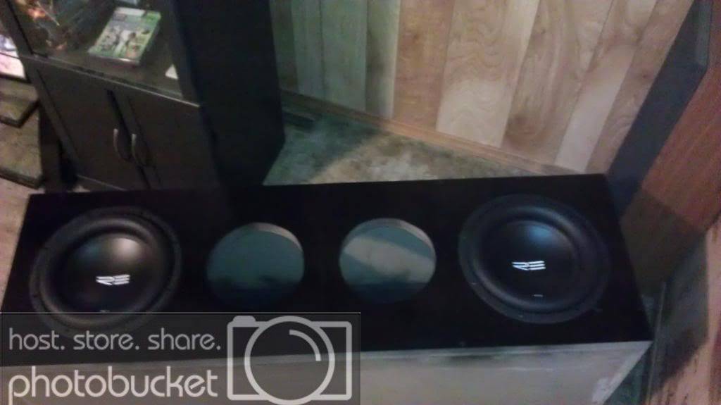

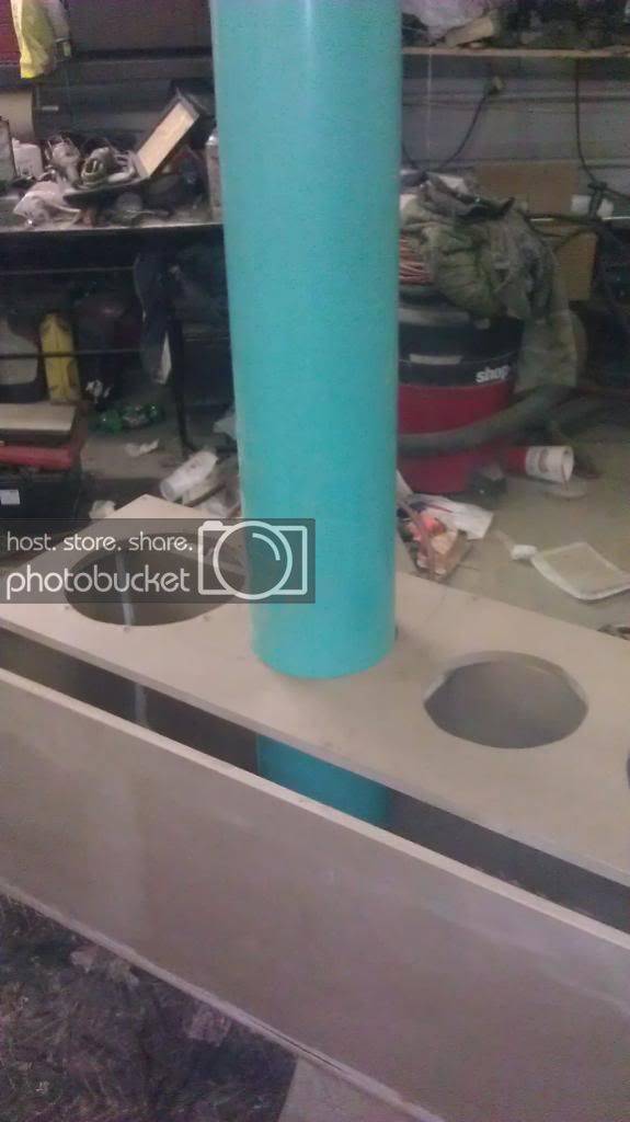

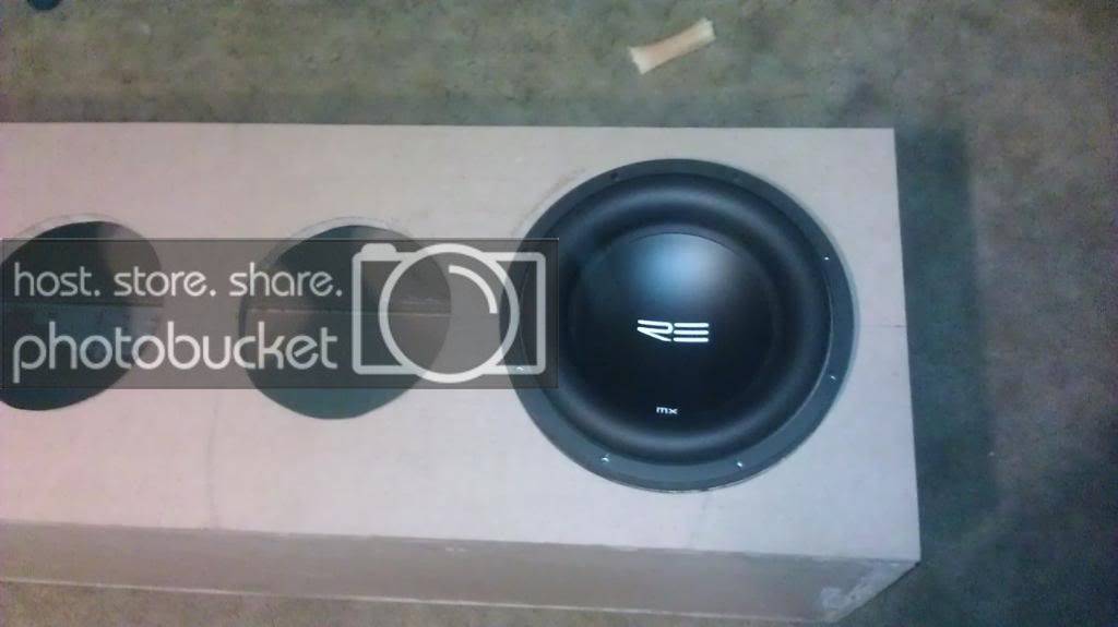

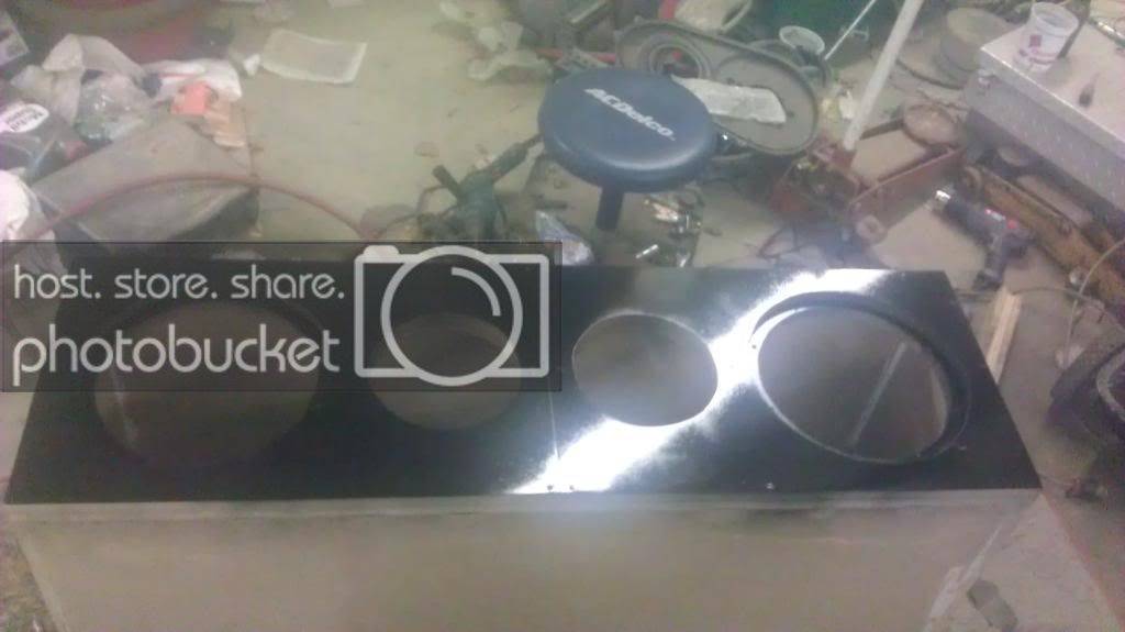

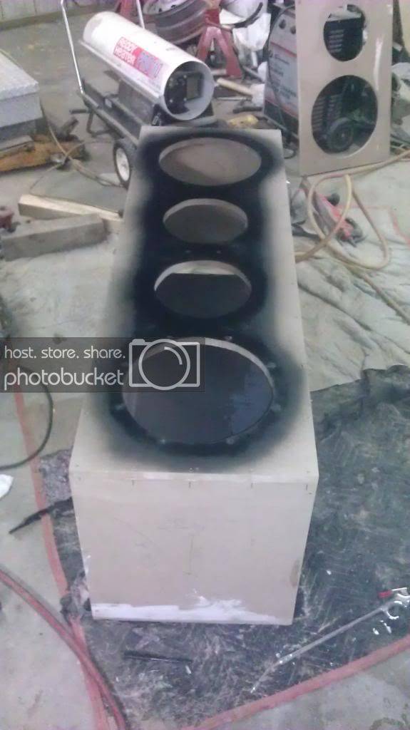

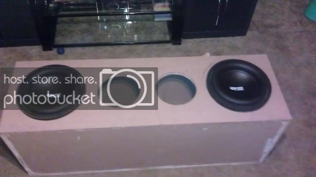

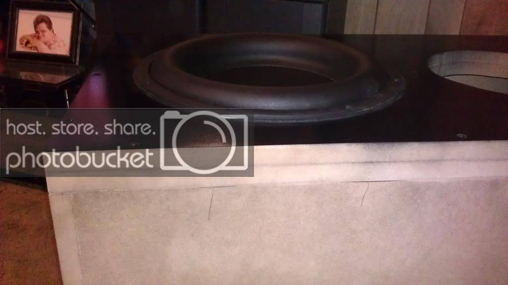

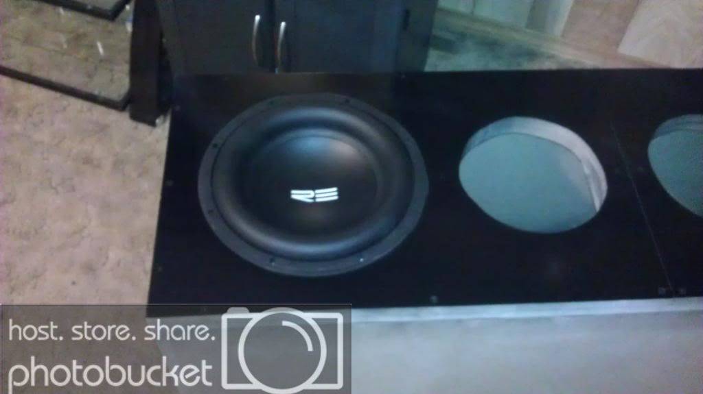

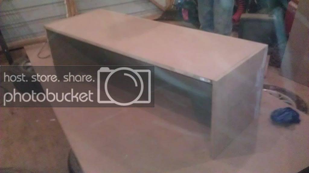

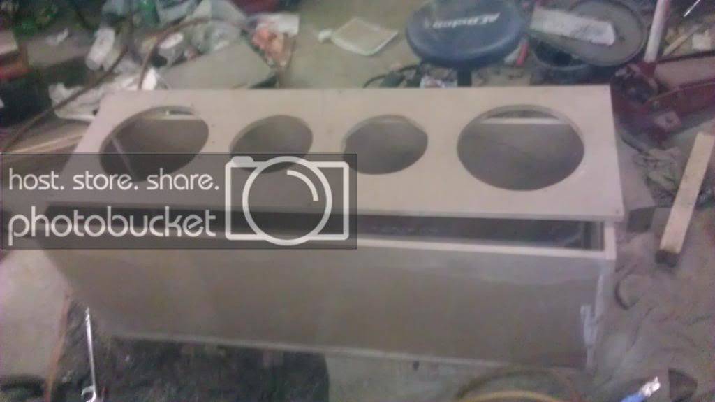

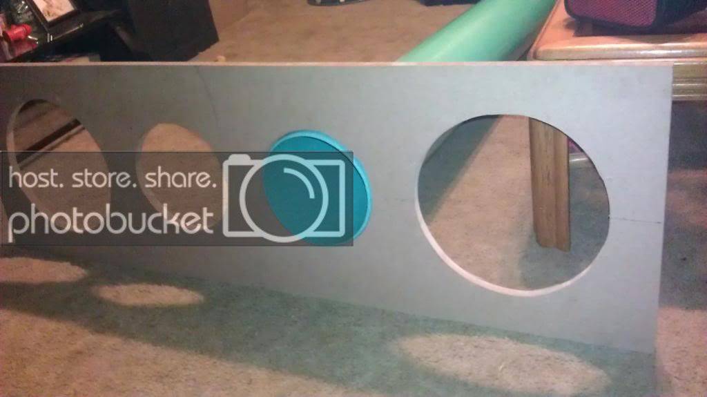

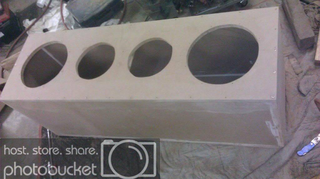

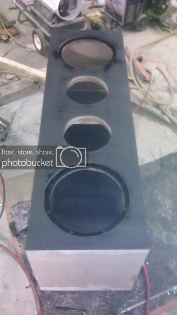

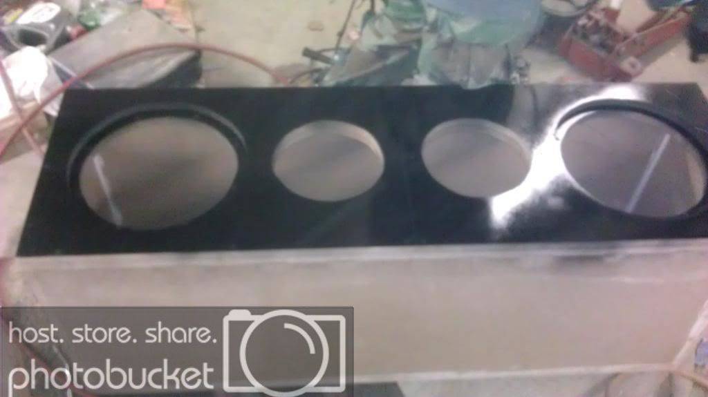

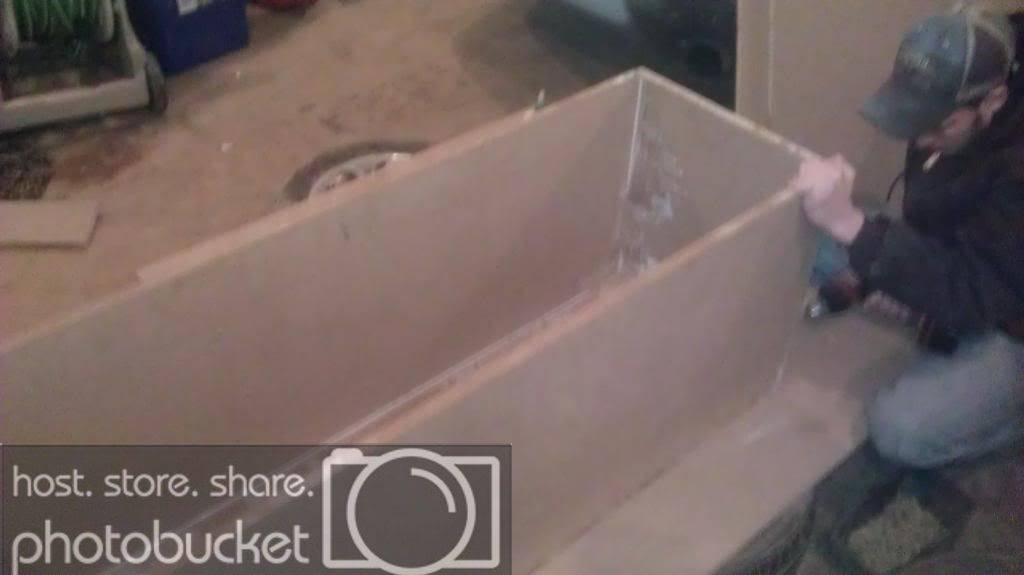

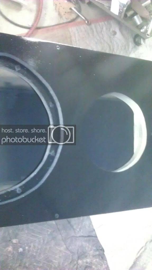

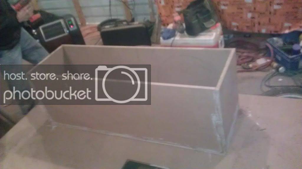

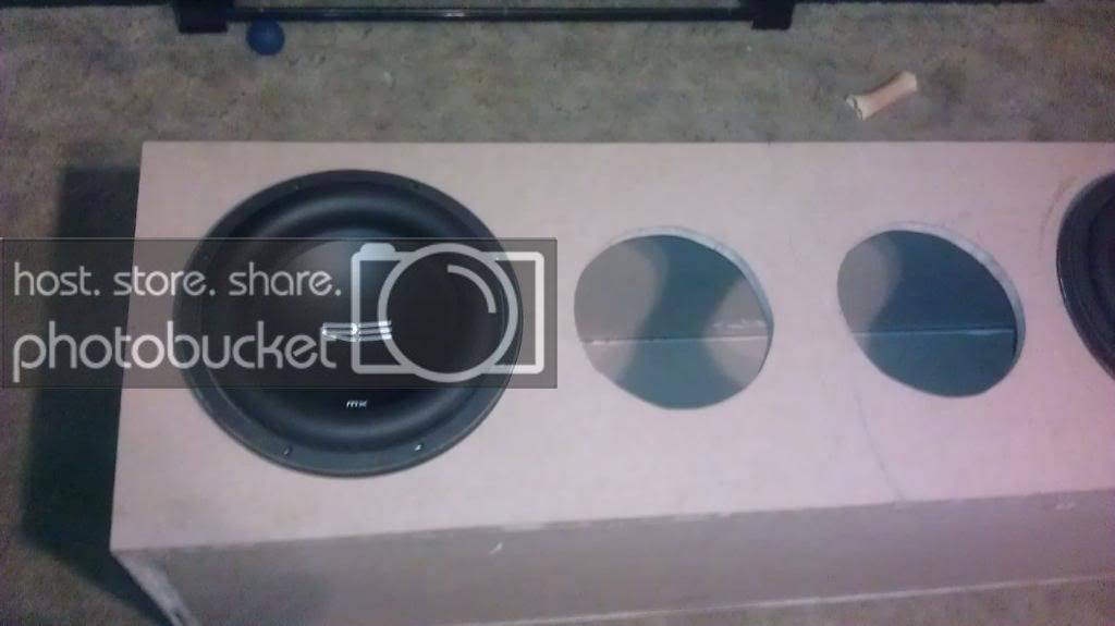

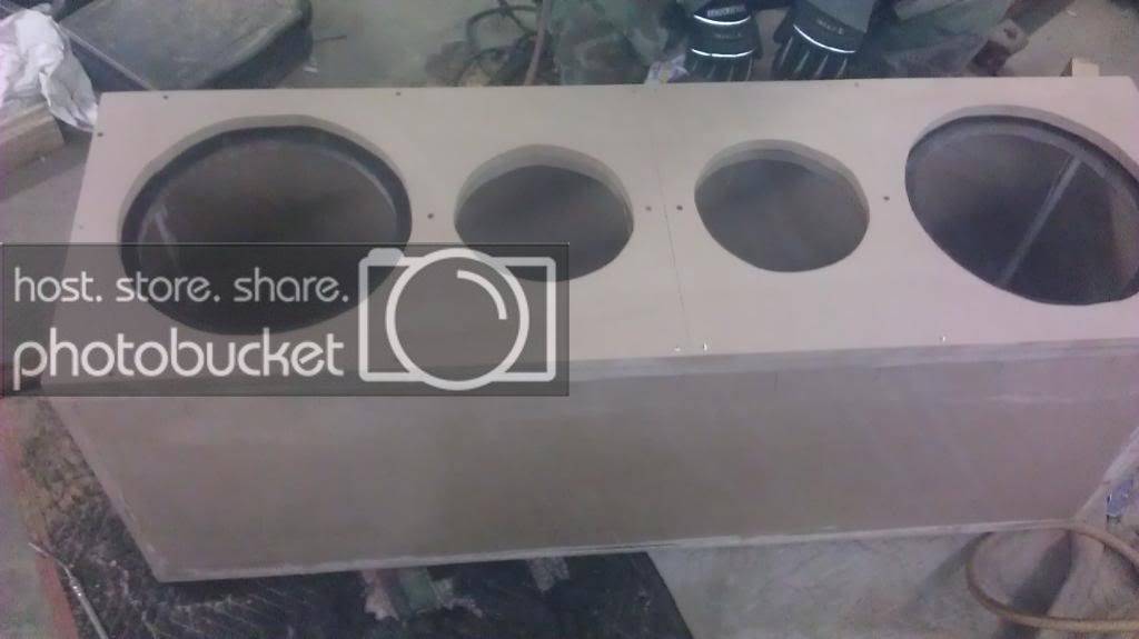

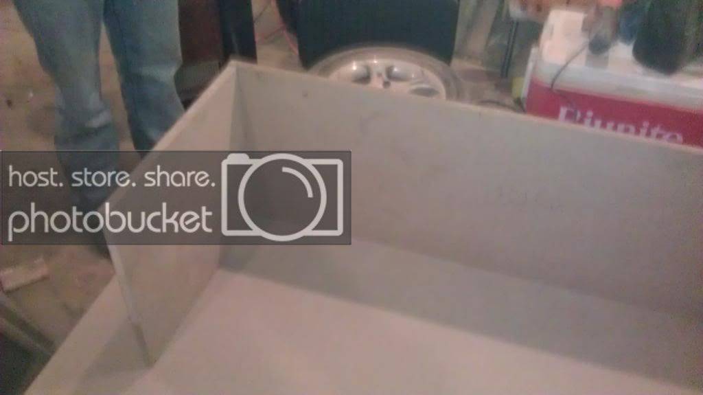

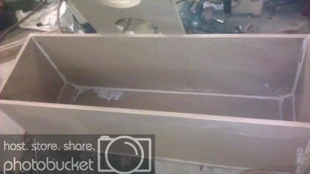

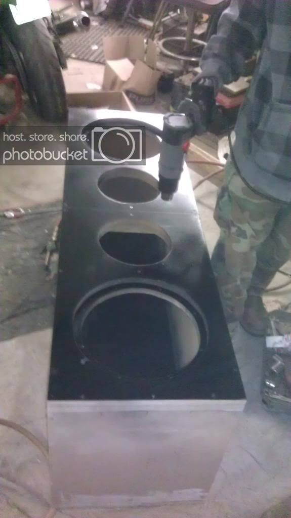

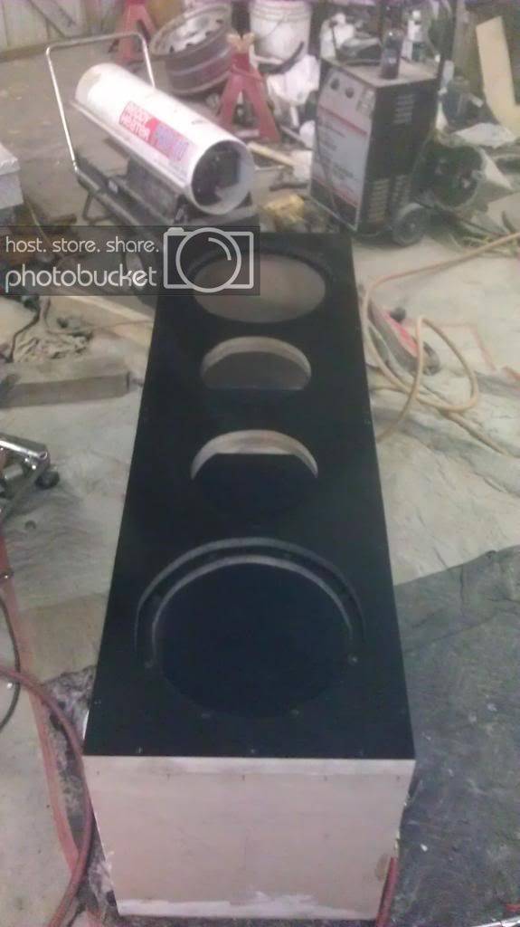

Currently building the box

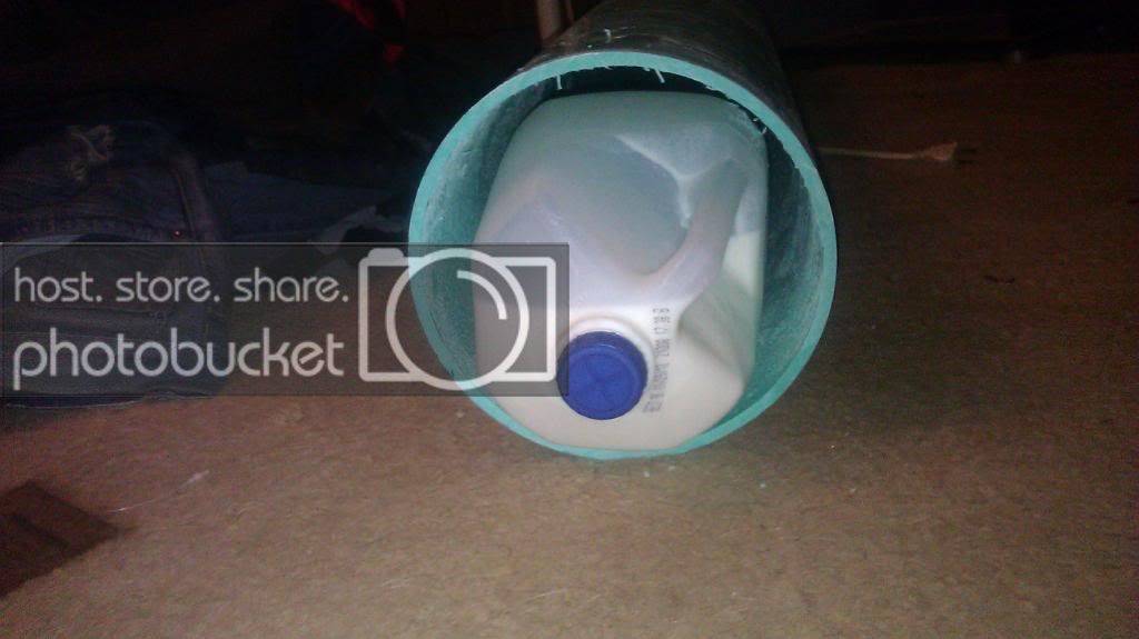

8.33 cubit ft with 2 8 inch aero ports with changable ports. Tuned for 55htz and 31htz
also need a center piece about 6" long with 45's on each side of it,and bigger 45's on the in the corners at the ends of the box.other than that it looks good joe.
