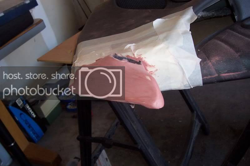

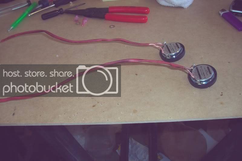

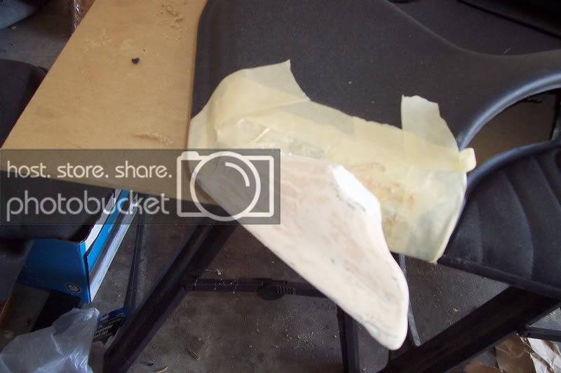

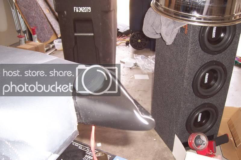

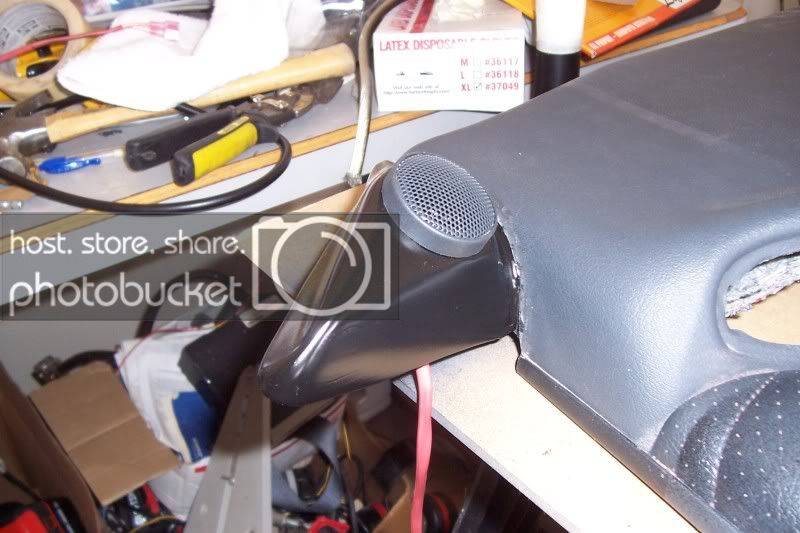

Well it took me a few weeks, but I did the sail panels to house my new Helix tweets. I am not a professional, and this is my first time dealing with fiberglass and bondo for the most part.
This is what they started as:

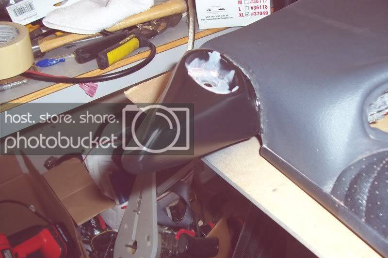

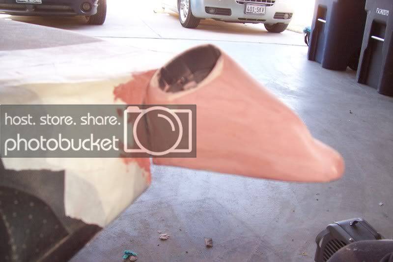

Than I stretched my matyerial over the panels and my mounts:

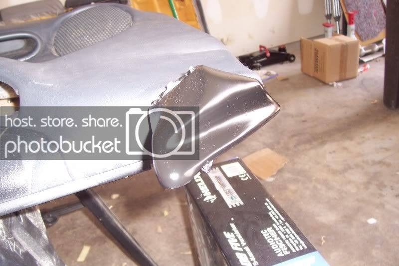

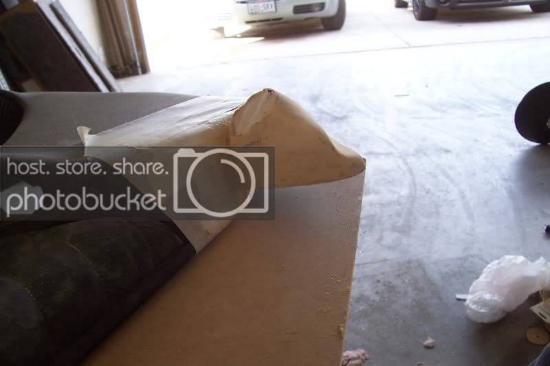

This is after a layer of mat:
More to come in a few

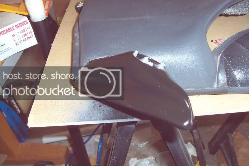

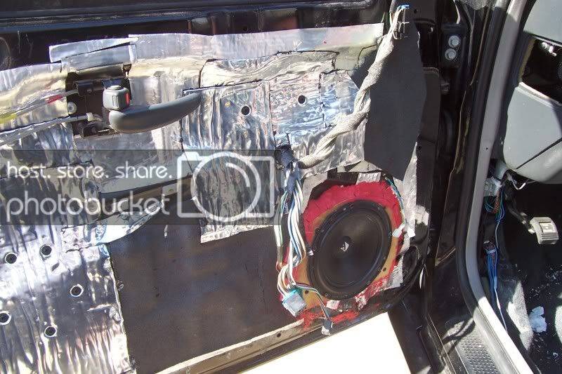

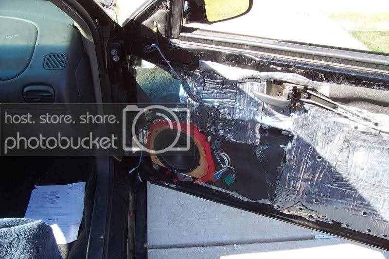

The rest of the doors, after 60 feet of Raamat and much sheet metal and ensolite:

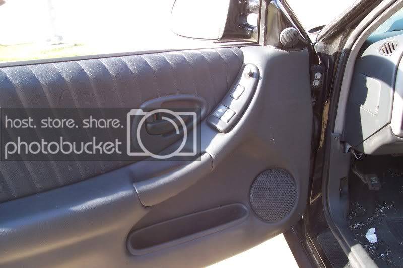

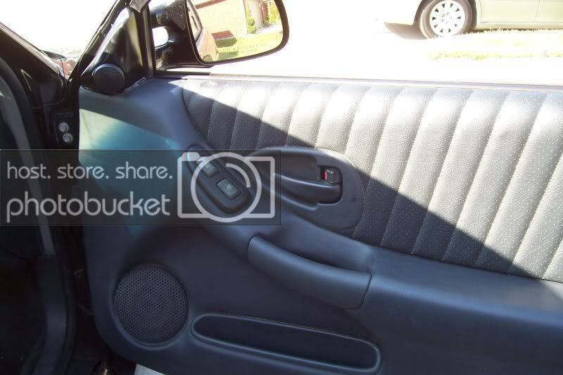

Finished doors:

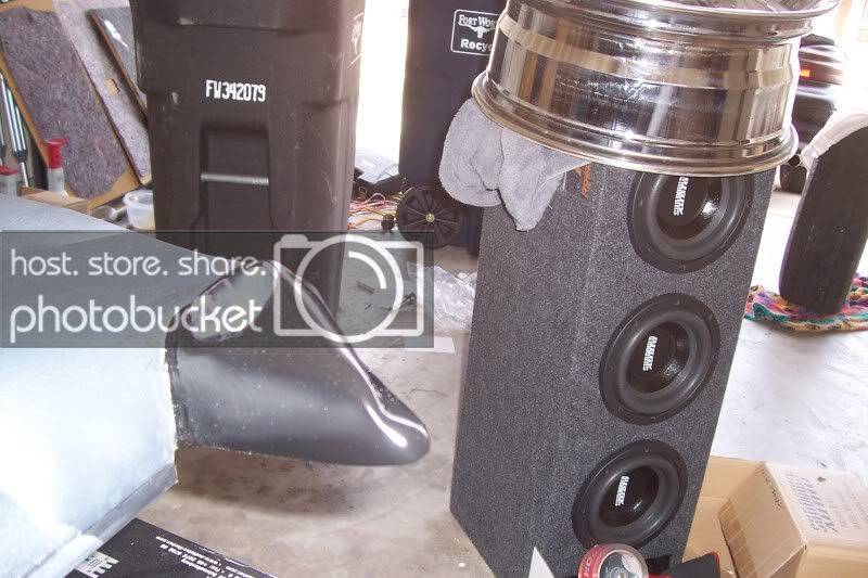

Sub box is done and can see in a few pics thanks to BJ Fisher,
All I need is to finish amp rack in spare tire well, and make everything pretty.
why not texture them and spray to match the door panel? (SEM makes matching interior paints) and you can easily texture them with spray on bed liner. Unless you want them smooth.
