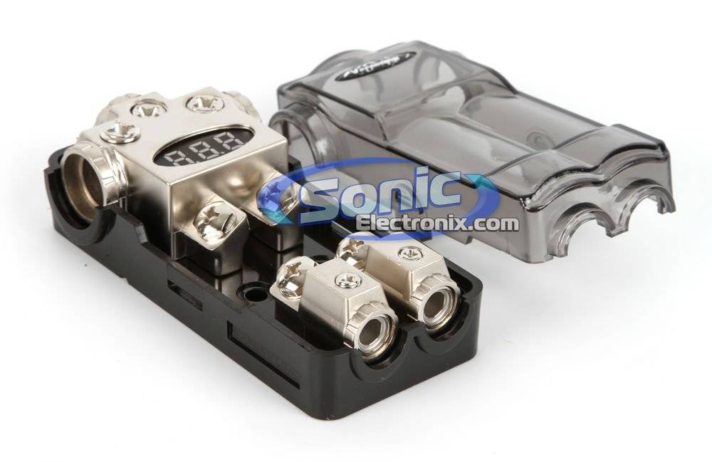

Xscorpion DMANL3034P Digital Platinum Mini ANL Distribution Block

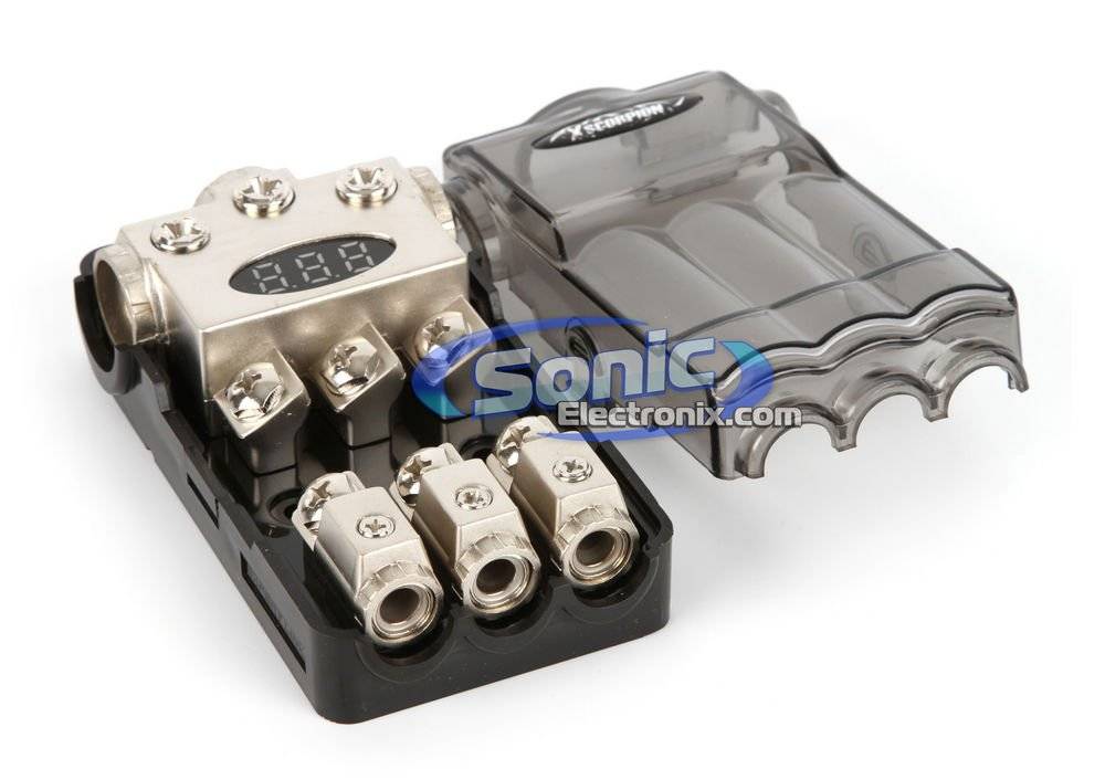

Xscorpion DMANL3024P Digital Platinum Mini ANL Distribution Block

Hey still can't find much 0 gauge outs how about a fuse holder for each amp like one would use near the battery? Gonna add a battery in the back anyway? Just have to torpedo the voltage or get one of the ghetto one and stash it in the glovebox or something.
you don't need to fuse the 1/0 again. the above xscorpion let the 1/0 pass through without a second fuse. the fuse protecting the 1/0 is at the battery. you only add another fuse when you make the wire smaller.
make sure the rear distro volt meter is powered by ignition or remote turn on wiring and not "auto sensing". those have been known to drain batteries.
The link didn't show a specific product could you link it please? Also the amp has no onboard and says it requires a 200a external change that situation?
